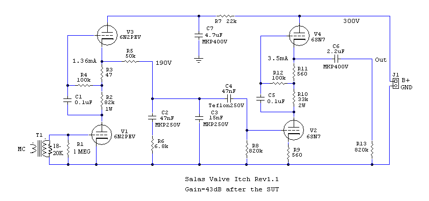

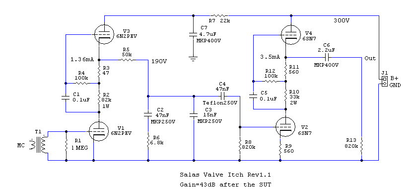

About step-up I will use the scope as per your advice, the questions:
-I need load capacitance like the Jensen?
-If yes how can I calculate?
You will not calculate or scope anything. Because I have already measured and posted that using a Zobel as the manufacturer recommends has a true and strong effect.
No need you discover America once again.
After you install with final cabling trim, you start with the Jensen recommendation for Zobel and Itch input load. You just listen to 200pF, 150pF, 100pF in the RC and you decide.
In the Partridge 977 case it only takes 18-20K Itch input load to tame leading edge peaking, no RC. I had measured that in the past too.🙂

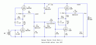

So only one resistor 18-20K across seconday?
Obviously, but if you will install directly across the SUT just make the Itch's input load resistor 1Meg. Else you just install 18-20K as Itch's input load and you leave the SUT alone. When in same box without interconnects I see no real reason you damp right at the SUT's secondary.
As the attached pic with SUT load resistor 18-20K across sescondaries?
Only if there is 18-20K directly on the SUT's secondary also. Yes.

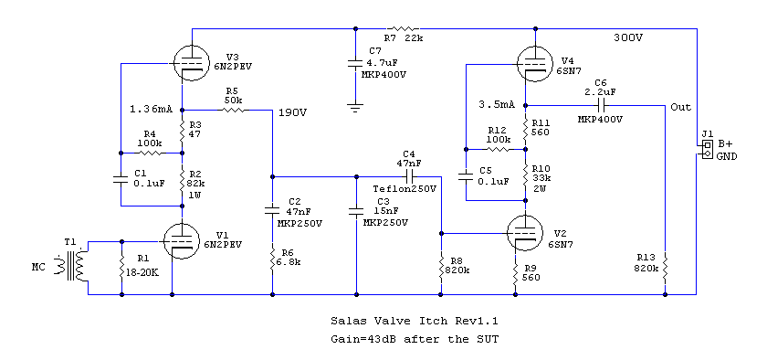

The other way is like the attached pic?
I meg parallell with 20 k is 19,6 k. I doesent matter in this case
It makes sense when the SUT is a self contained unit in own box, so the grid will not be flapping on the cool breeze when the input is disconnected.
