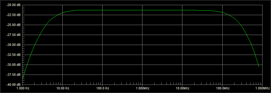

47nF inter-stage and 1uF output when driving 50K typical pot example response with useful sub bass roll off.
