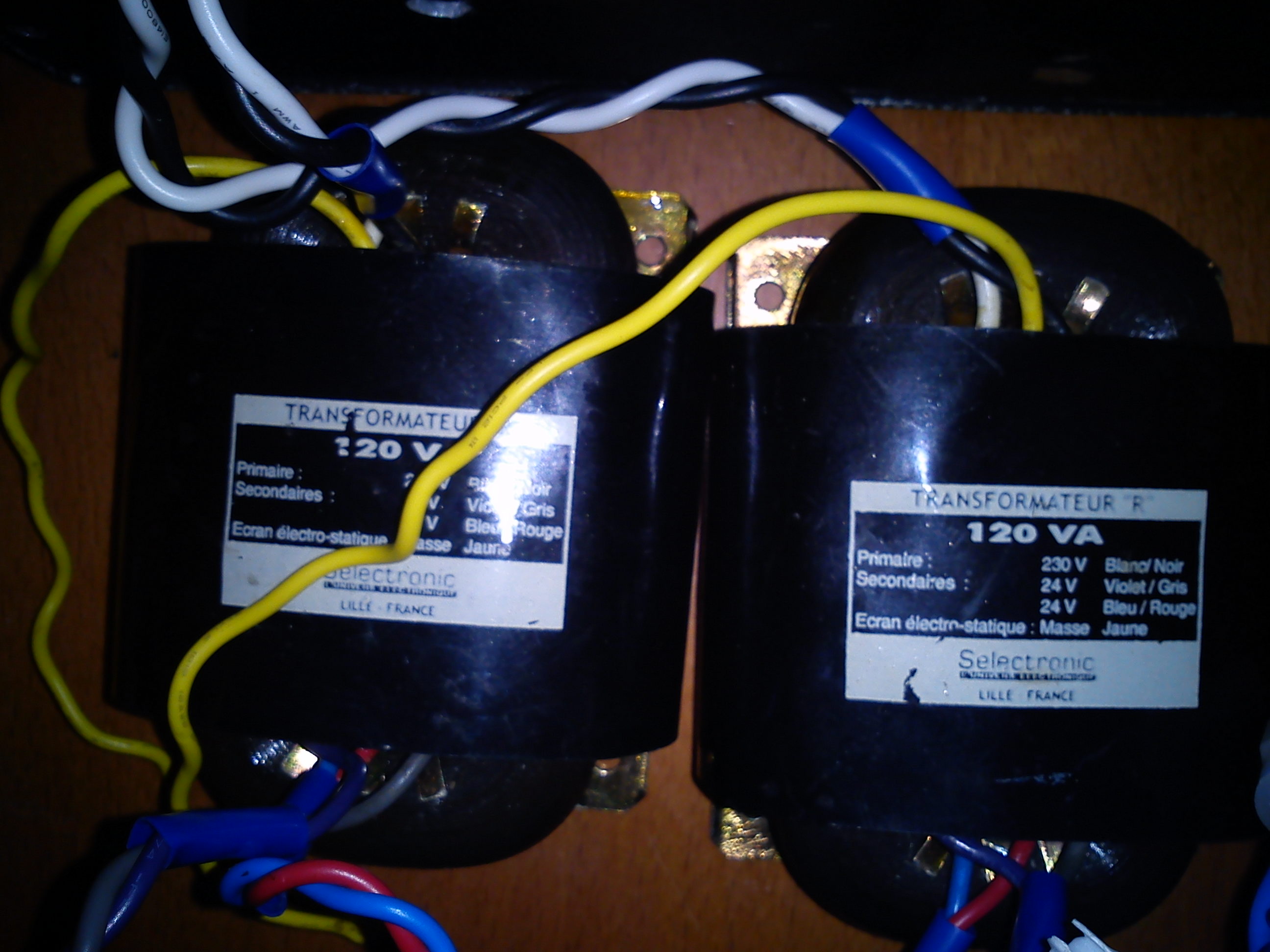

Salas changed the EI core 240V tx for two R-Core 230V 120VA but still the reg can gives max. aprox. 200mA, must be something wrong cinnected or burned at the SSHV2?
R-Core without SSHV2 gives 314VDC, when connected to SSHV2 I measure at the SSHV2 input 298VDC, In the PSU box I have R1 110 ohms instead 220 ohms and a bleeder resistor of 220K, have I to change for other values?

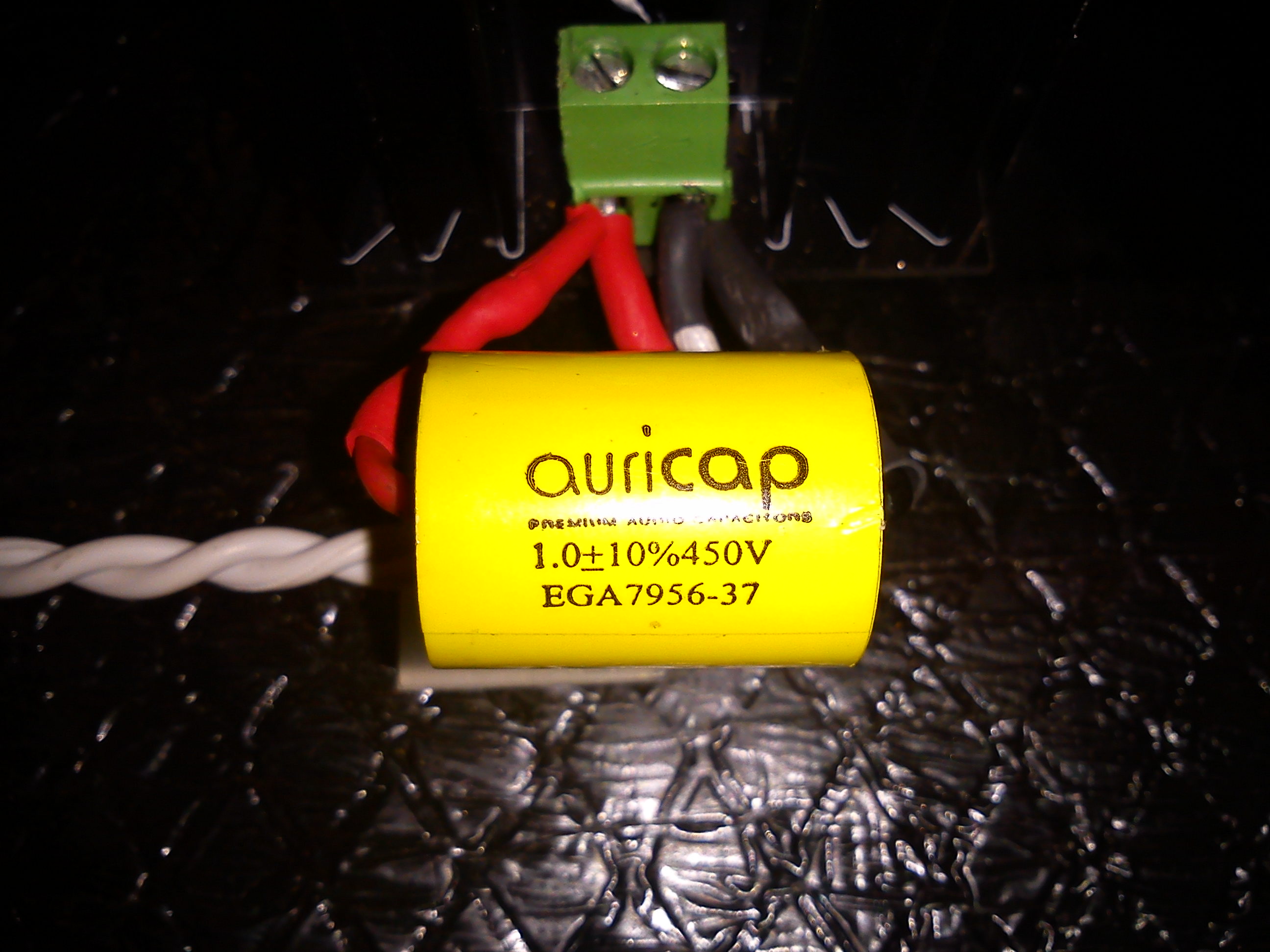

Sorry my mistake 28mA, I changed the cap to 2.2uF but can't have more current: I measure 26.5mA😕
The only difference 1uF 450V Auricap & the 2.2uF 400V Solen.

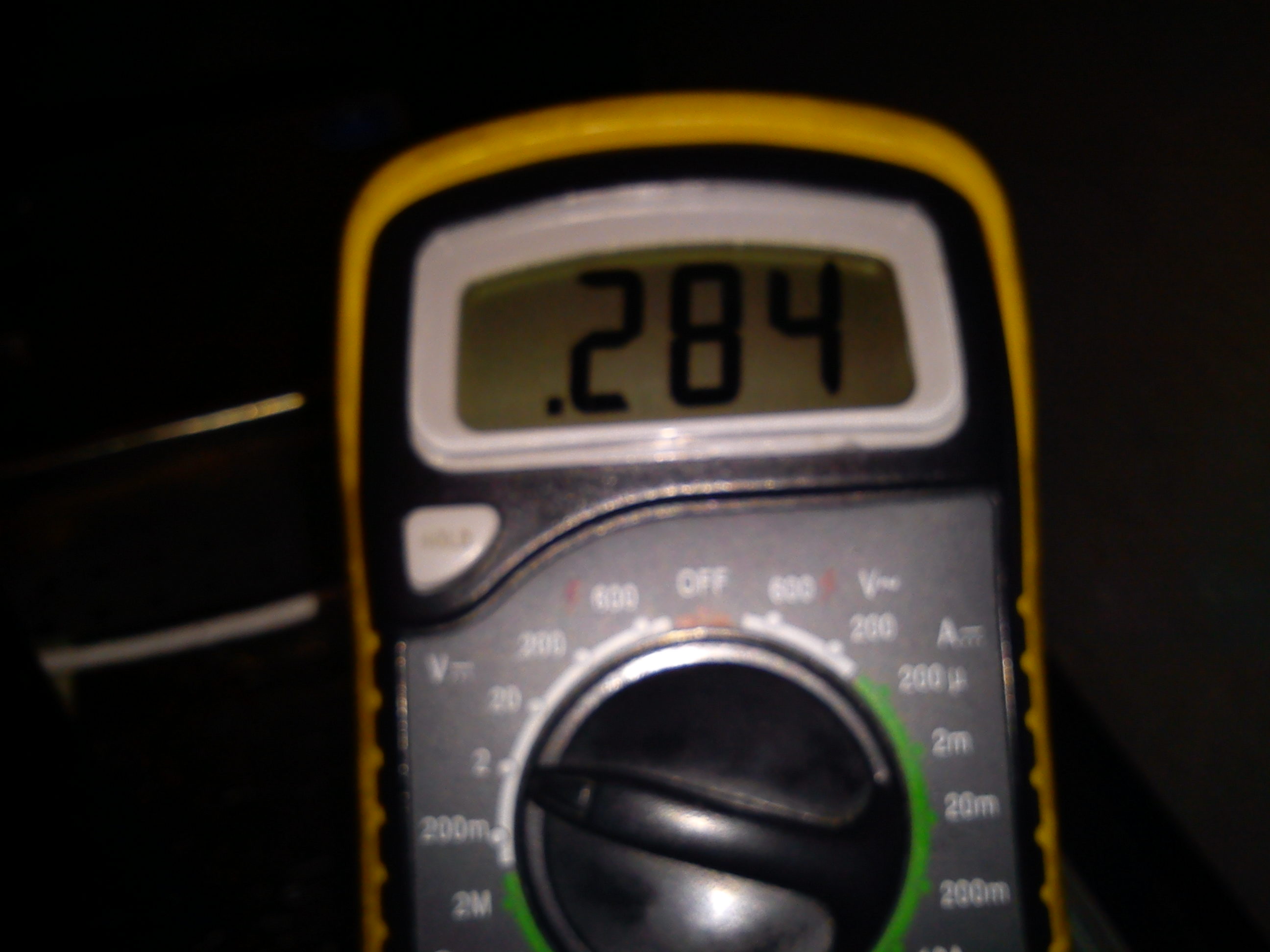

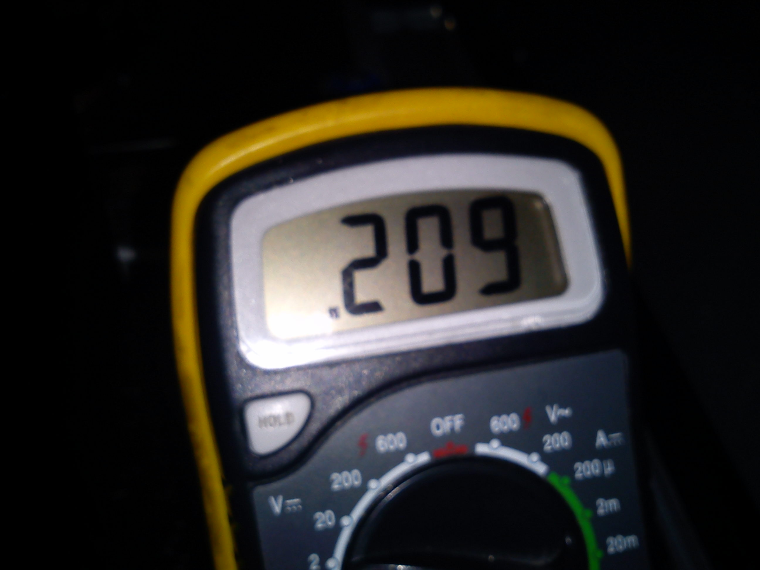

200mA was measured with real load (Itch), I added 1uF 450V Auricap just at the SSHV2 input and now I have 284mA so the culprit might not be the transformer.
Sorry this DMM is wrong, I measured with good DMM with 1uF 450V, max current 22mA, R-Core tx 230VAC 120VA

With 4,7uF 400V the same current

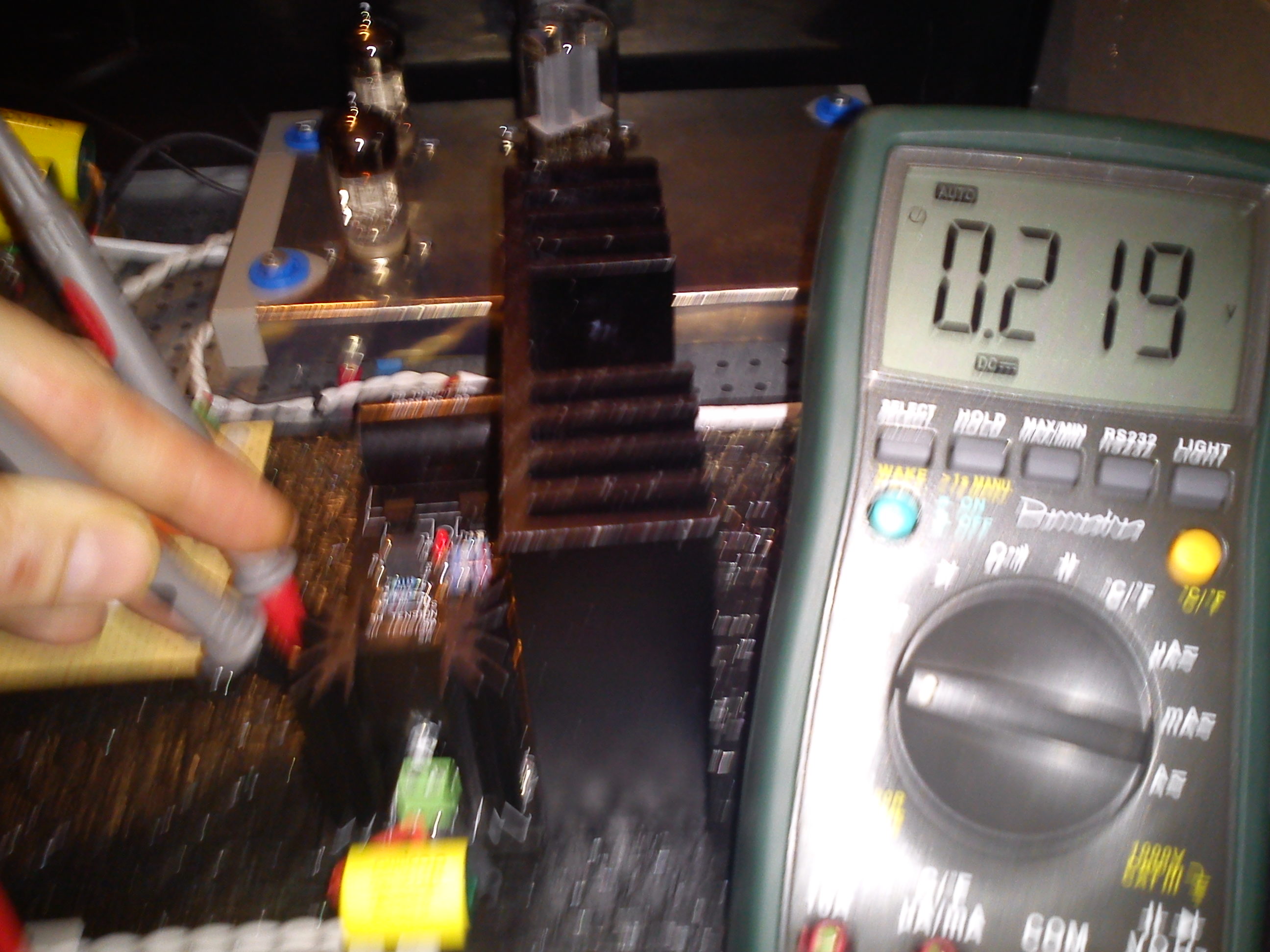

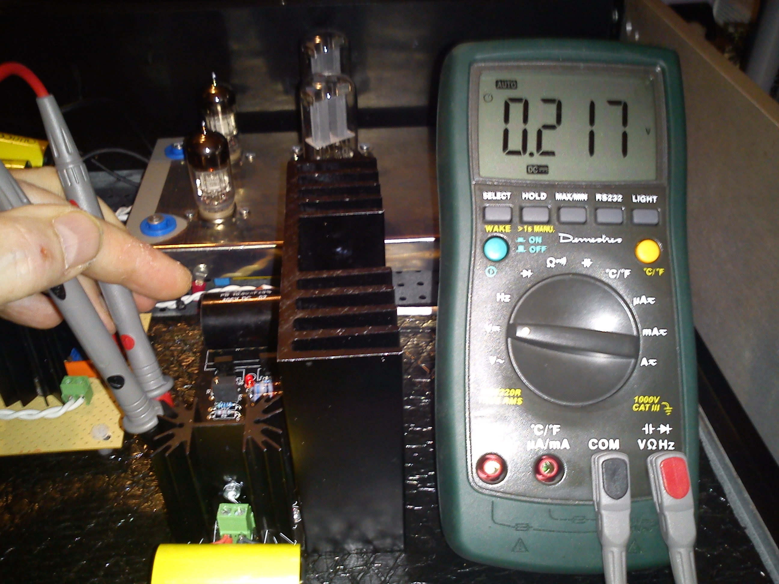

Voltage across 110R is 3.5V.
The thing I'm not clear is the voltage sag when I connect the PSU to the SSHV2: now I measured at the input of the SSHV2 301.5VDC, output PSU without SSHV2 conected 316,3V so I will take off the 110R to see what happens.
Without bypassing 110R I measure 35mA, still the same problem with voltage sag at the input reg, I bypassed the 110R to see what happens with the voltage sag. I'm waiting the warm up to measure again the voltage sag.

hmm with the two txs: R-Core 230V 120VA & EI Core 240V?
I use rule of thumb secondary x 1.33 for total Tx & rectification losses under load, not the theoretical x 1.414. That gives 306VDC for 230VAC. Most of the times falls between 1.30 to 1.35 in the end. Set the reg at 290 to see if it gives it new breath and to be more compatible with mains play.
