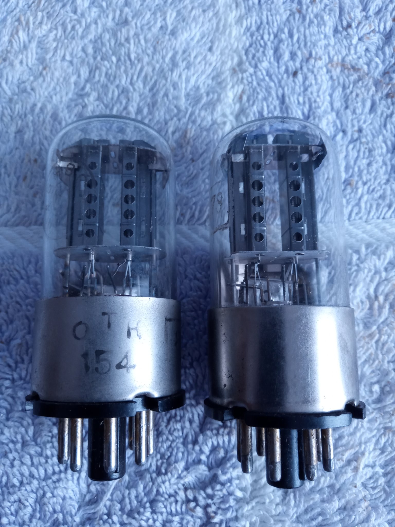

Salas own a coupled of 1578 metal base ground hole plates, I remember with a lot of gain, very transparent and powefull but weak bass surely due to the RIAA 15nF one channel problem, could I take off the 7N7 with adapters and use it without change the resistors values you designed to use the 7N7?
Possibly. If odd sounding retrofit the standard resistors values for 6SN7. The Melz ones I listened to had 1578 stamps on the glass and the resistors were standard.

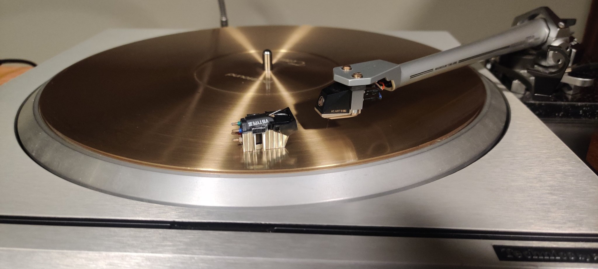

I forgot that you used a Shure V15. I have one too and tested with the Itch, but there is no comparison with a modern MC cart like my AT ART9. The naturalness and resolution are steps above the Shure. And I use a sowter step up, probably one of the best step ups. It can be pleasant in small jazz ensembles and vocals, but in symphonic complex music, which is most of my vinyl library, I prefer the UFSP. That is not to say that I do not enjoy the itch from time to time.Vacuum tube are active devices so plays an important role for the SQ. The output capacitor also is important as is the PSU & RIAA. I have both: The Itch & the UFSP but I have no tech cold cart & for sure it's well done the set up with the Ekos & the Linn Sondek LP12 because two or three weeks ago tested the SRA of my Shure V15 type III with original pick-up with a microscope and was spot on 92°, what a coincidence the VTA was adjusted for me by ear.

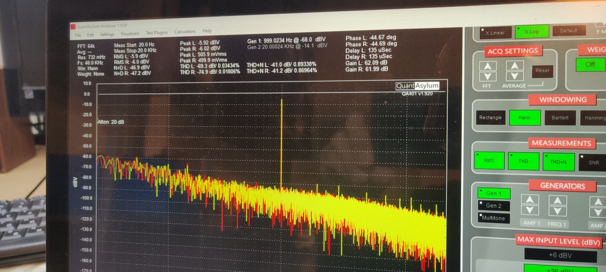

As you say tubes are active devises and influence the sound. That' s you can never be certain about their performance, unless you test them in circuit with FFT. When I switch the same tubes (V1 with V3 and V2 with V4) you can see differences in gain and distortion - or if you just got a noisy one - so I choose their location were I get the best measurements. And you can hear that, lower noise better balance etc.

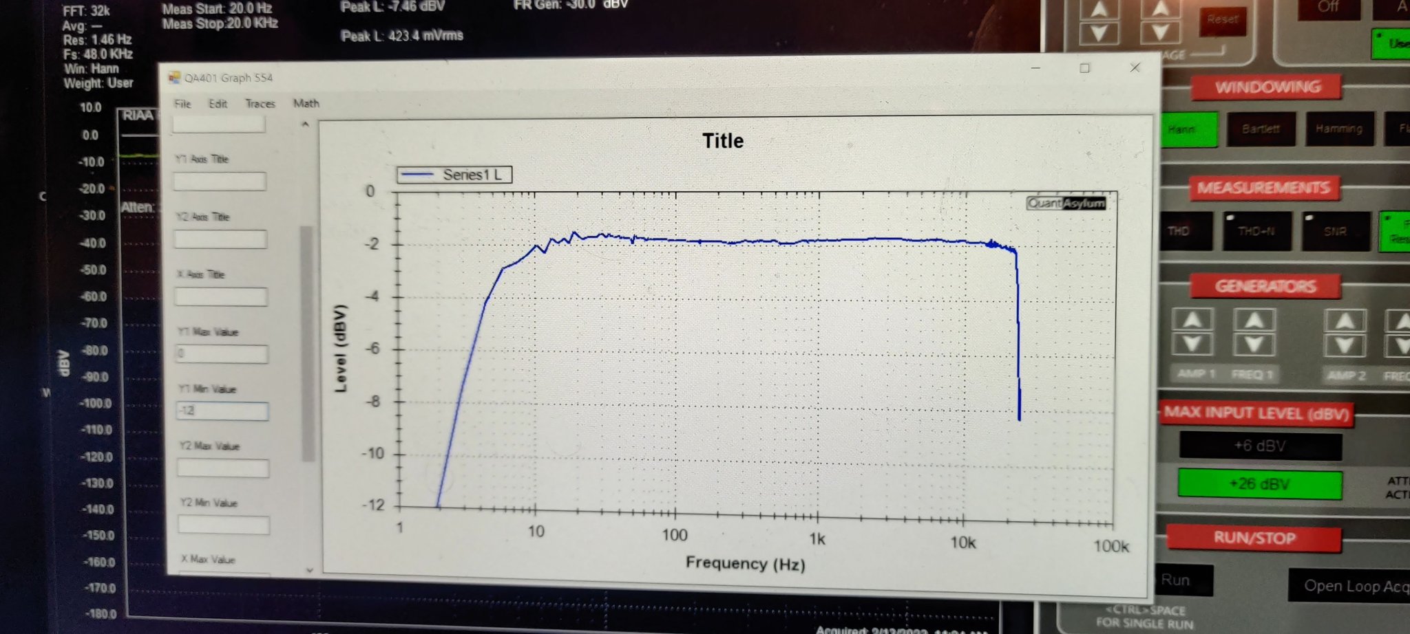

I don' t think that there is much to upgrade on my itch. Combination of teflon and mkp capacitors, f&t capacitors on the ps sinkoh and takman resistors etc. I was thinking about meltz tubes, but price is too steep now. And here some measurements for you.

The stylus is not a jico-sas. I did not like the sound so much to invest in a more expensive needle. I prefer mc 's as the person who donated me this cart, had a sas needle, I trust his opinion and now has an AT ART10 like mine.
