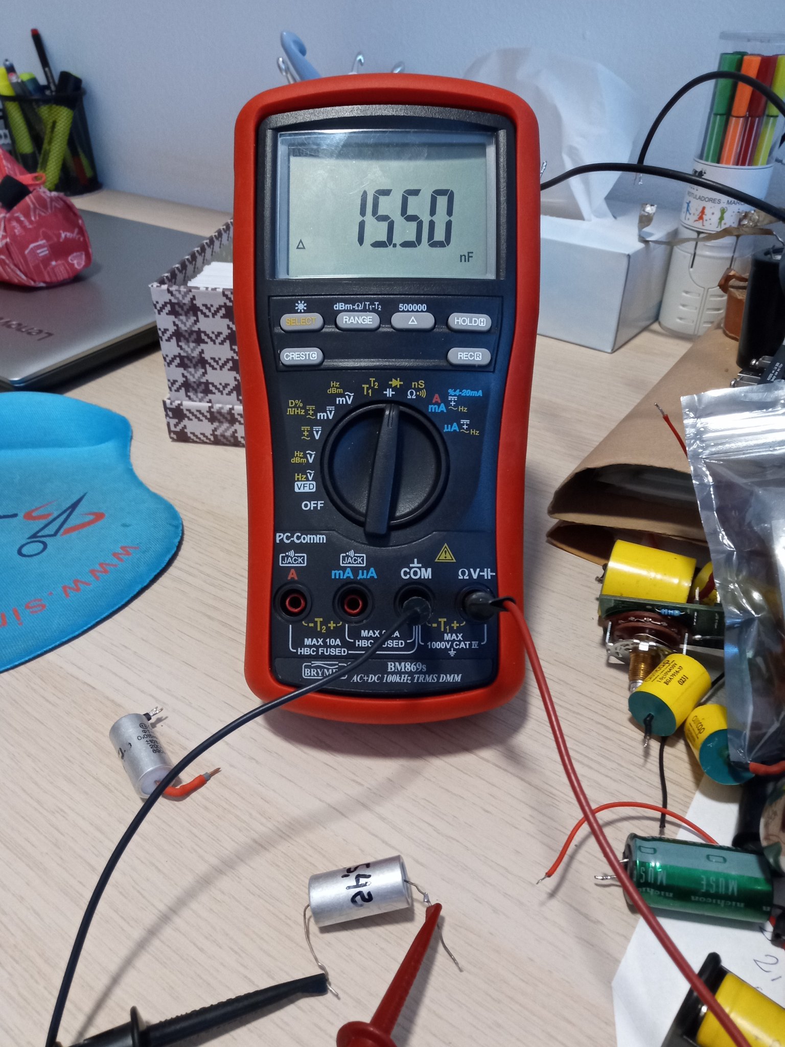

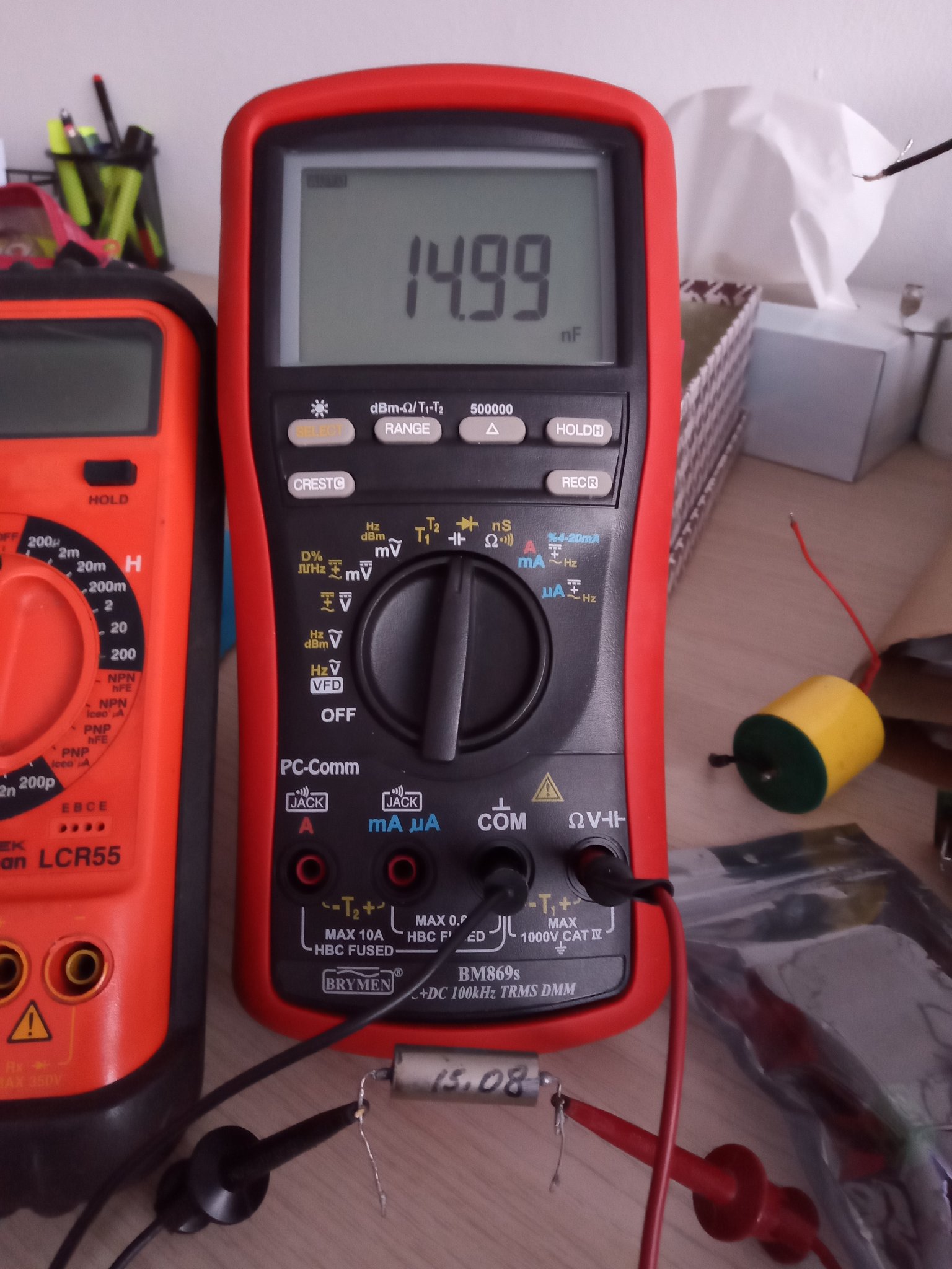

Can this high quality DMM be reliable at nF level without Kelvin wires as dedicated LCR meters have? Also test another nF range capacitor for reference. Film, better never used. Does it read it correctly within tolerance? If the DMM is so true then replace drifter with new C3 of proper capacitance. RIAA curve shaping components if that much drifted can really throw off the music's tone.
What capacitor did you use? What is the voltage rating?Salas I desoldered the measured when built C3 15,42 nF of one channel, ooops look now how much measured!

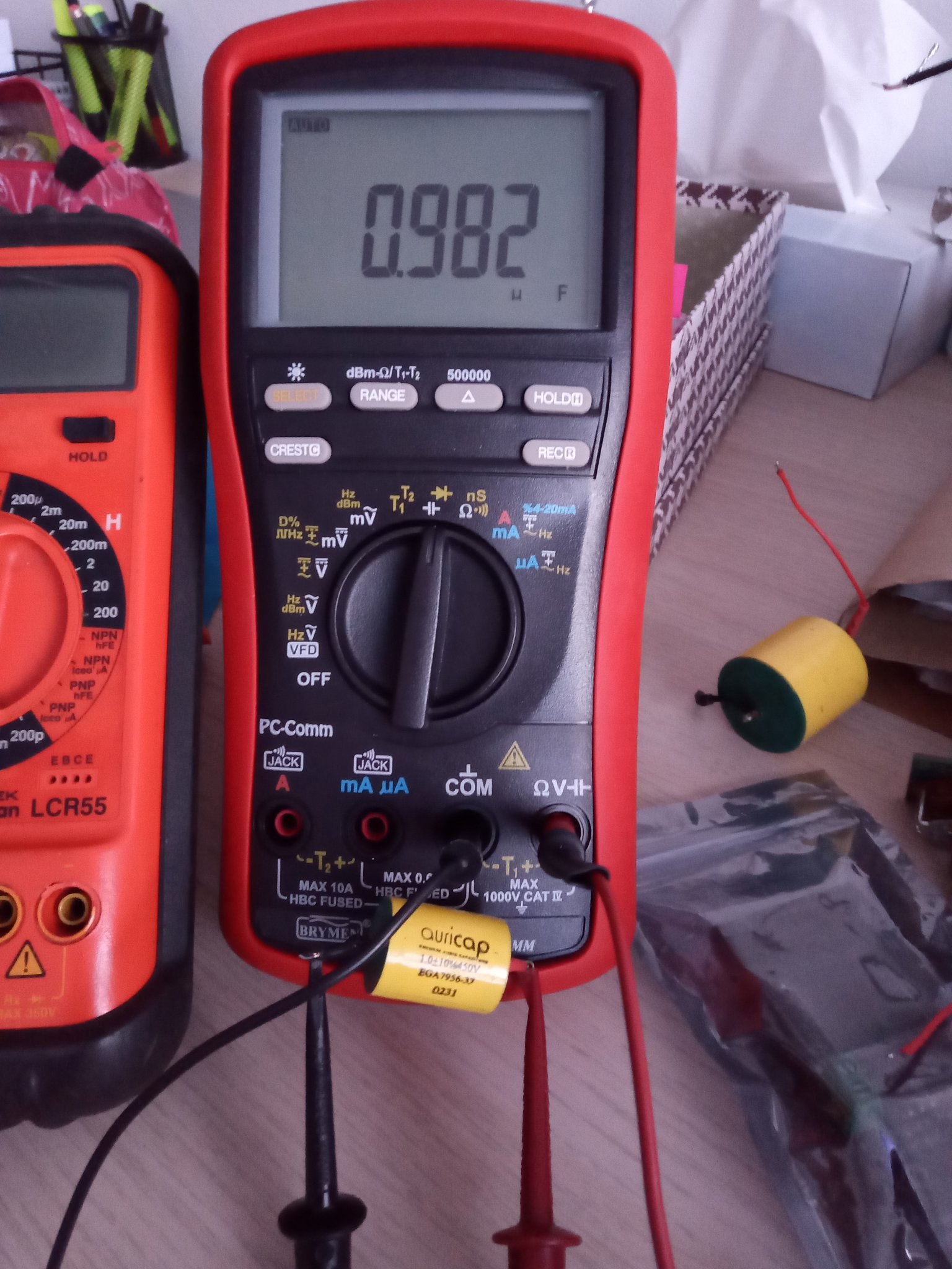

At 10uF level the test cables don't interfere. Try 1nF-10nF capacitor. That's the range you are searching accuracy for this application.
FT-1 Russian teflon cap rated 200V & 10% toleranceWhat capacitor did you use? What is the voltage rating?
Auricap it's 1uFAt 10uF level the test cables don't interfere. Try 1nF-10nF capacitor. That's the range you are searching accuracy for this application.
Maybe random, maybe b-stock unreliable, maybe too close for working voltage. Use higher Voltage spec if you got, avoid oil types.
How on earth a film cap has drifted as this one?
FT-1 are teflon film with aluminium foil....

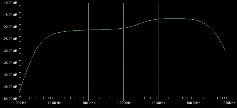

Bad ex-Soviet stock sample maybe. Got humidity in, whatever. That drifter stole your mids warmth! See curve 8.25nF.
Look usable. Bringing only slight warm tilt.FT-1 nearest value to 15.75nF are 15.92nF & 15.96nF are excesively high value Salas?
Ok I will use thanks.Look usable. Bringing only slight warm tilt.
