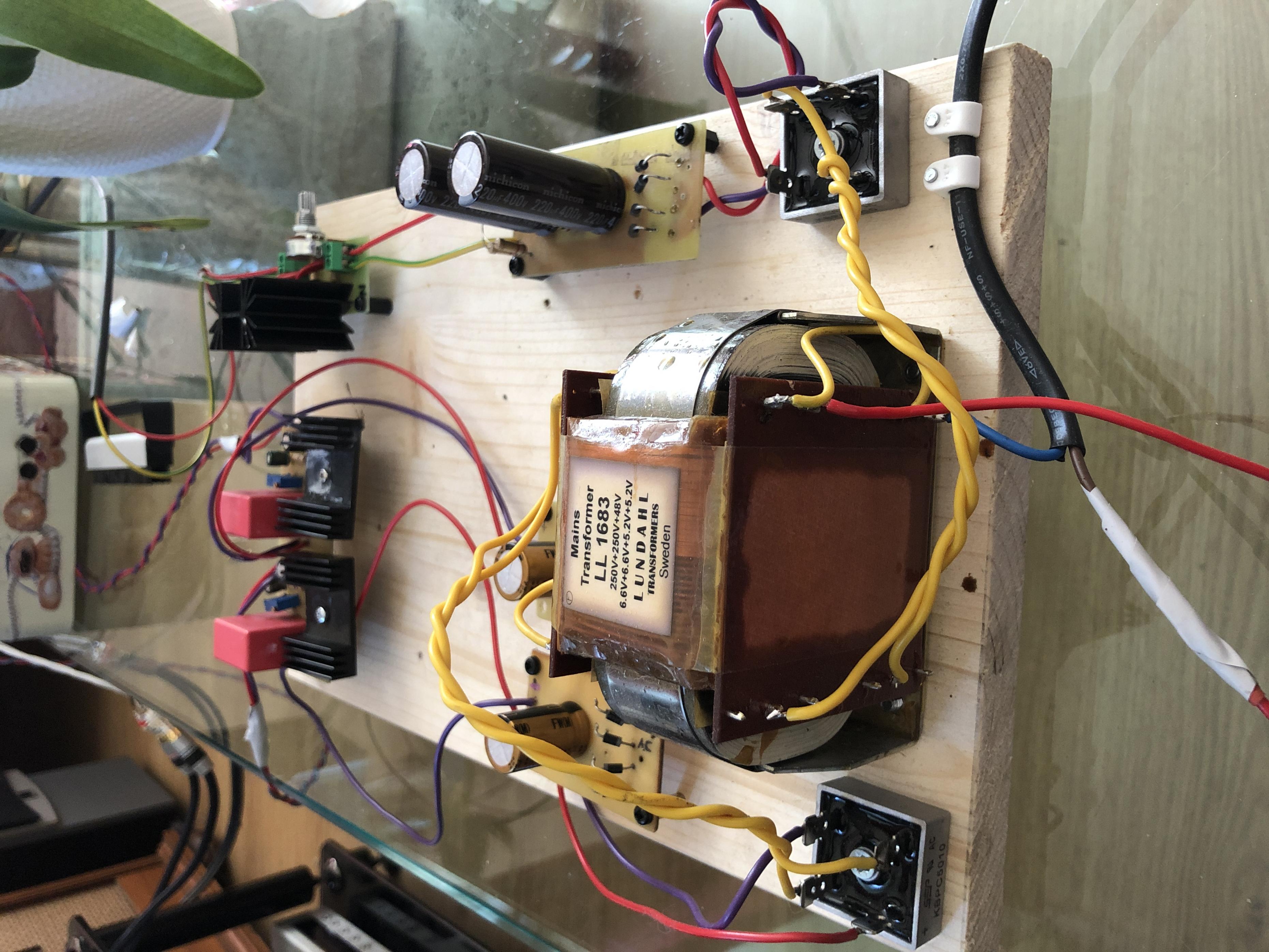

I’m happy and proud 🙂
Thank yoy, Salas for the project!
Finally, after a long time I got the sound 🙂
Just now only a testing project in a coockie box, but will be finished, of course 🙂
Sounds great. Just now testing with easy solution for 300v supply, no your design shunt.
The problems - have to fight with hum and seems high frequencies are too low. Have to check RIAA capacitors.
Use shielded signal cable if you didn't. Show us inside the cookie box if not solving hum, maybe we see something to suggest changing. About HF the lower the last parallel cap's value the higher the HF (C3 in rev1.2), but it could be missing treble due to a mistake as well.
Thanks, Salas.
Problem solved. Gone through earlier posts and find some grounding problems in my design + ground loop. Also one error at input and no more hum or buzz at all.
Next have to find proper caps for RIAA (now cheap trash) and may be experiments for interstage cap. Just now russian ССГ-2.
Thanks, Salas.
That's all very good. Congratulations. Let us know with what value Riaa HF cap you ended up with. Must be tight in tolerance spec for good left-right response balance if you can't otherwise screen some looser spec samples with a good LCR meter. But while deciding its optimum value in your system, recheck that the VTA geometry and needle ware are not possibly neglected factors for dulling the HF.
Finished with PIO caps K40Y-9 47nF and 15.5nF. Tried also for interstage K40Y-9, but old silver ссг-2 sounds much better for me.

Lately I've been on the hunt for a new tube phono to build. The fact that this one uses the 6N2P-EV (which I have in abundance) and a relatively small number of other parts has made it a really attractive option.
I've previously built a couple of tube phonos off PCB and about four different HV B+ power supplies (including a SSHV2 and a Janus Shunt). I know this isn't a beginner project, but I'm still tempted..
I've noticed in this thread some chatter over the years about a potential PCB. Since I have been wanting to build a new tube phono AND try designing a PCB, here I am. I thought I'd at least get a preliminary design out here to see if anyone thought this might be workable.
In the attached, I started with a hand sketched point-to-point wiring diagram and tried to to arrange the parts in a somewhat logical way to simplify the PCB. This version includes:
.75mm GND track
.50mm Heater Tracks
.50 B+ Track (with .50mm minimum clearance)
35mm LS capacitor pads to fit NOS Russian caps or a wide range of various boutique caps
.1uf caps are footprinted for Kemet 1% (F461BC104F400A)
All resistors except R2 and R10 are Vishay CMF55. R2 and R10 are Vishay CPF2.
If this looks like a viable start, I'd be interested in getting input (even if it never goes to fab). If it's a complete no-go because of part layout/wiring complexity/etc, that would be helpful to know too so I can just cut bait and buy a Broskie PH-2 kit!
