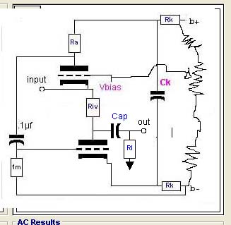

Howdy everyone,
I'm wanting to do a valve I to V converter, and would like to work with chips with current out swinging around the vref (aka vcom2) point and not ground.
I.e the ad1853 and pcm1738
Attached is a circuit that I have used with chips whos current out swings around ground like the pcm63. This I to V converter is known as a Lohoff I to V, the idea comes from the TubeCAD program
I'm no tube guru, but for a dac with current out at vref and not ground, will I be able to eliminate the 2.7v vref voltage offset on the current outs by adjusting the bias on the grid aka "vbias"
OR do I have to float the whole valve circuit at the vref potential and transformer couple its output?, (probably after a buffer of some sort? )
I am sure I have seen this technique mentioned here before, but for the life of me canot find the post/thread
Mark

Mark,
>I'm no tube guru, but for a dac with current out at vref and not ground, will I be able to eliminate the 2.7v vref voltage offset on the current outs by adjusting the bias on the grid aka "vbias"<
By adjusting "Vbias" you will be able to set the input terminal to the circa 2.5V (my measurement on a PCM1738) that is coming out of the DAC.
It should work OK, and *maybe* even sound great, but it won't be very DC stable - single ended/non-differential tube DC amps drift all over the place - and to do it properly it would need some form of an opamp based servo to hold it all in check.

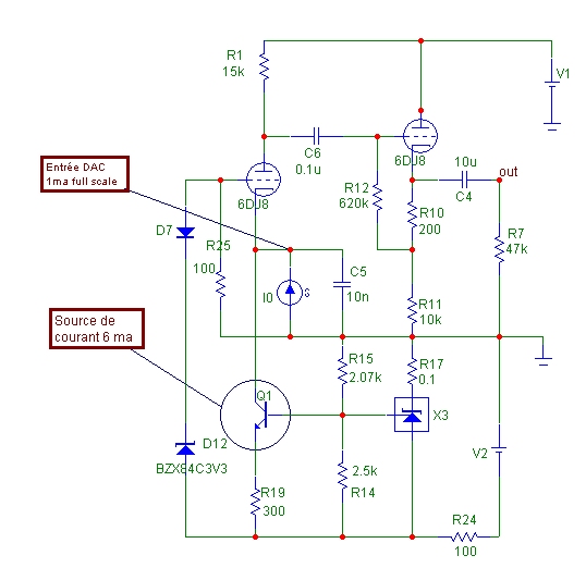

Hello
I work on a similar project, but for ad1865, then I have a reference at 0v, but the problem is the same.
My first simulation :
1ma give 15volts at the cathode follower output.
I made a regulation for the grid ref, tl431, zener and Diode for stability. This fixes the grid/cathode voltage.
The 2.5 volts ref of the tl431 is used for the css ref too (transistor base).
Only simulation for the moment.
Philippe

Hello Craig and AW,
I am indeed looking for a complete solution, and would dearly like to try an all valve I/V (or one with transistor servo), and I too believe an opamp is not the ultimate answer. I have tried discrete transistor I/V's and would like to round out my experience with an all valve version if possible
Dac's having current out points referenced around non ground potential does make it a little trickier. Do you have any suggestions for a method of keeping the cathodes at vref? or any other solutions. I have not based my selection of the Lohoff circuit on any solid facts or arguments beyond the Tube Cad software's suggestions.
Mark

Hi Mark,
The circuit you have there should work. You have the Vbias trim to set the upper tube cathode voltage to the reference voltage the DAC normal uses. You just need to make sure that during power startup or shutdown that the DAC output compliance range if exceeded does not have excessive current flow into or out of it.
There may or may not be clamp diodes on the output of the DAC chips to protect them from a ceratin amount of excessive output complaince range excursion. I am not sure from memory if that is covered in the datasheets for both the DAC chips you mention.
If you use the circuit you have already you can try different configurations to see what you prefer. You could put a servo on the Vbias point if needed but it may not be neccesary.
The circuit I had in mind would have just used the upper tube portion as the I/V with a current sink on the cathode side. The output signal would have been from the Anode load resistor through a DC blocking cap to a voltage follower buffer.
The Lohoff circuit you have does the pretty much the same thing but looks like it presents a lower impedance to the DAC o/p.
cheers, craig

philbyx,
Your circuit has the 6DJ8 I/V grid reference dependent on the negative rail. Simulate it with a different lower rail voltage and you will see what I mean.
You need to reference the bias voltage generator such as the diode to ground and resistor to the lower supply rail. That way your voltage reference will be referenced to ground or common.
A 6dj8 needs about -1.9 volts on its grid at 6 ma for the cathode to be at 0 volts. A LED is pretty close to that voltage.
CraigBuckingham said:philbyx,
The TL431 is a shunt regulator, which keeps the voltage between the negative rail and the ground constant.
The zener+diode maintain the grid at a constant voltage referenced to the negative rail.
Then the grid voltage is referenced to the ground and constant I think.
Philippe
Hi Philippe,
Yes it will work the way you have it but not ideal.
The circuit has two voltage generators in series with gnd. TL431 shunt more -ve to gnd then zener + diode referenced to TL431 to grid. -ve rail rejection is worsened as R25 sees noise voltage (rms sum) from D7, D12 & TL431.
Still low impedance to ground yes but more convoluted grid reference.
More noise on grid might not matter so much in this case as it is fed with a DAC current source/sink o/p.
Best to reference with low noise voltage generator -ve from ground and fed by current sink.
Regards CB.
