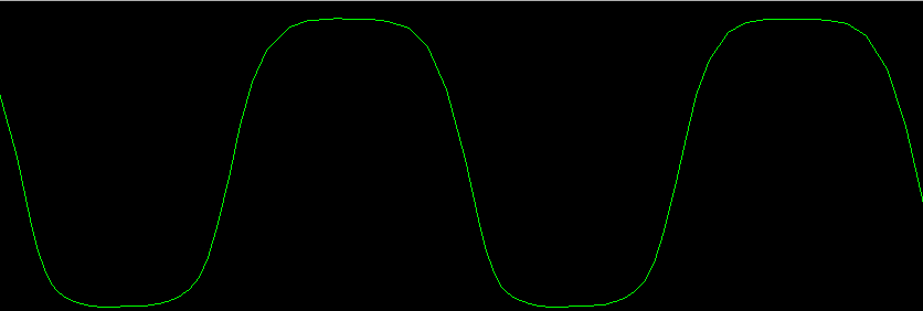

I think I have just got something to work with a small Pentode, I have attached a picture of a simulation signal that is the same as I get on my O-scope with a sinewave at the input.
Is this what is refered to as a compressed signal with the peaks compressed a little?
Or is this just symetrical clipping or are they one & the same thing?

Thanks RTF671,
I see what you mean, so the idea is to compress it more but without clipping the signal is that correct or is ok to have some clipping as well.
If I have it right when the signal is clipped the peaks are sort of flattened out--correct?
I had it compressed a lot more but convinced myself that it was clipping the signal & wasn't sure if that is what is required?
Thanks RTF671,
Now I get the Idea😀

Compression and clipping are not the same thing to me. Compression would not cause clipping. However, clipping causes compression.
Compression is where increasing the input by X% increases the output by less than X%. It's represented by this type of graph. The 1:1 is not compressed whereas the others are compressed.
Yes, my understanding is that clipping and compression are quite different. Clipping distorts the peaks, compression does not. If I show you a clipped sine wave you can see the effect. A compressed sine wave looks exactly the same as an uncompressed sine wave, only smaller. To see the effect of compression you have to look at the whole music waveform - then you see that the volume peaks are smaller and the quiet bits are louder.
Clipping chops the top and bottom off the signal. Compression is like an invisible hand riding the volume control slider up and down.
