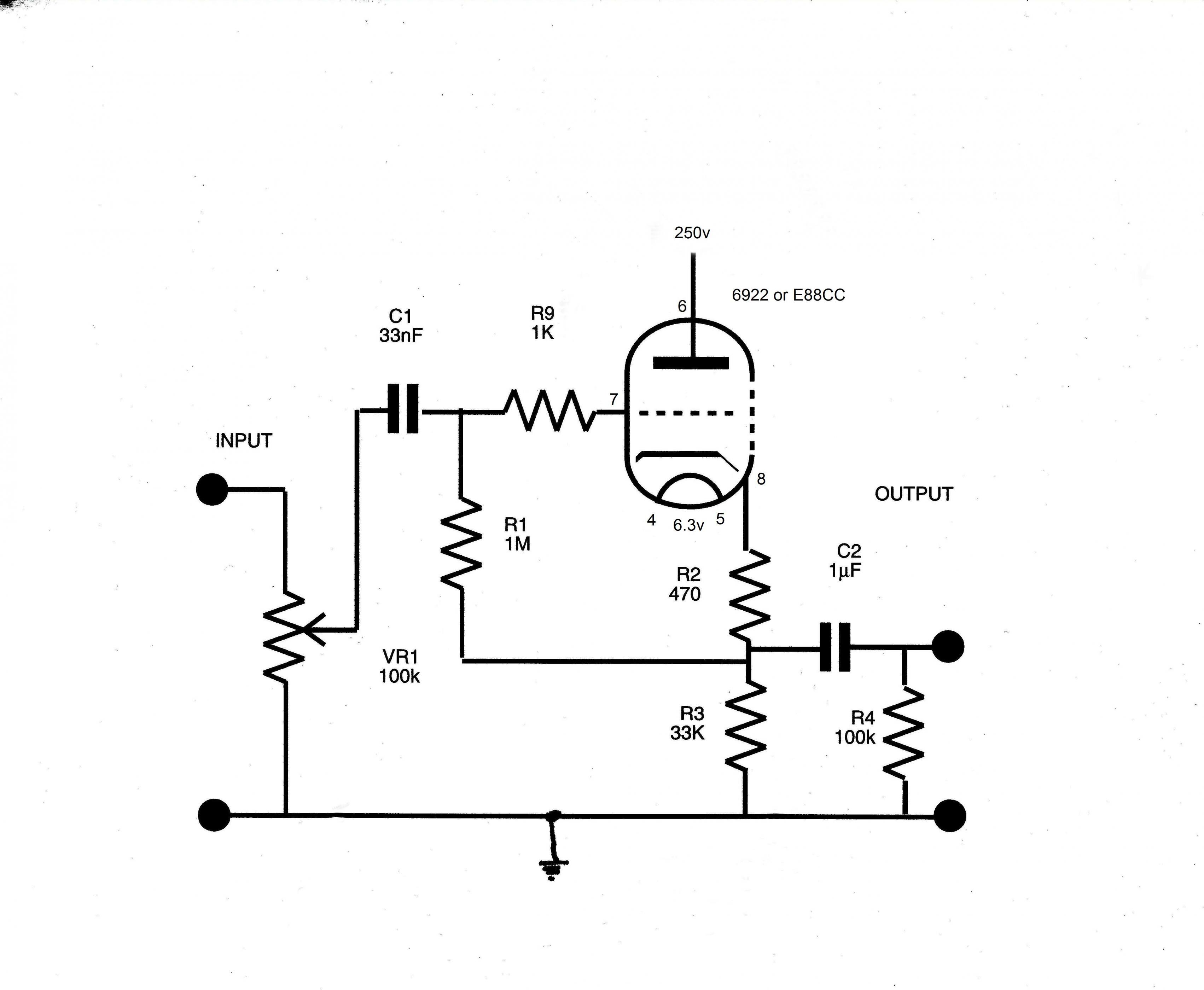

Bit of help please. I have just built a valve buffer stage to replace the IC one in my preamp. The phone stage is valve using two nos. Mullard ECC83’s and was a revelation when it replaced the IC one. So no problem there. The power amp is a WAD K5881 which I built years ago and has upgraded components and is great.
The small problem I have is that the new buffer stage (see circuit below) sounds fantastic but has a slight hardness at the top end, apart from this everything else, sound wise is great. Questions are. Do valves get sweeter after a while, fitted are Tesla E88CC’s and were only £8 each so a bit cheap. Also the input cap is a cheap wima polycarbonate, whereas the output cap is a very good Polypropylene film. Could these be the problem?

I also suggest to remove grid stopper, a cathode follower doesn't need it, and take C2 directly from the cathode.
This schematic developed for E88CC.
12AX7/ECC83 and 6922/E88CC are totally different tubes.
For example with ECC83 the output impedance of CF about 520R, with E88CC 94R.
At line level input the distortion is low with both tubes, but E88CC produce about 1/10 distortion than ECC83 (in this project).

Leave C2 where it is. A resistor at the output of a follower helps keep it stable into capacitive loads. R2 has this function, as well as provdiding bias for the valve.

Ran some loadlines and the design looks solid. The 470R bias resistor can stay.
Have you o'scoped the output as working into the input/output cables? The E88CC is an RF type originally intended for use as a VHF cascode. This high frequency hardness could be due to an instability that's leading to a damped RF oscillation that's quite possible as the type likes making RF. You might try increasing the grid stopper to something like 4K7. Make sure it's a C-comp type as these have lower internal inductance than metal film types.
Do not remove the grid stopper R9, 6DJ8 based cathode followers can oscillate without it. (from experience!)
AGREED! Also, use a carbon composition part in the grid stopper role. Additional protection against parasitic oscillation can be obtained by using a 100 Ω carbon film stopper on the plate.
Replacing C1 with a low WVDC polystyrene part may help.
The value of C2 is suspect. If the buffer is to work into the 10 Kohm IHF "standard" load, the minimum value necessary is 3.3 μF.

Grid stoppers do not have to be CC, as the aim is simply to add sufficient loss. Grid stoppers can be inductive resistors, or resistive inductors.

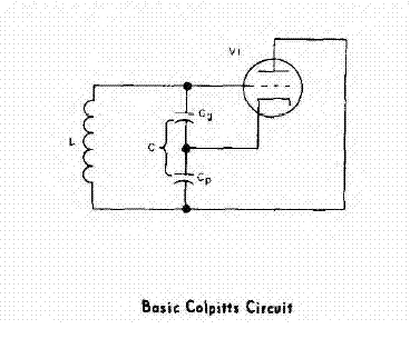

Many times if the circuit oscillates, is not because of the tube, instead by an improper wiring. The circuit below is a Colpitts oscillator. If the input wiring isa bit inductive, and the capacitances are the wiring and input/output ones clearly form a Colpitts oscillator.
Adding a grid stopper only reduces the Q of the tank, but oscillations can still be present. It is a good idea to reduce the strays, IMHO.

Duke1978, have you tried to replace the buffer for a wire?
Maybe you do not need the buffer at all.
