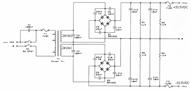

Valve buffer gainclone - voltage doubler
OK trying to save a few bucks I started reading up a bit about voltage doublers, and I think I at least get the basic principles..
My Power supply for the GC looks as follows:
I got this basic outline of a voltage doubler looking as follows
Now the question is this... please don't laugh.
Can I connect a voltage doubler to the above PSU , or would it need its own trafo..?
The simple answer is: No, you cannot connect the voltage doubler you have shown in your post to the power supply in your post. BUT, you can ADD a voltage doubler to the power supply in your post, it would look somewhat different than what you have drawn - some extra diodes and capacitors. It would also need regulators for the HV rails, this should not be a problem.
I suggest that if you are going to be playing with tubes, you should read the back-issues of the tube cad journal, by John Broskie, www.tubecad.com, he has one complete issue devoted to voltage doublers and tripplers, and how to get higher rail voltages from existing lower voltage power supplies. Surely you don't expect us to do all your work for you? 🙂
