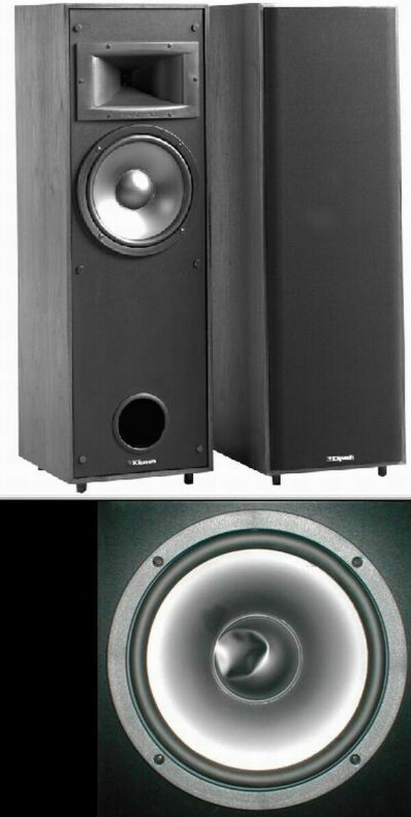

I have an option to buy these speakers (set of 2), but want to know:
1) What is a realistic 2nd hand price for them, taking into account that they are about 7 years old and the 1 got a dent in the dustcover.
2) How can I remove the dent?
I am listening to them now on my modified Mullard 5-20's and they sound really AWESOME. I cannot hear that the dent cause any interferance of any kind.
Thanx for any suggestions.
SPECS:
KLIPSCH KG 4.5
FREQUENCY RESPONSE:
36Hz-20kHz±3dB
SENSITIVITY:
95dB @ 1watt/1meter
POWER HANDLING:
100 watts maximum continuous (500 watts peak)
NOMINAL IMPEDANCE:
8 ohms
ENCLOSURE TYPE:
Bass reflex via front-mounted port
DRIVE COMPONENTS:
Two-way system using one 1" (2.54cm) polymer dome
compression driver tweeter with a 90°x60°
Tractrix® Horn and one 10" (25.4cm) ICG cone woofer
TWEETER:K-85-K 1" (2.54cm) Polymer dome compression driver
HIGH FREQUENCY HORN:90°x60° Tractrix® Horn
HF CROSSOVER:
1600Hz
WOOFER:
K-1005-K 10" (25.4cm) Injected Carbon Graphite cone
DIMENSIONS:
37.5" (95.3cm) x 12.25" (31.1cm) x 12.75" (32.4cm)
WEIGHT:
54 lbs. (24.5kg)
ENCLOSURE MATERIAL:
Medium density fiberboard construction (MDF)
YEAR BUILT:1996

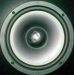

And a pic of them and the ugly dent.

I have a pair of these that I keep around for their high sensitivity and laid back sound. They generally go for $250-300 US per pair in good condition.
suck
just don't use it if you think your vacuum might be powerful enough to suck up the whole dust cap, rather than pulling out the dent. This is generally only an issue with dust caps whose adhesive has deteriorated over time.
dust cap wont affect performance....I love my Klipschs...have had them 20 years now.....vacuum is a safe wayjust difuse the nozzle abit so it does not want to suck the whole box in...LOL
