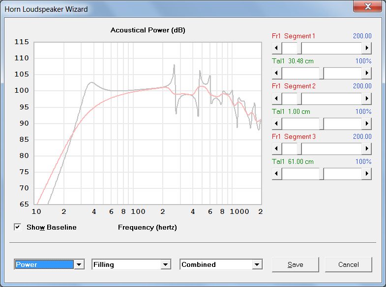

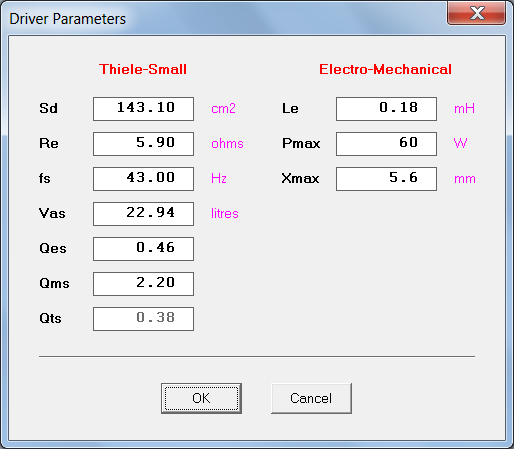

I have a transmission line(-ish) box designed for a Peerless 830883 in Leonard Audio Transmission Line. It requires about 0.5lb/ft^3 of stuffing before the response flattens out enough that it looks like something I would want to use though.

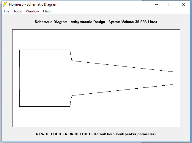

The box is not precisely a transmission line: it has a fairly large open volume behind the driver, followed by a tapered tube is quite a bit shorter than the intended quarter wave tuning.
Because the box does not fit the precise definition of any particular type of enclosure I know of (would this qualify as a TH or BLH?), I wanted to validate this in another program. When I set up a similar enclosure in Hornresp, the peaks and nulls seem to show up right around the same frequencies as they do in LATL, they're just so tall that it doesn't look like a usable response. Is Hornresp able to simulate stuffing? It looks like it used to have an option to that's not there anymore. And anyway, who do I trust here?
Something in this ballpark. Rms and Mmd aren't correct because they're not given directly in the spec sheet and I haven't backtracked through T-S formulas to figure out how to compute them.

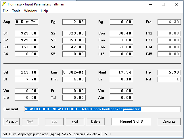

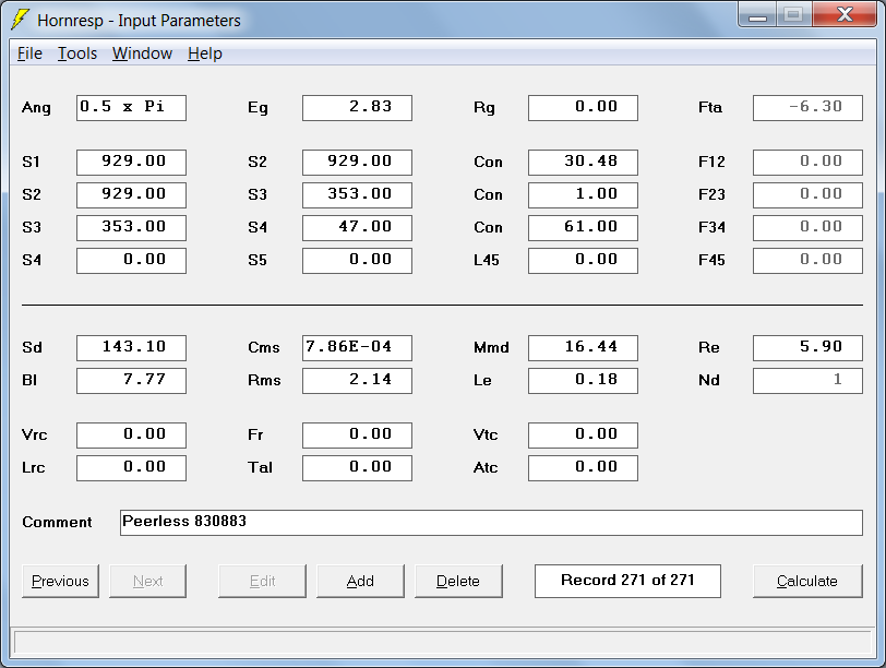

1. Double-click on the Sd input text box in Edit mode to enter driver Thiele-Small parameter values as shown in Attachment 1.
2. Resulting equivalent electro-mechanical driver parameter values should be as shown in Attachment 2.

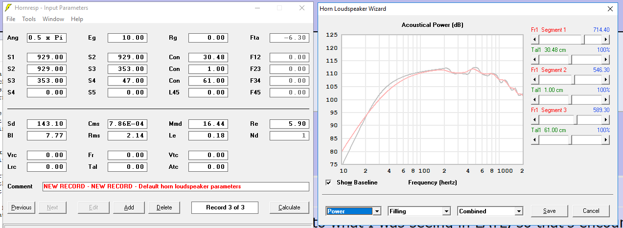

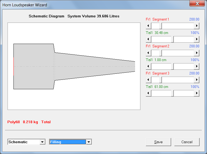

3. Select the Loudspeaker Wizard tool to add absorbent filling material as shown in Attachments 3 and 4.
You have specified radiation into eighth space (Ang = 0.5 x Pi) - is this what you want?

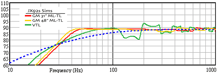

Augsperger called a TL that had a large chamber at the beginning appended by a longer section with a constant but smaller area a Coupling Chamber design. If you taper that appended section, which I have done quite successfully, I'd still call it a coupling chamber design. George indicated the coupling chamber "should" contain about 1/3 of the total line volume, but my experience says it can be more, like 1/2.
Paul
From the description you have a saline — Augspurger has a more descriptive name, can’t recall it. Can you post a sketch?
dave

It looks like it would probably be hard to overstuff it. IIRC this design is up to 6-7dB louder than an equivalent sealed box around 40-50Hz, close to what we might expect for a bass reflex. It looks like even if I'm dropping that a few dB or more with overstuffing, I'm still doing better than I would with sealed, and with much lower excursion at the bottom end as well.
Looking forward to checking out Augsperger (http://diyaudioprojects.com/Technical/Papers/Loudspeakers-on-Damped-Pipes.pdf) in more detail seeing as his abstract says one of his alignments gets close to sealed box response with reduced excursion - basically what I'm going for. I'm crossing over to a sub, just looking for the lowest distortion design for my midbass, not necessarily loud.
