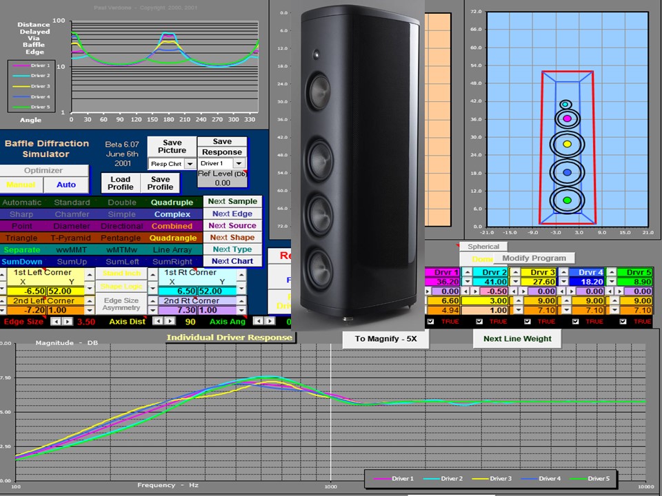

The Ultima Salon2 and Magico Q5 use three 8" woofers in their tall hi-end speakers. Run a few comparison bass sims between the 8" SB23BAC45-8 woofer and 6" midbass.
