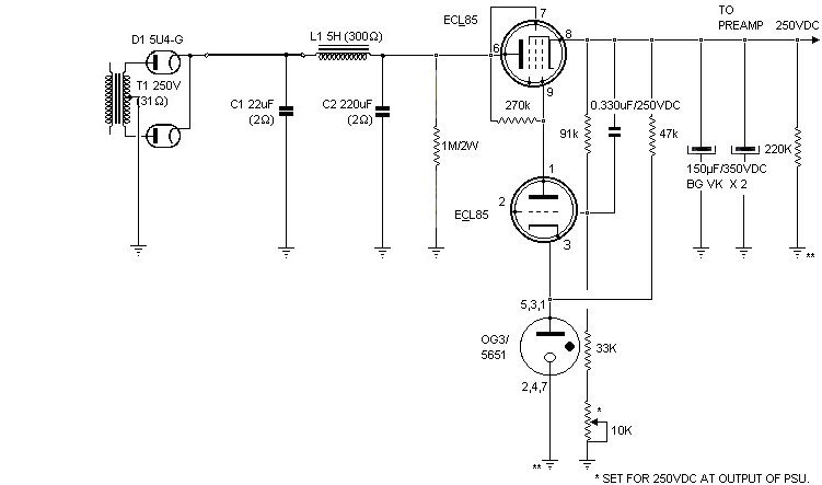

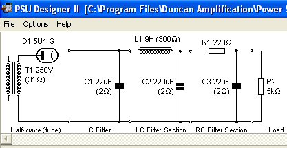

Ok here's what I came out with just to make sure that understand a little what going on 🙂
I didn't put any regulator because I'm a bit mixed up about it. I mean, where can you find regulator that accepts 250VDC ? Is there something to do with floating ground stuff ?
Well, here's my progress. I tried to do my best to achieve 250VDC but I have serious problems with current capacity of the rectifier. My load resistance is too low ?

Well if you look at the tube regulator as posted here:
250VDC REG.
You'll see that there's no need to float a semi-conductor in the HT line.
The sim shows a half-wave rectifier.
What you need to simulate with the program is a full-wave rectifier.
You need a 250-CT-250 VAC powerxformer with the CT grounded feeding a capacitor input filter followed by a choke and cap (CLC).
Here's an example of an amplifier using such a supply:
VT 52 SRPP
On the same site there are a few other examples of this.

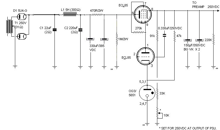

Please don't laugh...
Here's what I came up with...
I don't know if it would work... The values are probably totally incorrect but it would be nice if someone could validate and/or touch-up the schematic a bit...
Are all those resistors/capacitors necessary ? I hope not 🙂
Should be fine...
You can drop the 470R resistor and the two 330µF caps.
Depending on the powerxformer you use you may end up with too much voltage prior to the regulator but nothing that can't be fixed in a simple manner.
Cheers,😉
EDIT: You won't forget the heater for the 5U4G and the regulator?
Should be fine...
Cheers,😉

Depending on the current rating of the xformer and the current drawn by the circuit the voltage will go either up or down: undercurrent spec voltage will sag and powerxformer will get hot.
Overcurrentspec, the voltage will rise. No big deal here as the choke and regulator will burn it off.
For the regulator to work properly you need to have at least a 50V drop across it, more won't hurt within reason. (heater to cathode insulation can become a concern)
If it were me, I'd rate the filtercaps at 400VDC to be safe.
As SY points out the rectified voltage will be around 310-320VDC, add the drop of the choke and it'll be just about O.K.
Again, IMO you may be better of starting a little on the high side.
So, if hammond or whatever the supplier has a suitable 260-CT-260V xformer I'd go for that one.
As for the heater consumption: the regulator is best supplied from a dedicated winding so you'll need a 6.3V .875mA (1A is O.K.) per regulator.
A 5U4G needs 5V 3A, a bit more won't hurt.
A 6SN7 requires 6.3V @ 600mA but we'll like to be able to use a 12SN7 as well and use DC, so a 15V secondary @ 1A being common as mud I'd spec one xformer with two such windings, one per channel.
FW bridge rectified and filtered we can than use a 7812 2A reg and a power resistor to set the voltage at 6.3V as per the Blue Velvet preamp but there are many alternate ways.
Cheers,😉
Nice, They got one :
270DAZ 76VA 260-0-260 90mA 6.3 V@3.5 A
90mA should be enough current for your 6SN7 preamp right ?
In a first attempt, I'll go the single supply route... I'll leave the option opened for a dual supply.
As for the choke, 40mA will probably be not enough isn't it ?
(I'm refering to the following : Hammond 156G 9H 40mA 300ohms)
Otherwise, there's Hammond 157M 8H 100mA 259ohms Would it be more appropriate ?
Thanks guys 😉
Should be.
Here's the deal: use one rectifier, choke and caps, split to two regulators, one per channel and you'll never have this nagging "what if" feeling and no worries about crosstalk between channels.
Cheers,😉

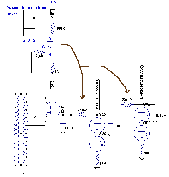

Here is a nice psu you might consider...
Advantages...Cheap...DN2540 is $1,50. Weighs a few grams...
and the VR tubes look purdy...

hi,
Bas,
If you don't mind my saying, the VR tubes in the heystack benefit from having a bypass cap each. Say .047µF each depending behaviour.
Cheers,😉
Bas,
Cheers,😉
Thank you very much for the suggestion 🙂
This origin of this "confusing" thread is that I wanted to use 5U4G rectifiers to supply a nice preamp (in that case, Frank's 6SN7 preamp)
Returning back at the start oh this thread, you probably read that I would do about anything to light up those rectifier tube 😉
Your comments are VERY appreciated guys !
