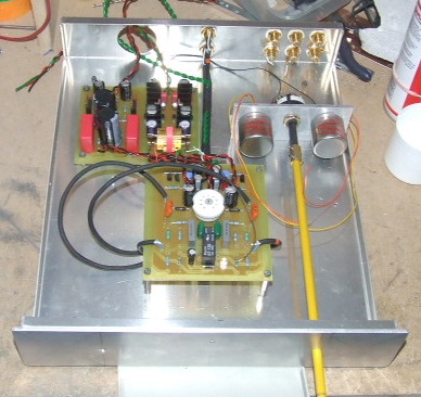

A pic of my slowly progressing version...
