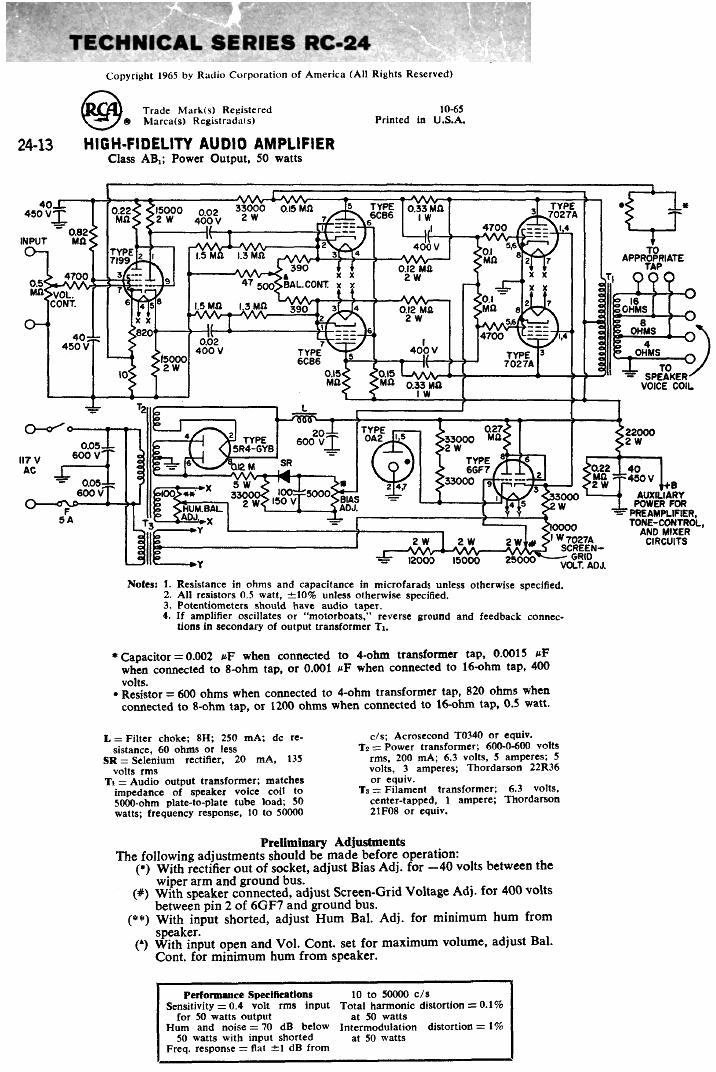

vacuum tube power amplifier 2 x 50 W
> I want to stick to this 1973 RCA schematic.... published in one of RCA's last vacuum tube manuals, I think it represents the state of the art of the seventies. (This is not a sixties design). ...I have some confidence in the RCA engineers of yesterday.
It appears in RC-20, 1960.
http://www.nj7p.org/Manuals/PDFs/Tubes/RCA-RC-20-1960.pdf
There is more detail in RC-24 and I will attach a snip of that one.
A super-similar plan appears in RC-19 1959-- same idea with a less elaborate power supply (cap-input, no G2 regulator).
http://www.nj7p.org/Manuals/PDFs/Tubes/RCA-RC-19-1959.pdf
I'd suspect it is the same home-brew, upgraded 1959-1960.
I think it "sells tubes". That is a LOT of tubes for 50 Watts. And high-profit tubes, 7199 7027 and even the 6CB6. To the tube sales manager, this is a Good Thing. I don't think it was *designed* to sell more tubes; more like, engineers got tubes cheap or free, so using another tube on a whim was no big deal.

The RCA 50 Watt amplifier design has been somewhat enigmatic to me for some time.
With three N Fdbk loops (2 nested ones, and one outer Global), the Schade like loop to the 6CB6 plate lowers the gain greatly for the loop to the 6CB6 cathode (by loading down the hi-Z 6CB6 plate). While the loop to the cathode is far more effective at reducing distortion.
Seems a waste of the cathode loop. However, it does linearize the V to I conversion of the 6CB6, for the "Schade" loop up top, so it's hard to judge the overall effects. But by lowering the high loop gain for the 6CB6 cathode loop, it is probably far more stable for DIY efforts being successful. This may be the reason it's that way, I don't know.

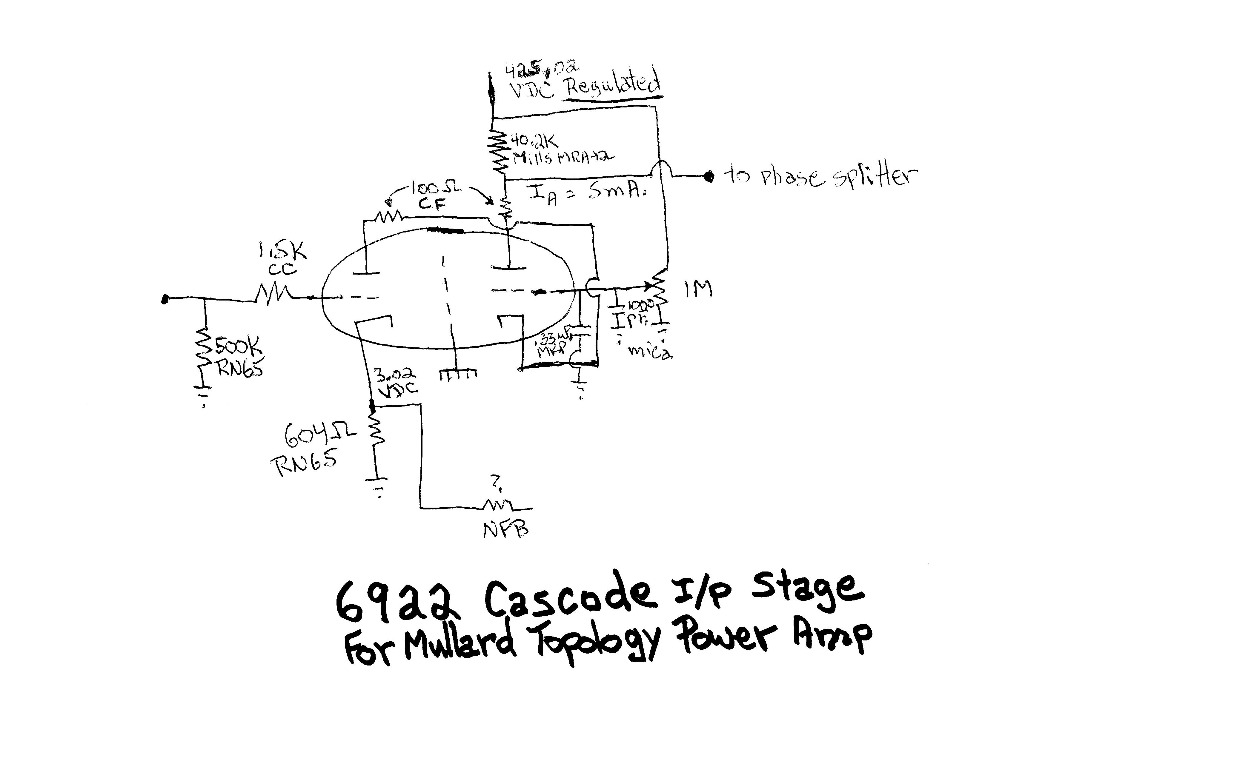

what constitute a very good tube amp design at this level power?
At the PP 6L6GC power level, the H/K Cit. 5 is certainly a good candidate starting point. It's a "Super/Duper" implementation of Mullard style circuitry. Stu Hegeman & Co. focused on high gm in the small signal circuitry.
The 12BY7 used as the voltage amplifier is getting scarce and (IMO) is best reserved for existing units. I've uploaded a 6922 cascode, which is specifically designed to replace that 12BY7. Additional tweaks to the H/K original are CCS loading the LTP tail and replacing the 6CG7 with an ECC99. Embellish the high gm theme.
Why not doing like this ?
Automatic (even) partitioning of the voltage over the triodes.
Current depends only on the cathode resistor (and supply)
Probably no need for a regulated supply.
Mona

It might appear that many of us are trying to rubbish this design; but (for me, at least) that is not so. One is simply pointing to fresher ideas. But let us then stick with this design. There are unfortunately several errors (with due respect to RCA) that do need pointing out (as can happen to the best of firms ....). You did invite comment:
Firstly, 600Vrms for the h.t. transformer. The 5R4 is a directly heated rectifier which will supply voltage some 20 sec. before the rest of the tubes have heated up. That delivers all of 848Vp momentary to C10 - a 450V capacitor! It is true that good electrolytic caps can stand overvoltage for a short time, but almost twice the rated value ... I don't think so. Then the circuit itself sees 460V before L1; that is taken as under operating conditions. That still puts C10 operating at theoretically its maximum. Should the line inrut rise slightly .....
Regarding this point then it is mandatory that two series caps of some 450V each with the necessary dividing resistors be used here.
The next point is rather more difficult to explain in a sentence or two. For classic pentode operation the screen grid is decoupled to the cathode.
Here the decoupling cap C2 goes directly to ground, but the cathode is not ground. With global NFB here is in fact quite some signal voltage between G2 and cathode here. The correct connection for C2 would be from screen (pin 3) to cathode (pin 6). You will notice that the input stage for the two previous amplifiers in the tube manual [designs 27-9 and 27-10) is identical; there it is done correctly (as in the Mullard 5-20 et al)].
One thing I do notice which is missing in most pentode output stages and done correctly here, is to load the output with a finite resistor so as to avoid instability on accidental open load. In this design done by the feedback resistor R29 (820 ohms for 8 ohm load + R6 (10 ohm).
Hoping not to exceed my welcome: I would like to indicate that chancing incorrct connection of the gnfb phase if feedback is 'the wrong way round' and experiencing motorboating (note 3 on page 609, Tube Manual RC-27), is a dangerous way of determining correct feedback phase. That could easily destroy an output transformer or perhaps a tube because of voltage peaks. Safer is to first use an R29 of safe value (say 47K in this case) and without C7, and input a small signal. If touching R29 to the output shows a small output rise, the phase is the wrong way round.
Wishing you well with this!

Regarding the C2 bypass cap connection for the screen of the 7199 pentode, I would try it both ways. With either a listening test or FFT test on the PC.
Normally one does connect the screen bypass to the cathode, especially for power stages, but here the ground connection would provide a small ultralinear like N Fdbk effect for the input pentode (via cathode voltage swing). The pentode will have a small expansive 3/2 or 2.0 power law itself (only a small signal input range), so some local N Fdbk via the screen might be intentional. I'm guessing the designer was well versed in design tricks and may have selected what sounded or performed best. Easy enough to find out (make changes while powered off). Probably not a big deal.
Oh, on any of those substitute pentodes mentioned above, one should check the screen voltage versus the original tube for idle current. Might require some screen V adjustment to get optimum or identical idle current.
