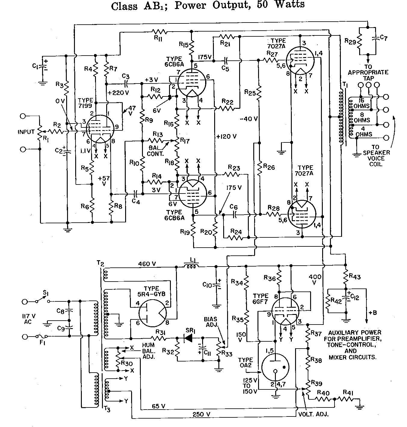

I am planning a new project, from the RC-29 RCA 1973 tube handbook:
"High-Fidelity Audio Amplifier 50 Watts".
I intend to follow the schematic as close as possible.
For now, I have collected most parts and I am designing the chassis.
Any comments are welcome!

Hi, looks a bit complicated to me, as power valves screen grids are fed by a cathode follower made with a 6GF7, and this tube is heated by another power trafo secondary. Also, how to calculate open- and closed-loop gains, if no resistor values are shown, and to assure frequency response of output trafo being same as of the the ones used in '73?
Hi Grasso,
all component values are shown in the RCA tube manual parts list.
Years ago, the power transformer was custom made for me by A.E. in Holland.
For stereo, it is a big one!
The seperate heater supply is for the 6GF7 only, that is the stabilized power supply for the screen grids of the output tubes.
Output transformers are from Hammond, 100W types.
All comments and suggestions are welcome!
Best regards, 968driver.

Hmmmm...looks like a bit of a mix of the SP10/20 circuit with Plate-to-Grid added, along with a loop of global NFB. I think it will measure very well, but I would take 2 of the 3 NFB loops out...🙂 Certainly the global...and adjust the other.

First, it builds on a extinct tube : 7199, the other are rare too.I am planning a new project, from the RC-29 RCA 1973 tube handbook:
Second: it's complicated and needs adjustment of balance control.
I would suggest something simular to dynaco Mk-III using 6550 and
the rare but obtainable 6an8 .
third: the separate screensupply could be scrapped and replaced by
a resistive network ( unless UL connection is used instead)
Do all these things and it's no longer the amplifier described or desired by the OP. None of the tubes are that hard to source, and worst case the 7199 can be replaced with 6BL8, 6AN8 or 6U8A.
I would ditch the 7199 and I would consider bandersnatch's advice as well, but only once the amplifier is actually working correctly.
Regulated screen grids are a significant performance enhancement and one of the attractions of this design.
7027 is just a 6L6GC.
6CB6 are readily available. ($1 on the ESRC Dollar List)
6EW6 is an upgrade for it. (6JC6 an even more radical upgrade)
7199 often gets substituted by 6AN8 or 6BH8.

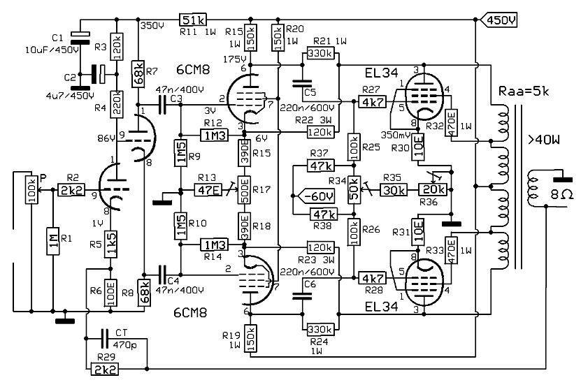

Yes, i found that design interesting too.
A problem is the high sensitivity for the today sources, something of ¼volts.Also the tubes are not to easy to find.
Sometime ago i cooked another version together, only on "paper" (can't build anymore).
More simple, no stabilised g2 but UL and one tube (findable Ask Jan) less with an input a little over 1volts.

One could suggest all manner of different circuits, it depends on what's desired.
Remaining close to the original, oine must remember that this circuit appeared in the 60's. UL was barely known then, as was not other alternatives.
I would support regulation for the 7027 screens, particularly wiith beam power tubes. (Beam tubes encounter a rather large variation in screen current during operation; 50W might not be reached with an unregulated supply.) For this one could use s.s. regultors - s.s. power supplies do not take part in the signal line and thus using semoconductors there do not make it any less of a tube amplifier!
But to slight modernising then: I would advise the use of the UL topology. H.t. would just about fit in with the power tubes' maximum ratings (possibly a wee bit more bias). For the rest, as advised above by other members.

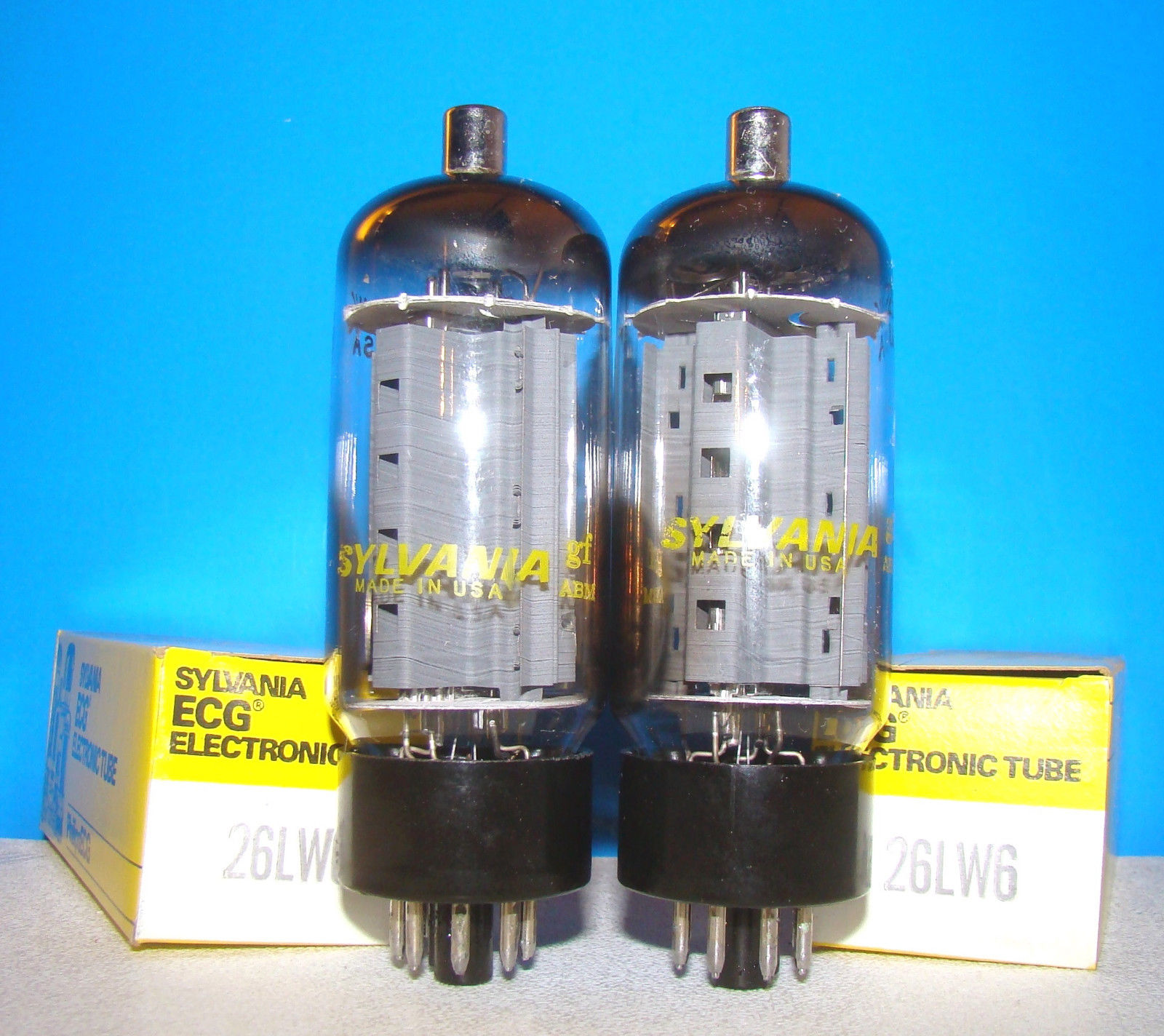

"50 tube Watts is a lot of power. What will you drive? "
Bigger tubes just look better, even for just 5 Watts out. Get some 26/36LW6 tubes.

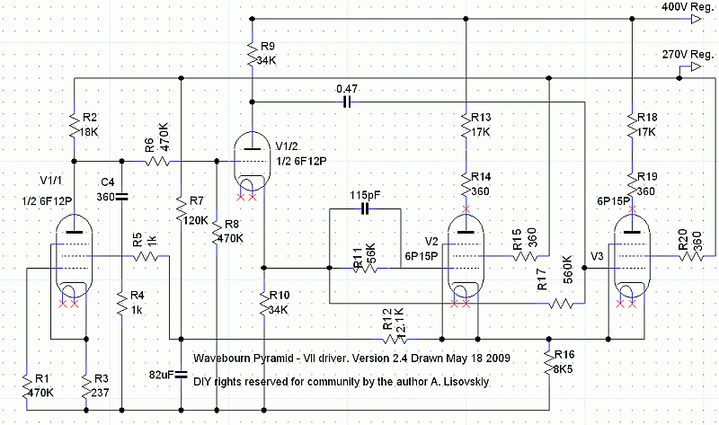

It resembles my Pyramid design; just different tubes, and different signal levels per stages. Also, I use solid state rectifiers and voltage regulators. ;-)
Also, I have 3 directly coupled stages, and a servo from the tail of LTP to the screen grid of the 1'St pentode to keep them all together.

I love nested feedbacks myself! It is a 21'St Century design!
I use 6F12P. And 6P15P in a driver LTP.
