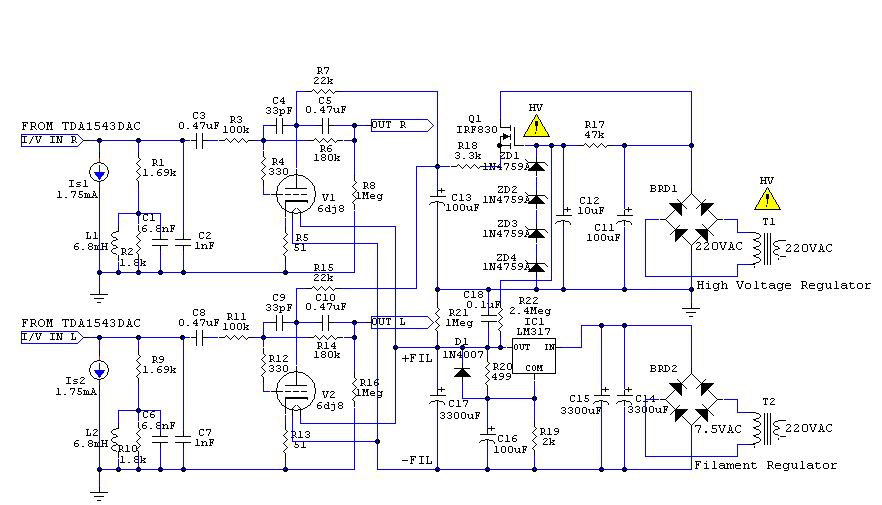

I'm modify & develop valve I to V converter from Thunderstone Audio and would like to work with chip TDA1543.
My schematic still use analogue filter RLC for smooth cutting edge treble control.

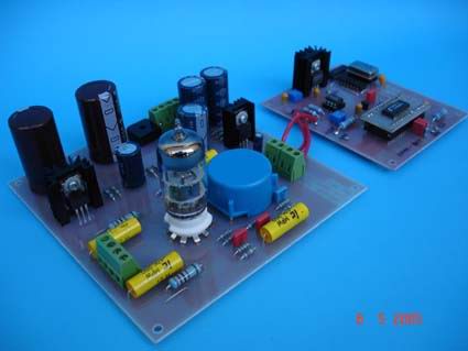

I hope you'll like my Idea with complete PCB.It's use 175VAC/0.2A & 7.5 VAC/1A for rectifier.It's spec from Thunds... is
V out = 2V Rms for digital full scale
Z out < 400 Ohm (rising at LF)
Z load > 10Kohm
THD = < 0.02% (2nd Harmonic dominant)
Freq. Res. 20Hz-20KHz +/- 0.3dB (no O/S)

maudan said:Hi
Very nice project.
What about the implementation of 1.75mA current sink you've placed in the electrical diagram? You didn't specify any component for this purpose.
Regards
Maurizio
I think it is there for simulation purposes - i.e. it represents the iout of the DAC (that for a full scale signal IIRC is slightly more than 2 mA)
Cheers
Andrea
