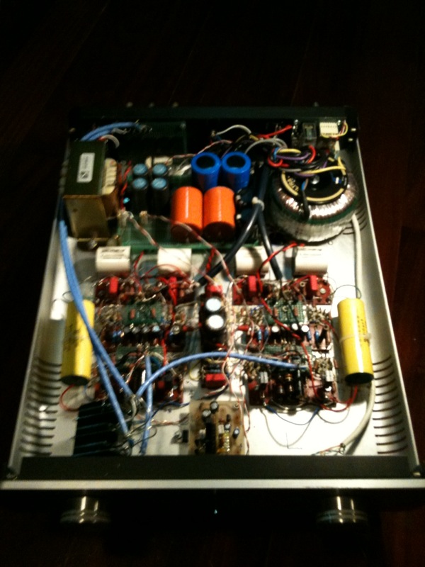

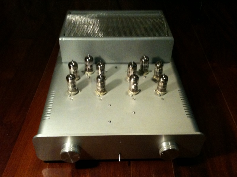

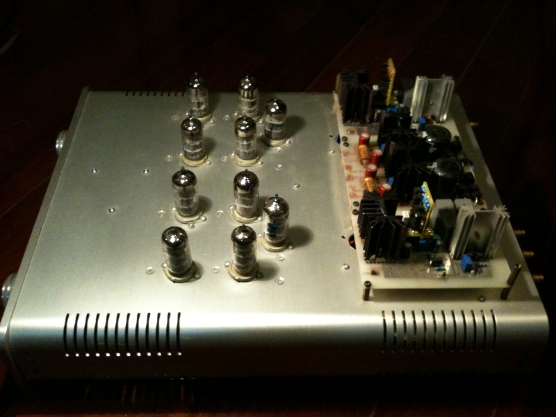

OK, here are my own RTP3 pictures (Allen - you have already seen these):
My project copied the layout of the "official" RTP3C as closely as possible. Mine uses a shunt regulator, but it is Emile Sprenger's HPHV, and not Allen's SuperReg.
Alex
