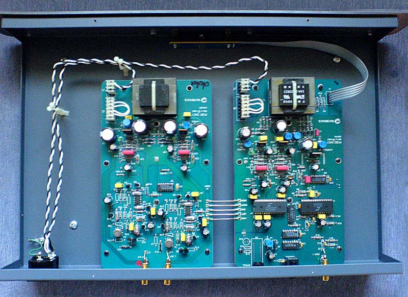

This is the original DAC:

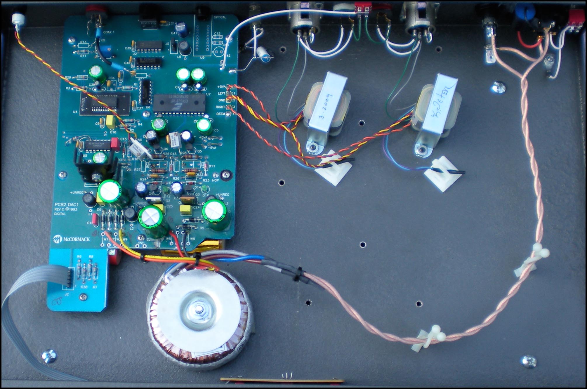

Here is the “state of art” version of the same DAC according to the 6Moon Audio’s story-tellers here please, and see where is the art hiding:
What happens to the dac moving them from rank C to the “state of art”? Modern components? New clock technology, etc etc?
No, no, no, the main part of progress that is the heart of this tale is “Throwing away whole the output board”! As you can see above.
Wow! You pay 1700 - 2500 bux for just a couple of soldering job? Of course WBT Nextgen, Nichicone Mouse bipolars etc Wonderful! Guess the output transformers are just for the sake of XRLs or just visual effects? The diodes are not changed anywhay!

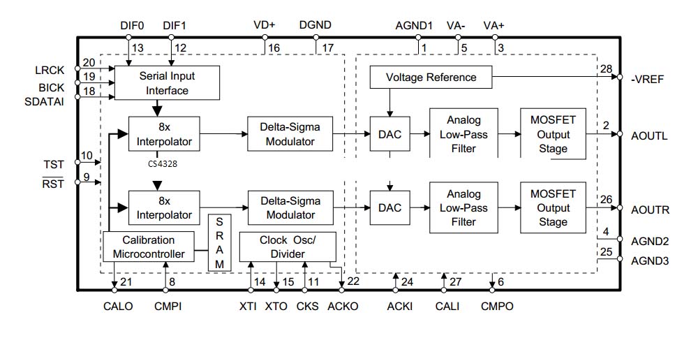

The chips have already its own LP-filter and yeh a MOSFET output stage too!
Okay our beloved engineer forgot to read the data sheet. Here our own dear diyer-friends have discussed it.

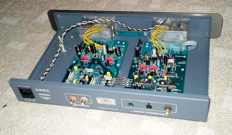

There is something that looks deeply scary in that last big picture.....
Look at the IEC inlet, now is it just me or is that a switch LIFTING THE MAINS SAFETY GROUND connection?
My take is that all this just goes to show that Barnum was an optimist.
It looks like some sort of half arsed tweeker has been in there to me, and frankly the design did not look that great to begin with, only the first photo even looks like what I would consider to be a finished product, but it would appear there is a market for any old junk if you slap a big enough price tag on it and add some marketing fluff.
