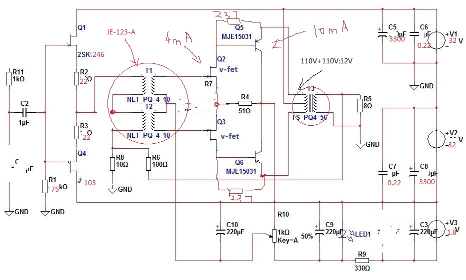

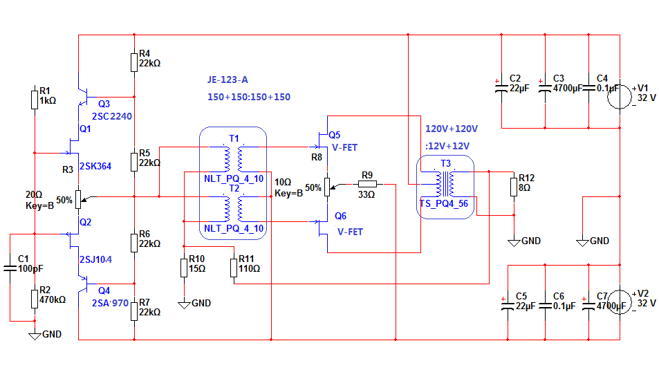

The problem may be:Not satisfied with the sound.
1. 4 ma bias on VFET absolutely too low, can not drive MJE15031, sound thin and harsh, no dynamics. Try to increase to 15-30 ma or change MJE15031 to 2SJ162 or TIP147
2. 10 ma output bias a little low, crossover distortion - harsh and subdued detail. Try 30-50 ma.
Thank you for your help.

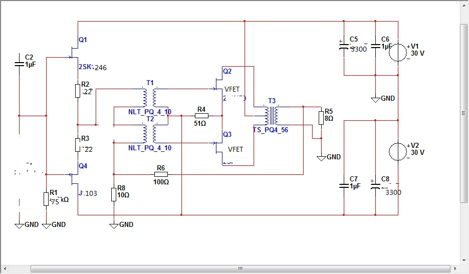

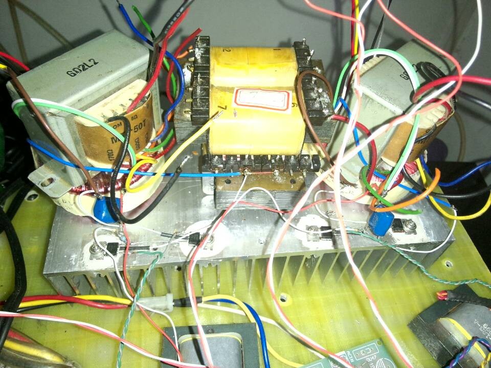

Has now changed to #44 circuits, Q3=Q4=7.5mA.

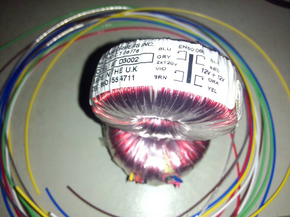

Sounds good, but because of reasons to use output transformers power transformers, high frequencies and some darker. Actual measurements from the 15kHz began to fall. Next time you use the toroidal transformer output. 120V+120V:12V+12V 30W。
7.5 ma and 30V = 225mW, good for headphone. If the sound is really good, you could try small line-out/headphone output transformer similar to Edcor xpp1-10kct-600 for high impedance headphone or xpp10-16-8k for low impedance headphone.

Yuo have chosen to use a tube type topology in your design. It would be interesting to compare it to a tube amp. I would get rid if the first transformer and drive the output Jfets with a 2N5551 concertina.

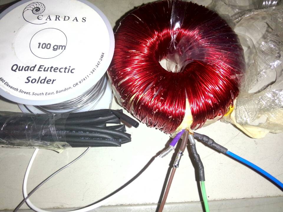

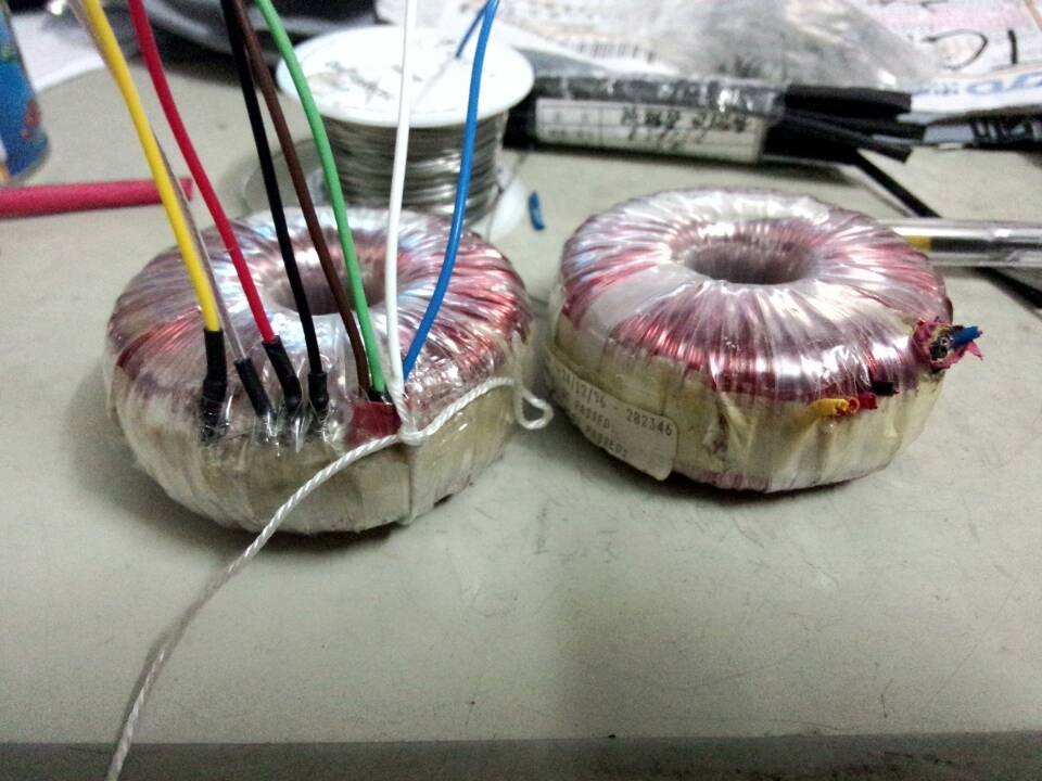

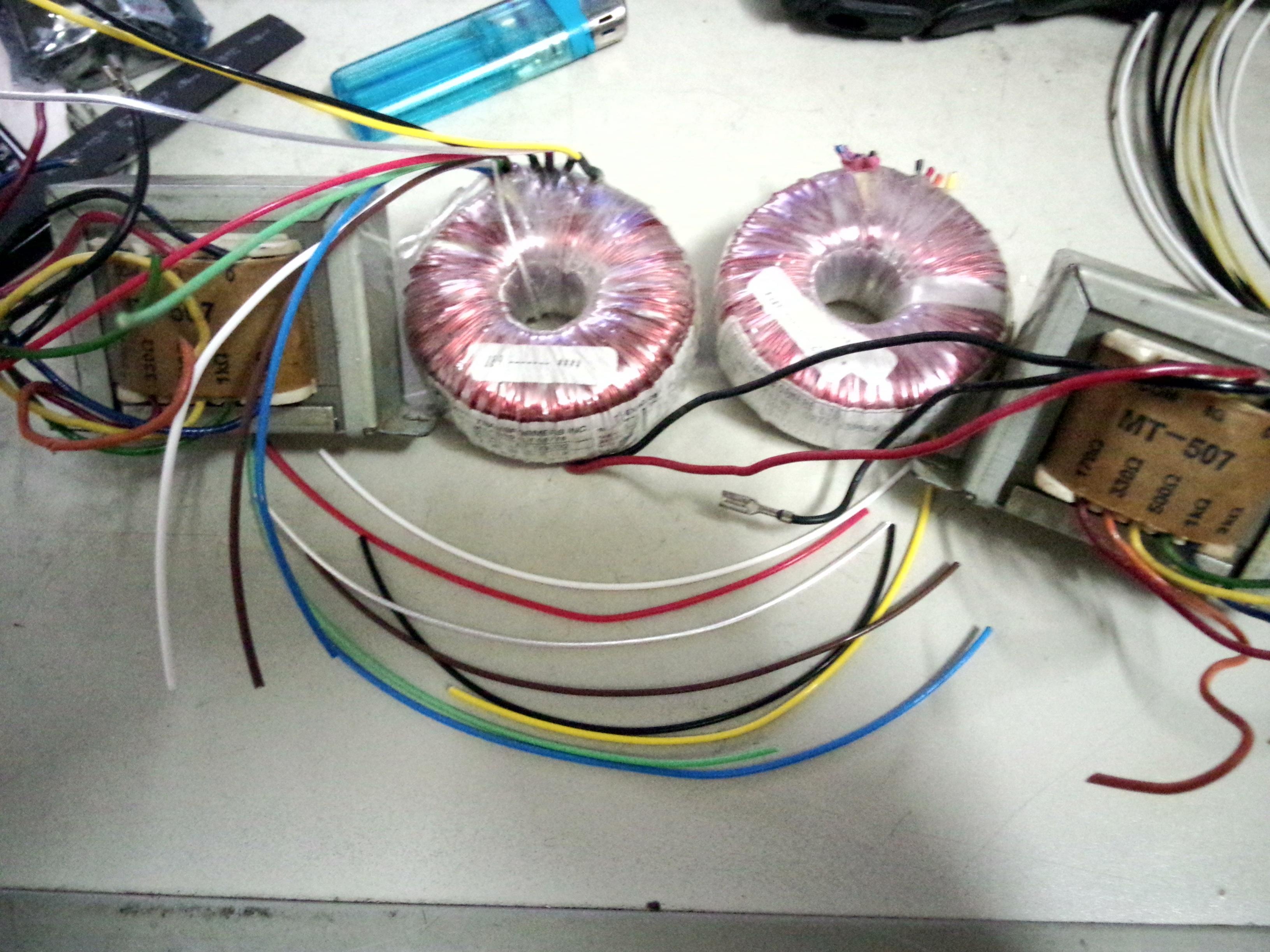

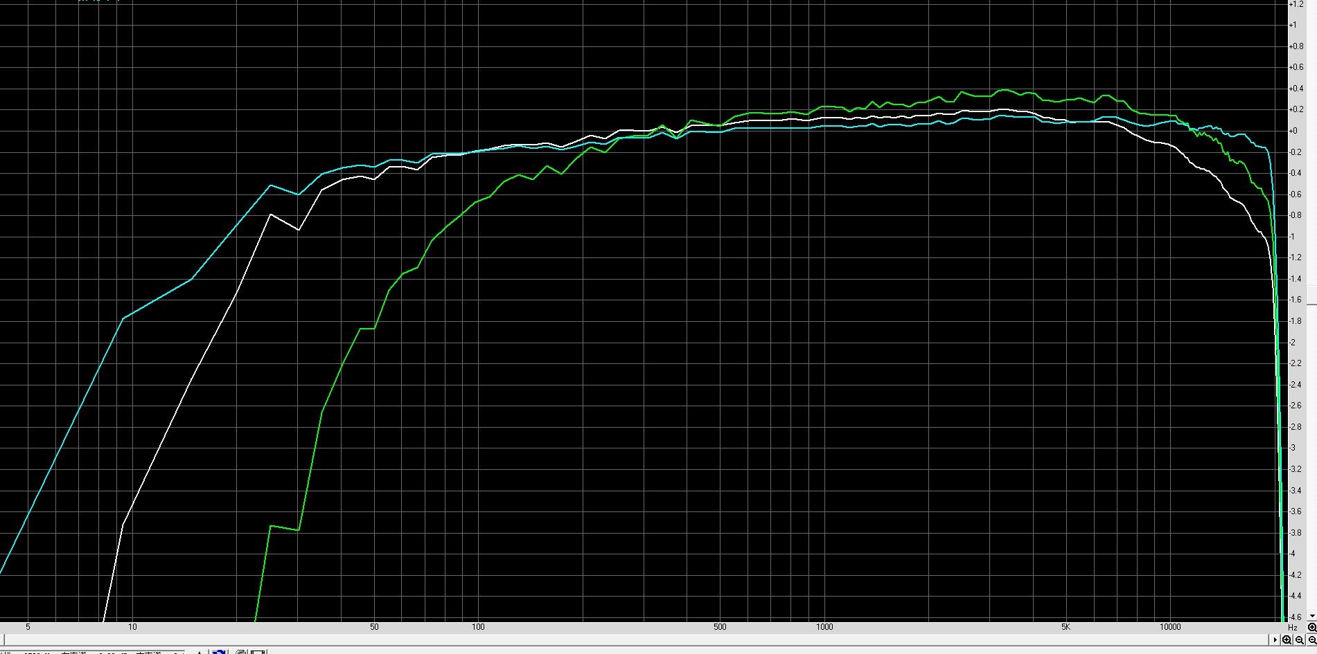

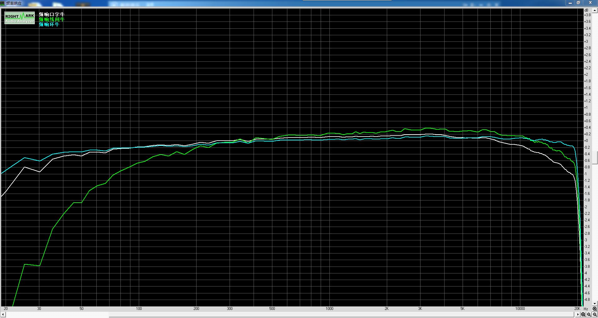

For testing 3 types of "output" Transformers,
A: the square power transformer, 115V+115V:12V+12V, sub in parallel, equivalent impedance 2,939:8 Ohms.
B:EI line transformer, 0,170,330,500,1K,2K:8 ohms, 0,500,2K:8 Ohms.
C: toroidal power transformer, 120V+120V:12V+12V, sub in parallel, equivalent impedance 3,200:8 Ohms.
Test load was 50 Watt 8 Ohm resistor.
Frequency response test results in 3 colors, respectively.
Interested people to guess the color is kind of transformer. The answers in a few days.

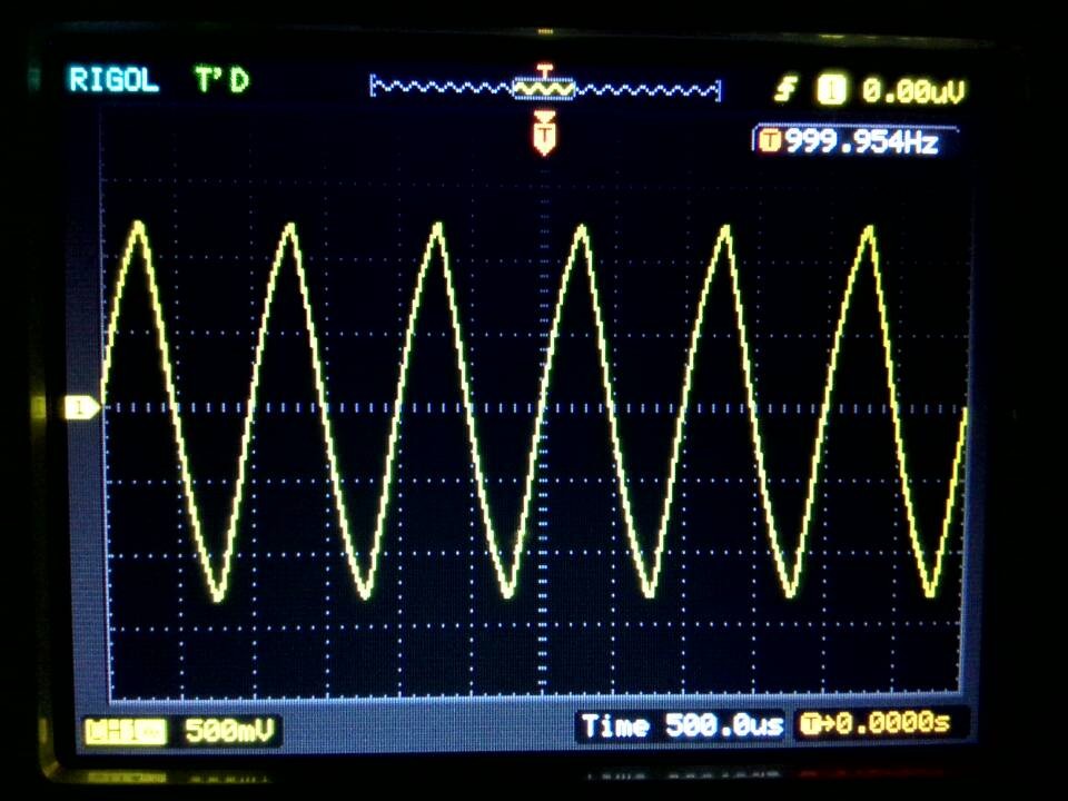

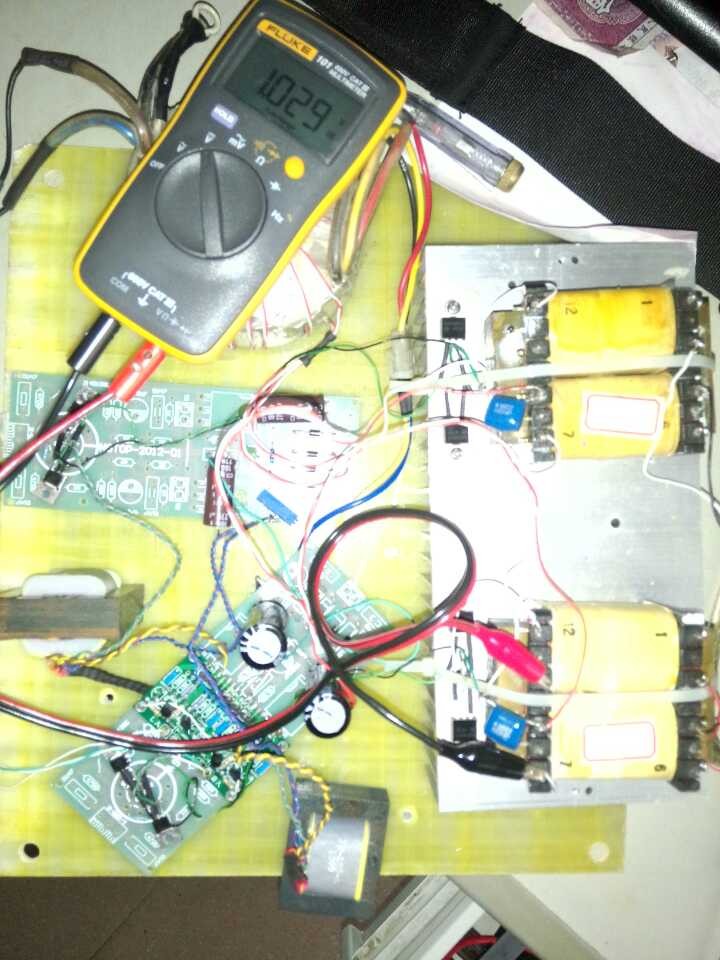

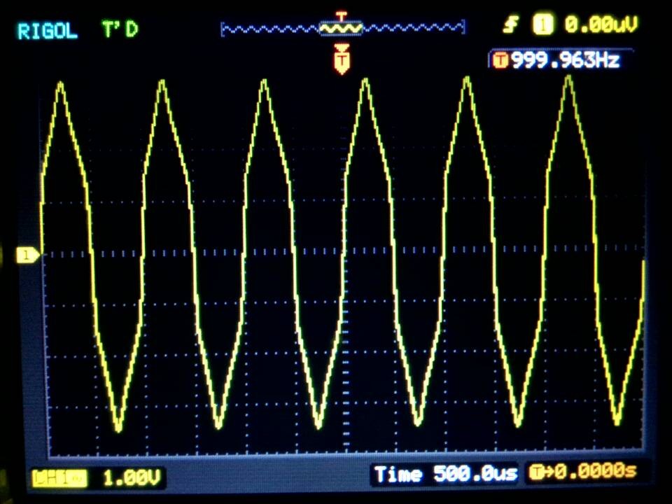

Actual measurement waveform distortion, in order to be able clear distortion, using a triangle wave, maximum distortion voltage of 1V.

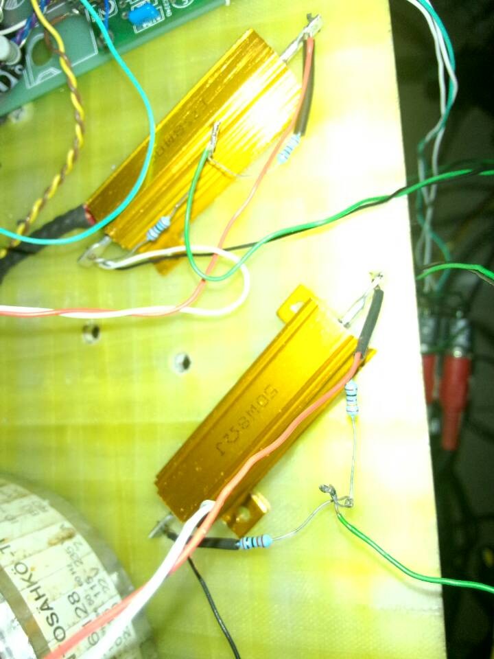

Finally check out the problem is that the source resistor bias.
