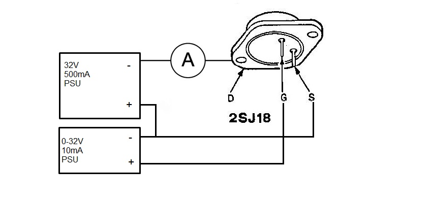

I have a 2x32V Thurlby Thandar powersupply (very good PSU, can recommend)
I set the two outputs in series and the one over drain and source to 32V 500mA
Then I measured voltage drop at VGS=0 (usually around half a volt)
Then the IDS=0 voltage, usually around 10V for good devices, 20V for chinese ones 🙂
Then IDS 40mA (just a value I thought about using for some reason) This was usually like a volt lower than the previous value.

I do have some schematics but what I want is the test Jig or schematic if you have, to match Vfets with common Ranks for parallel purposes.Thanks for the link to the other thread.

Thanks.. so I can get the Idss with respect to Vgs...So about Vds will it be automatically same as 32v Psu, Am I corrrect?
I just thought it was like matching a mosfet with resistor load on the drain....
I think the VFET is quite resistive between drain and source.
Someone correct me if I am wrong?
I can also test this later.
And the factory "matching" was done at 50V 100mA I hear , so I guess we should try to keep to this.
I just don't have a 50V PSU at the moment 🙁
Also 50x0.1=5W which will heat up the VFET rather quickly.
