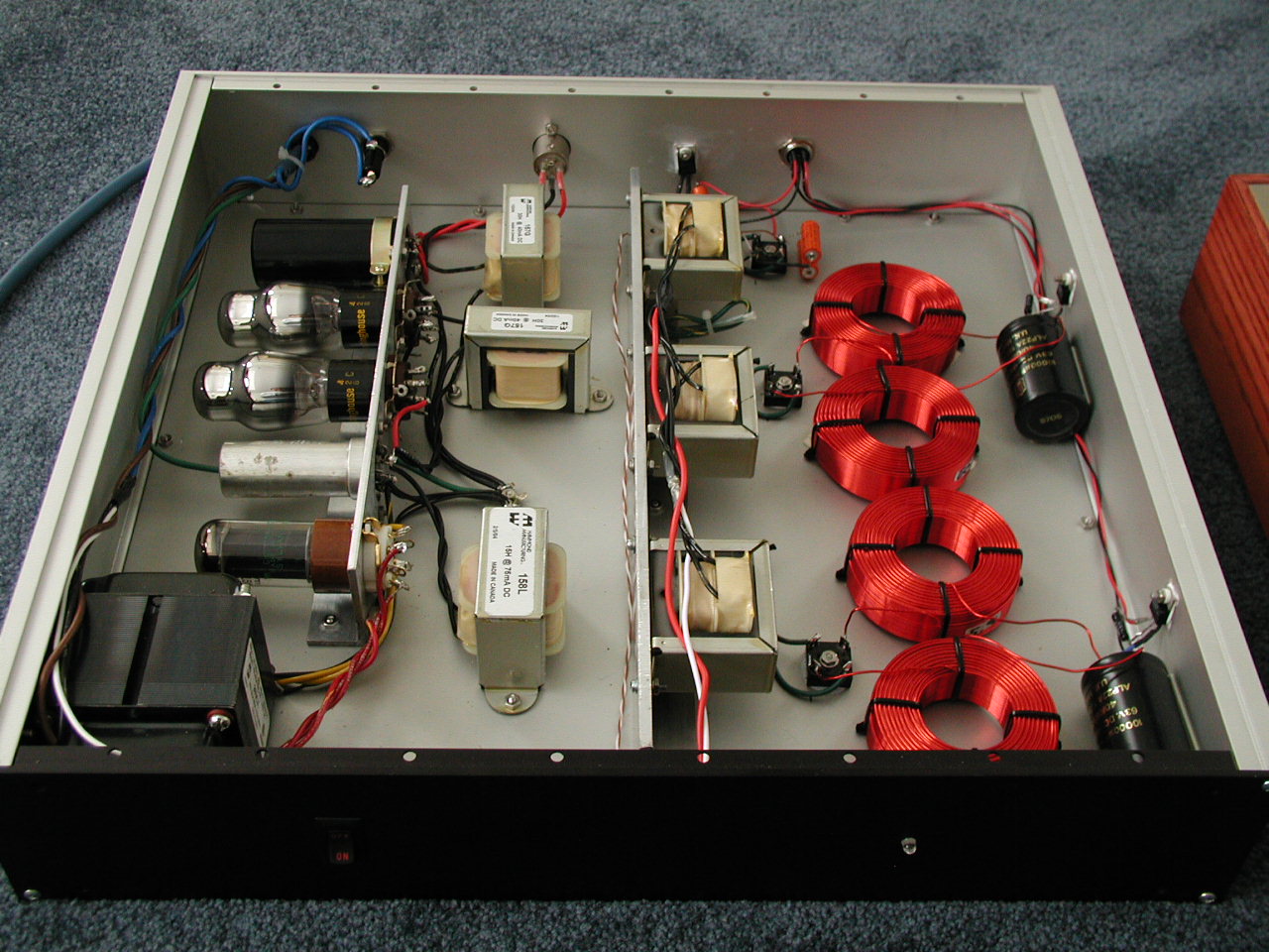

Boy, this is a little tough, mainly because I only remember that I prefered it. I tried a lot of things with that amp. I loved AC filaments but could not kill the humm. I ended up with DC filaments but put some small chokes in the filter. It sounded somewhere inbetween AC and DC. I also used battery bias on the driver tube. If I remember correctly I used the LL1660s also. I used an 80 for the rectifier. The rectifier tubes made a pretty big difference in the sound. Here are a couple of photos. If anyone out there has this amp let me know how you are liking it...

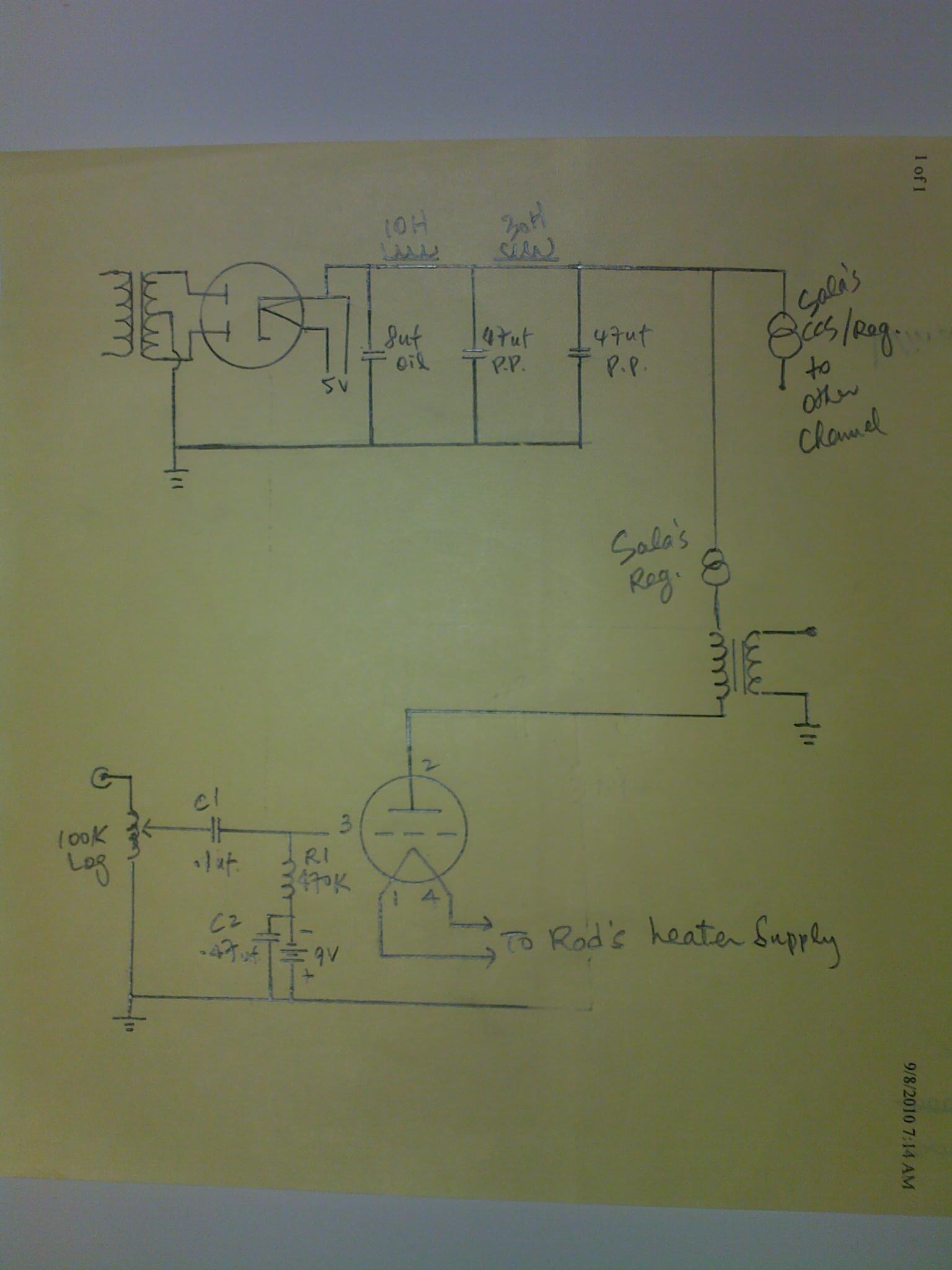

Thomas,

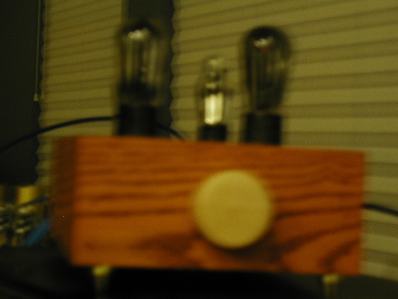

Thanks so much for your advice and encouragement. What happen is I had my 26 built some year ago and since it hummed so loud that I had to put it aside without touch it. I finished my 26 pre with VT-52 design and you could see the attachment for the pics. Since I'm old and don't know electronics too much but very much love listening to music. I don't want to break my bank for the system and therefore I start my diy journey. I really would love to make a good system for myself and I again started some years ago to copy directly from those designs that I could found at the forum.
Back to the topic. My power amp is with 100K input impedance, all my interconnects are within 1 meter in length and I only have CD as source.
Please do check the attachment for the schematic which is partly copy from Kevin's design with battery bias. Tell me if it'd work or anything I could do it better.
Hi!
The schematic does not show a connection from the 26 filament to ground. One side needs to be grounded. I'm not familiar with the Salas reg. I assume it is not just a CCS as indicated in the schematic. ust a CCS would not work. If it has low output impedance the reg should work, but then there must be some reference to ground from the reg as well.
If the above is done it should work. It could be done much better IMHO, but that would require some expense. I'd get it to work like this and if you want to modifiy it afterwards, you can ask again.

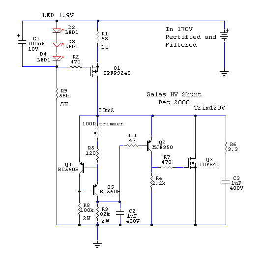

Thomas,
Please check attached for Sala's reg. I'd try to show Rod's heater supply later.
Albert
