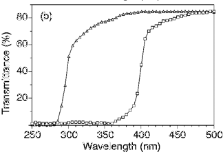

I found this light absorbtion spectrum comparing glass and lexan in a scientific paper that is online. It is a microbiology paper, but they did actually put the lexan and glass into a spectorphotometer to measure the light transmission. The glass line is on the left, lexan line is on the right.
The wavelength of violet light is from 380 to 435 nm. Blue goes from 435 to 500. Everything below 380 is ultraviolet. The graph shows the lexan transmitting almost all of the blue light, cutting out some of the violet light, and reaching total opacity by 360 nm. So it is a very good UV filter with high transmission of visible red, green, and blue that we need, and also has excellant optical clarity. (They make eyeglasses and other lenses from it.)
