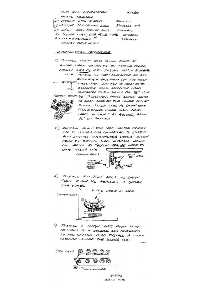

The mod is a documented internal ARC process. See attached document. The procedure is to attach a 1000 pF ceramic disc capacitor around each wire where it meets the pin, with shielding applied to the lead to prevent shorts. You are correct that it is tricky to accomplish, but it is possible.
I had actual accomplished this mod before I got myself in trouble. I had bad radio frequency signals coming through the umbilical. Four ferrite bands was sufficient to eliminate it, but I wanted something integrated. My first attempt, while messy, and with a few broken cap leads, worked great, it completely eliminated the RF signal intrusion. However, I wanted to redo it to fix the broken cap leads, and to overall clean things up. It was when I completed the "redo" that I had the trouble.

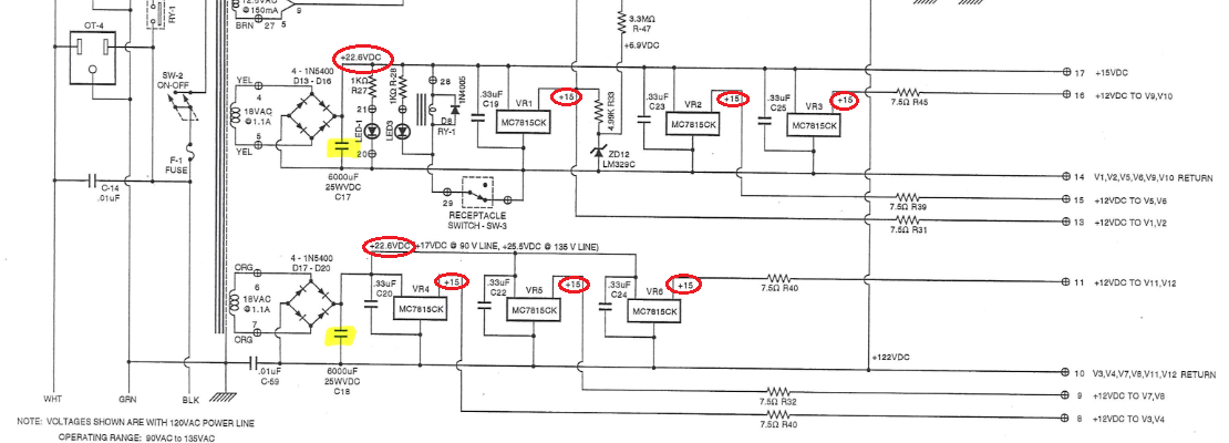

My fear is that I have damaged the wire-to-pin connections, created shorts, or both. I do have the correct tool to remove the pins, and I am taking pains to ensure they are locking in place. Having redone this mod twice, and now having redone the plug several times in my debugging, the wires and pin connections are getting stressed. I've ordered a complete set of replacement pins which I will install as needed to correct this issue.
I've traced continuity over every wire back to the regulator. There is continuity on every one. I am a bit confused on how to check for shorts. Some of the wires seem to have continuity to other filament wires naturally through the common lead? If I connect my meter between two adjacent pins, and I see continuity, how do I know if its normal continuity, or a short?
I don't believe I've killed any of the regulators. I've tried swapping filament connections around, and regulators that had been producing no volts will produce volts with the different connection. This leads me to believe I have a common return problem (no volts meaning the common wire isn't getting back to the power supply).
I just tested the filament regulators with no umbilical connected. One set of three produced ~14.5v to its return, the other set produce 0v, 0v, ~3.9v. That would seem to indicate I killed one bank of regulators. What would be the process to test this theory? Remove the transistors and test? If I did fry them, would the transistor be the thing that fried, or would I need to back-trace further up the circuit?

In the first post you said resistors. That's quite useless to drain RF. Now you say it's caps, that's a totally different game.
From your posted manual page it looks like connecting caps from each lead to ground.

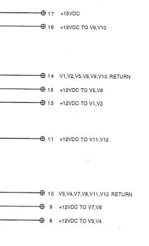

I can do that. Is it possible that two filament wires would register a low resistance because their returns both connect to the same pad?
Measure the voltages without umbilical connected.I just tested the filament regulators with no umbilical connected. One set of three produced ~14.5v to its return, the other set produce 0v, 0v, ~3.9v. That would seem to indicate I killed one bank of regulators. What would be the process to test this theory? Remove the transistors and test? If I did fry them, would the transistor be the thing that fried, or would I need to back-trace further up the circuit?
If you get input voltage of 22.5V but no output voltage of 15V, it mean that regulator IC (not a transistor) is damaged.
To make sure all filament connections are in the correct position, my suggestion is remove all tubes, connect the
umbilical cable and measure continuity from tube socket filament pin to the PSU pads, and also make sure that tube filament is return to the same regulator band.
For example, if V1 one filament pin is connected to pad #13, the other filament pin must be connected to pad #14, and so on...

Your choice but I would forget the added capacitor Mod, Factory itself called it "tricky" and they are assembling those preamps all they long.

PS: and if you insist on the capacitors, do not add them at the connector or cable but follow preamp internal wiring and add them at the board itself.
All those wires lead "somewhere". 😎

Each of the 3 regulators is "in parallel" with each other, so they aren't likely to be the problem if all 3 put out 0 VDC.
Check the INPUT DC voltage to the regulators instead. Maybe a rectifier diode is open or the input filter cap is shorted?
