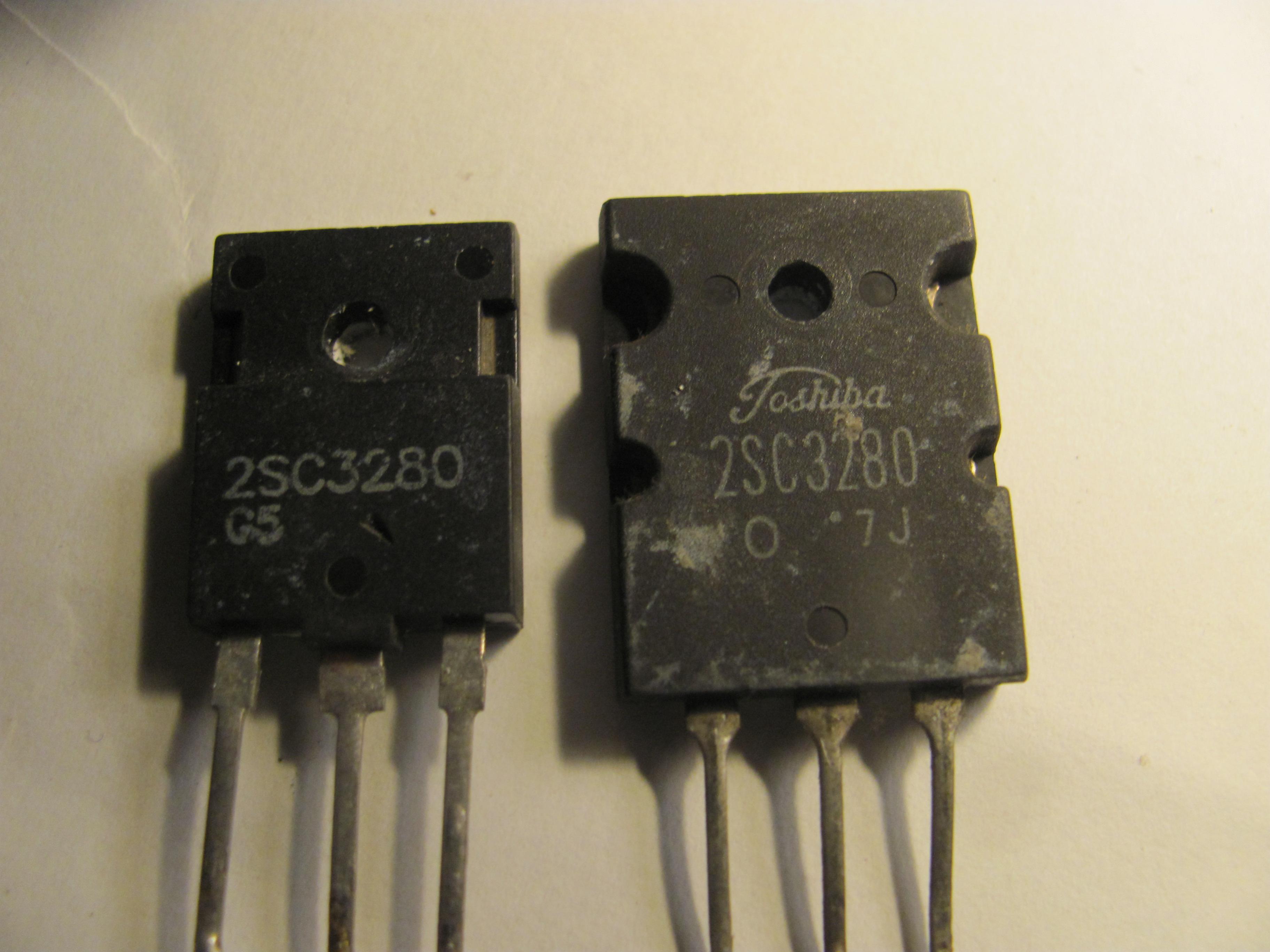

Once i got this 2SC3280 !!! I returned them to the supplier and kept this one as a souvenir ...

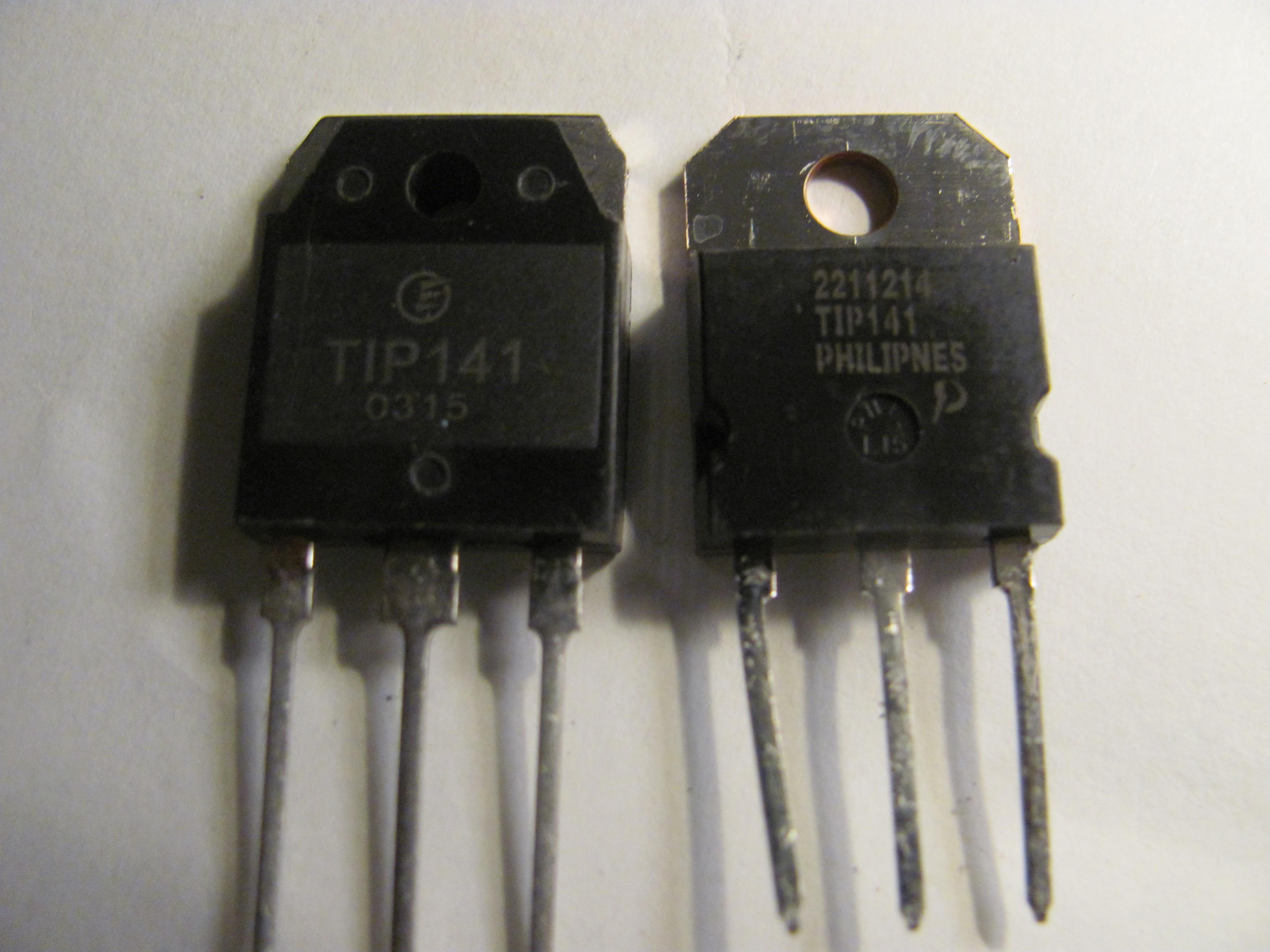

And this TIP141 in the left is also a chinese Fake,but it looks a nice fake compared with the 2SC3280...

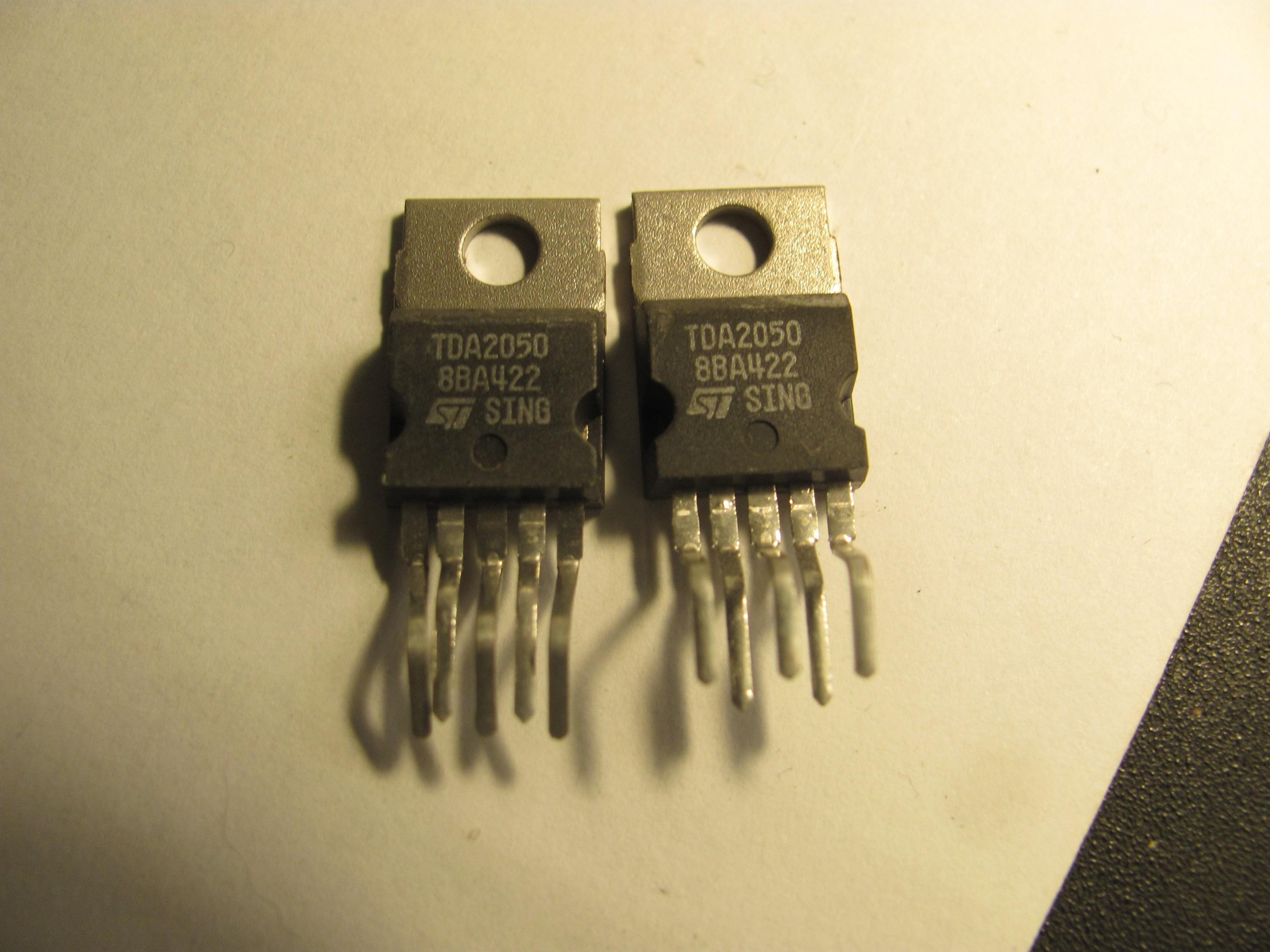

And this TDA2050 are real ones, i bought many years ago...
