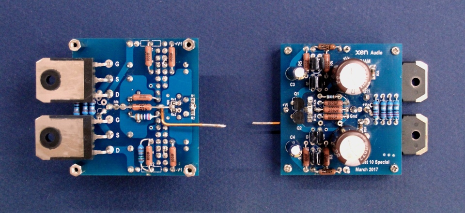

On the PCB there are a number of locations requiring jumpers.
These are required to enable flexibility on circuit configurations.
They are show here in red.
One can use 0805 0R SMD resistors as jumpers.
Or one can simply use the leads of the transistors and bend them over as required.
Patrick

Very nice. I have a few questions...
1. Are the gate-drain jumpers on Q3 and Q5 drawn incorrectly on the schematic in post two? They are gate-drain connections to Q4 and Q6 in the Spice file.
2. What do you suggest for trimming offset? Looks like a combination of R8, R21+R22, and R31 is used?
3. Any reason for MOSFET current mirrors over BJT?
I would very much assume so, at least that's the usual method of stacking current mirrors (for high impedance on both legs).1. Are the gate-drain jumpers on Q3 and Q5 drawn incorrectly on the schematic in post two? They are gate-drain connections to Q4 and Q6 in the Spice file.
NO. See Fig. 1 of Reference 6.
https://www.researchgate.net/publication/3975456_Noise_performance_of_classical_current_mirrors
You can also see from the photo that the PCB proto is built this way.
But it works both ways, as described in Ref. 6.
R6/R8 without output stage, then R21/R22 with output stage.
R31 is for Yfs mismatch, as described in article.
Less distortion.
If you believe in Spice.
Patrick
Less distortion.
Patrick

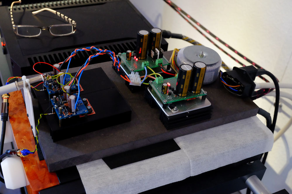

I did in fact have the opportunity to audition the UTHAiM headphone amplifier as recently hatched
by Patrick. I am always all ears when there is a new concept of a headphone amplifier to try out,
so I "quickly" built a pair of them on the boards I got from Patrick, and he also borrowed me a
version he built sporting global feedback.
Both were quickly rigged up on a breadboard and powered by a pair of the cap multiplier psu's I
initially used for the F5 HA, with a quick change to output the suggested +/- 24V.
My first impression was that both versions sound almost like power amps... with power in abundance,
a full tonality and with very good control over the entire spectrum. When you like deep and hard bass,
look no further. 😉 Mids and Highs do sound like a good ZGF amplifier... natural with a total absence
of harshness or other artifacts that I remember from my first forays into solid state territory
(long before I built the DAO or F5 HA).
Switching over to the version with feedback (using the same psu) I initially was surprised that it sounded
quite the same, but concentrated listening to well known tracks revealed that there are differences.
To my ears, and in my subjective perception, everything sounds a bit harder, the tonality of instruments
gets shifted slightly, and bass precision is now bordering brutality.
I, personally, prefer listening to the UTAiM with zero global feedback as it is more natural sounding.
You pick your poison.

Thanks for the independent audition.
As said in the title, this is about having fun, trying out configurations, and hearing how they differ.
Patrick
Patrick
