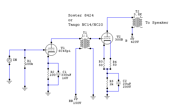

I need help 😕
I have pair of UTC A16 plate to grid transformers (15k:60K) and I want to use in this schematic as interstage transformer.
Is it possible?
