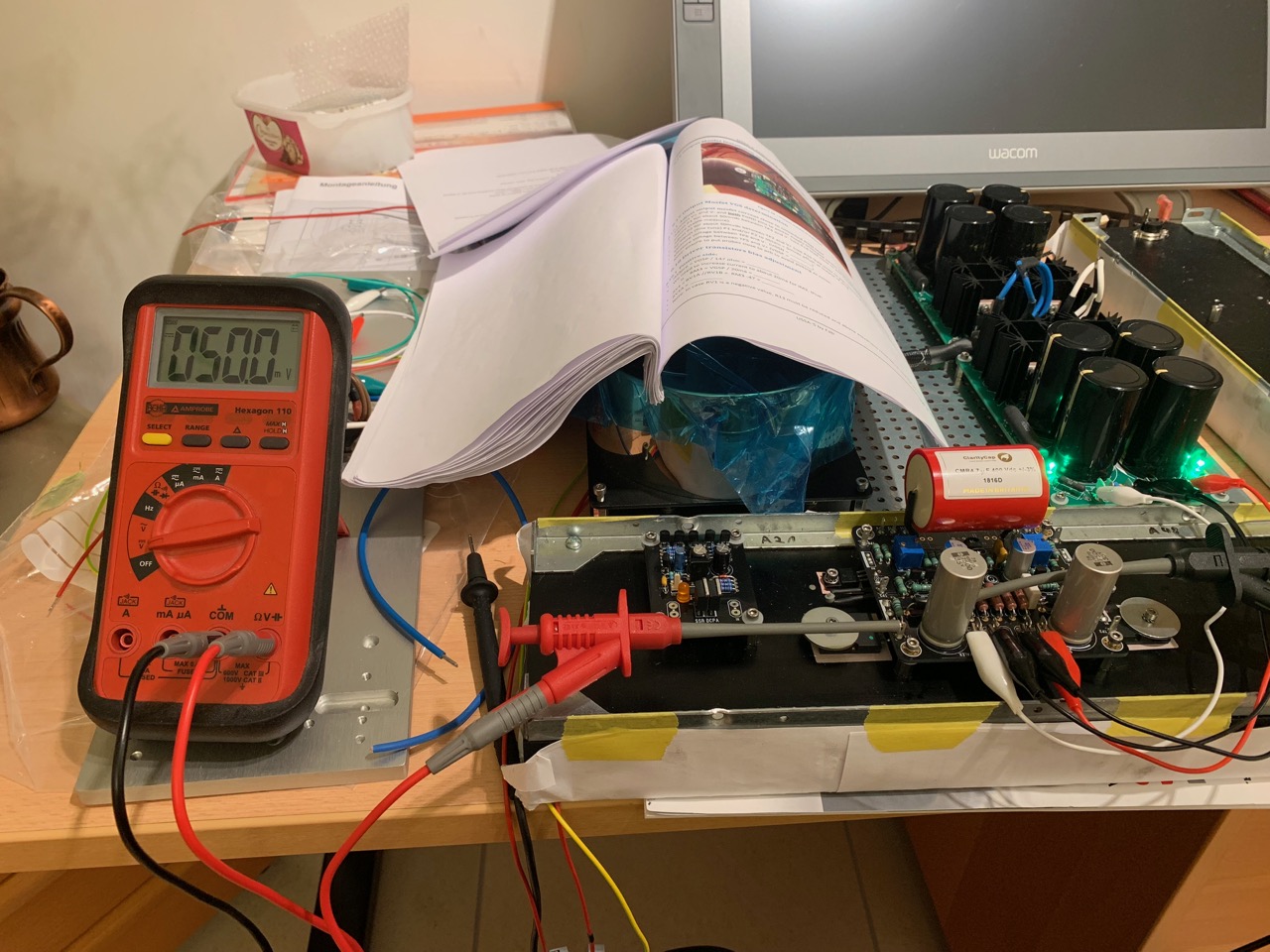

Here are a few impressions from my building progress:

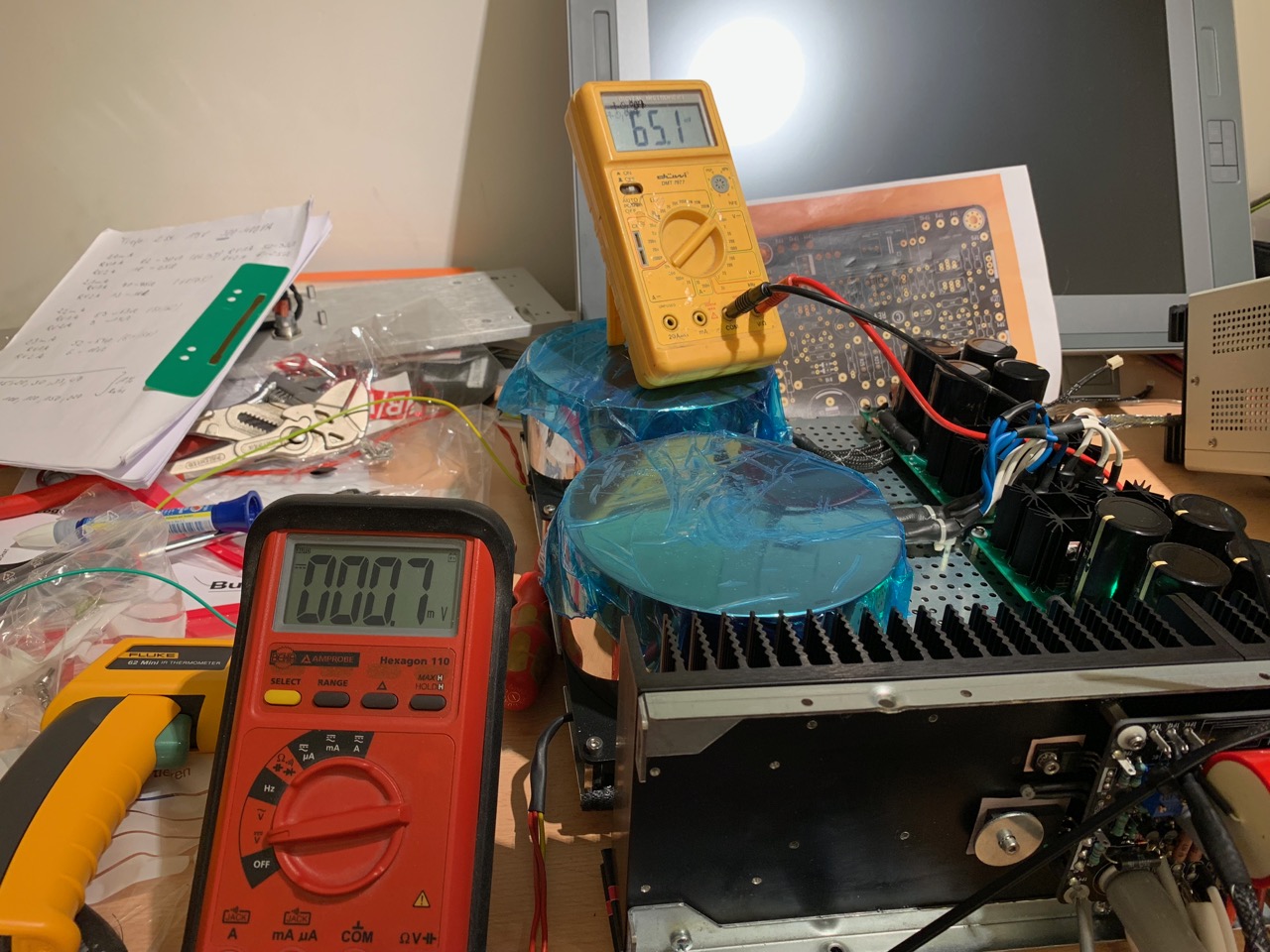

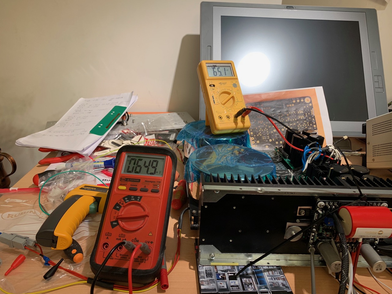

First biasing, always with Fabs instructions infront of me to avoid mistakes :rolleyes:
Biasing the positive and negative side to the final bias of 1,3 A
Always switching between biasing and controlling the offset.
I urgently need a third multimeter, switching them makes me crazy.
Turning a potentiometer and looking after the bias then switching the multimeters and controlling the offset, oooh it was the wrong direction or potentiometer then switching the multimeters back and so on ....:(

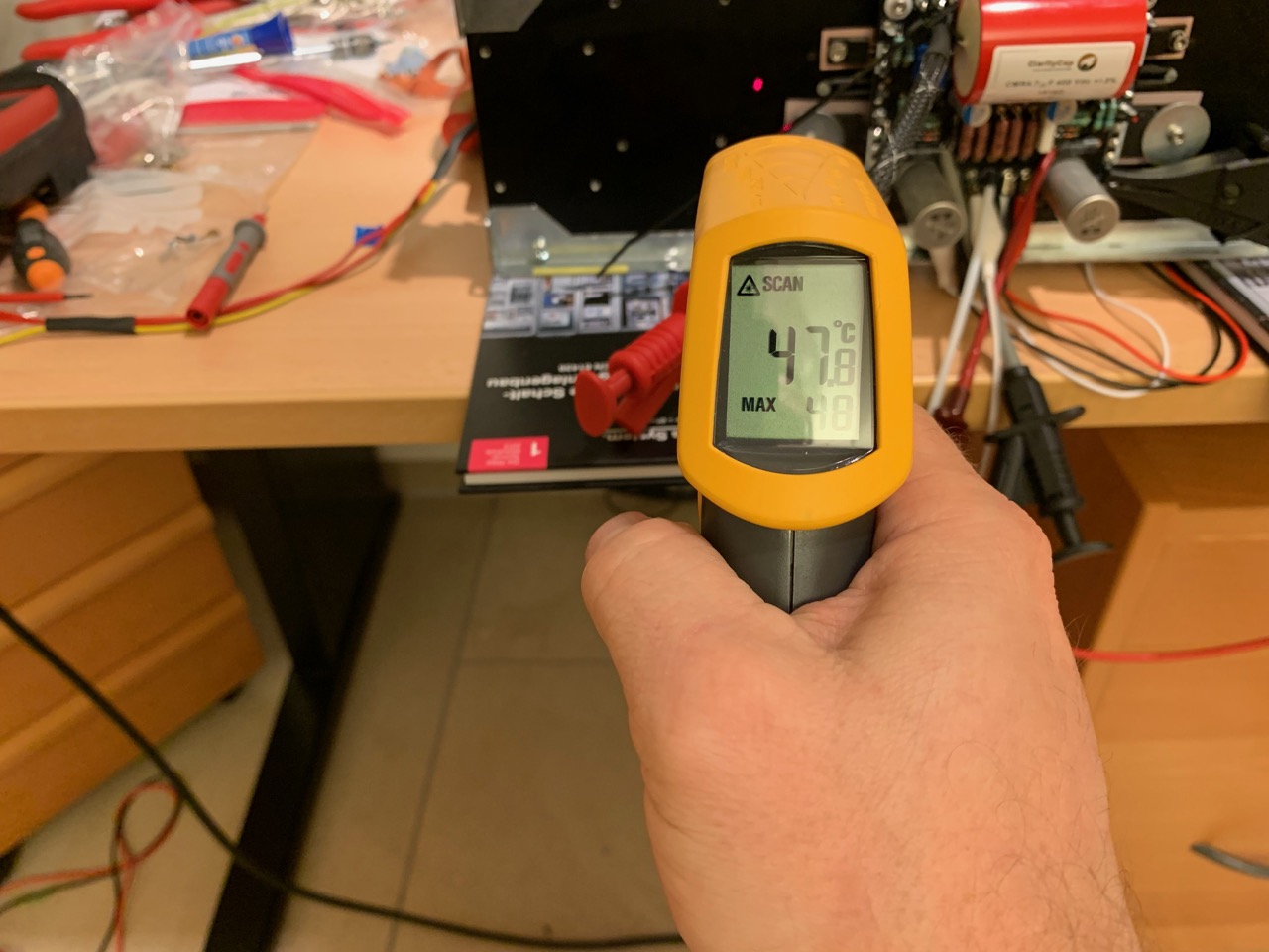

After all take a look after the heat. Fab is right, it is close below 50° C with 1,3 A bias.
Thats is a lot but not to much. My "old" amplifier is nearly the same.

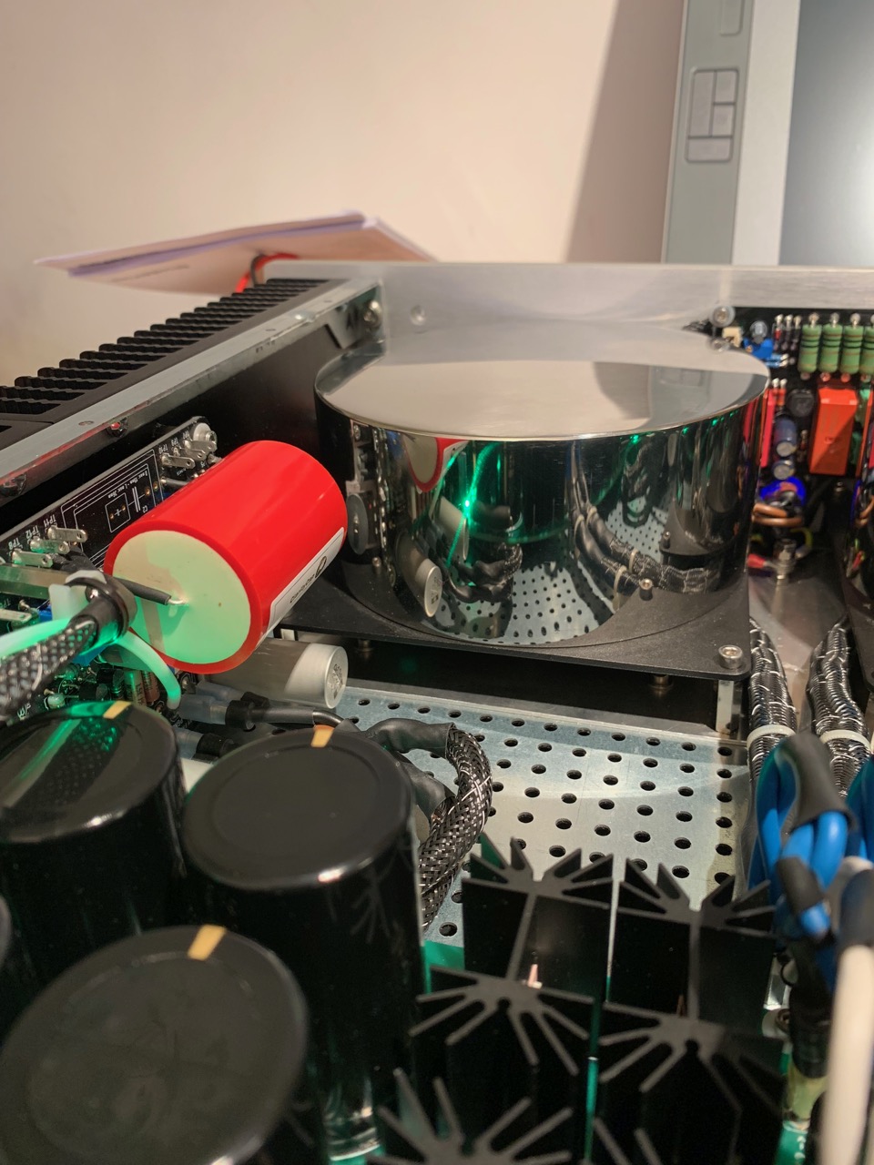

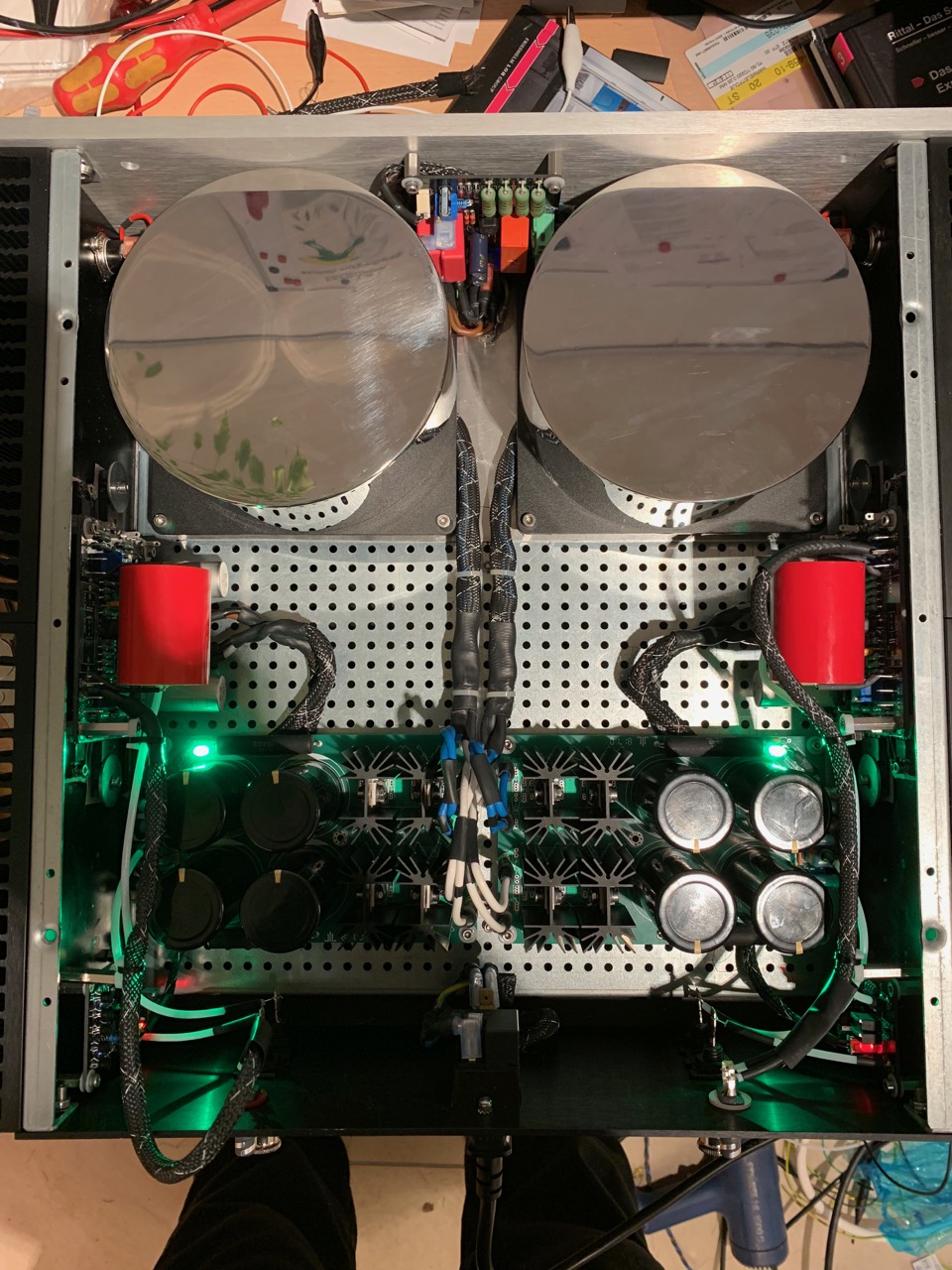

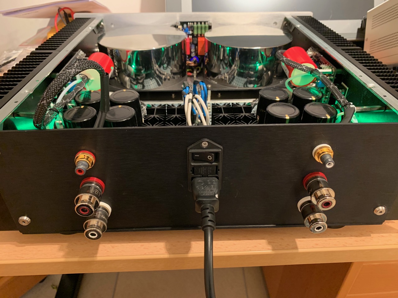

Some impressions from the inside.
Nice lights from the leds. Especially in the night, the power switch light is blue, the leds from the power supply are bright green and the leds from the loudspeaker protection are dark orange. So you have all informations about the status of the amp you need. ;)
And at the moment the amp stands free, to control if everything works correctly, so I have a free "disco light" on the ceiling of our living room.
For my wife the amp or music is not as important as for me, but she likes the LIGHT!!! :D

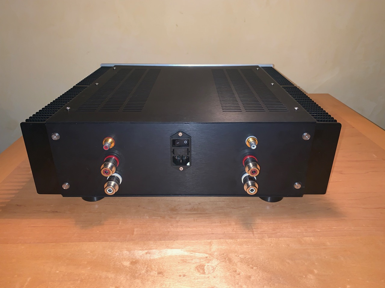

And from the outside:

Thanks for your report and pictures. I can say your build is impressive ( parts quality, wiring,....). I wish mine would be like that...:rolleyes:

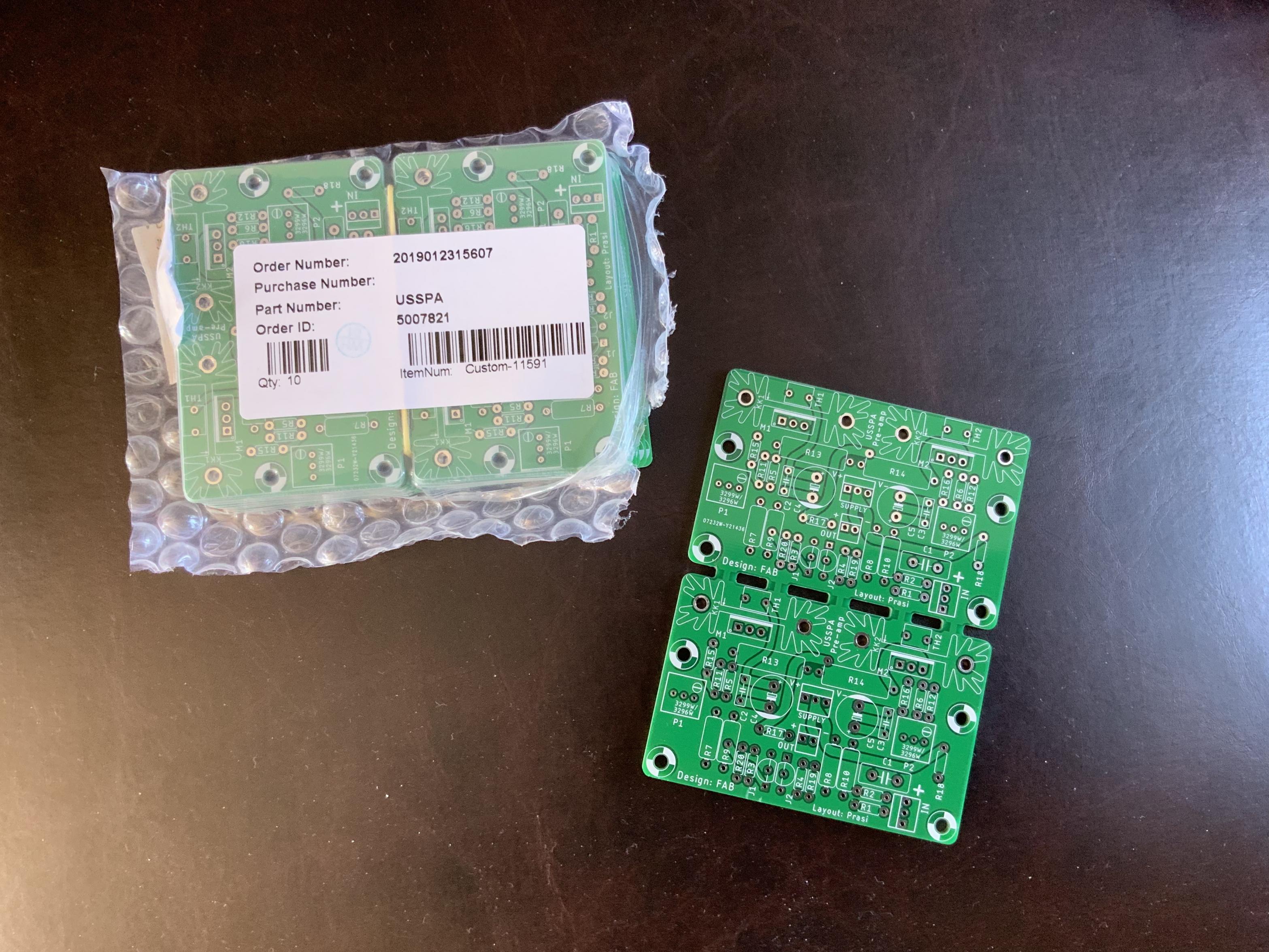

As for your preamp project, I received my small batch yesterday of USSPA PCB so yours is secured -if you want to try it. I will send you a message for the details if you choose to build it.

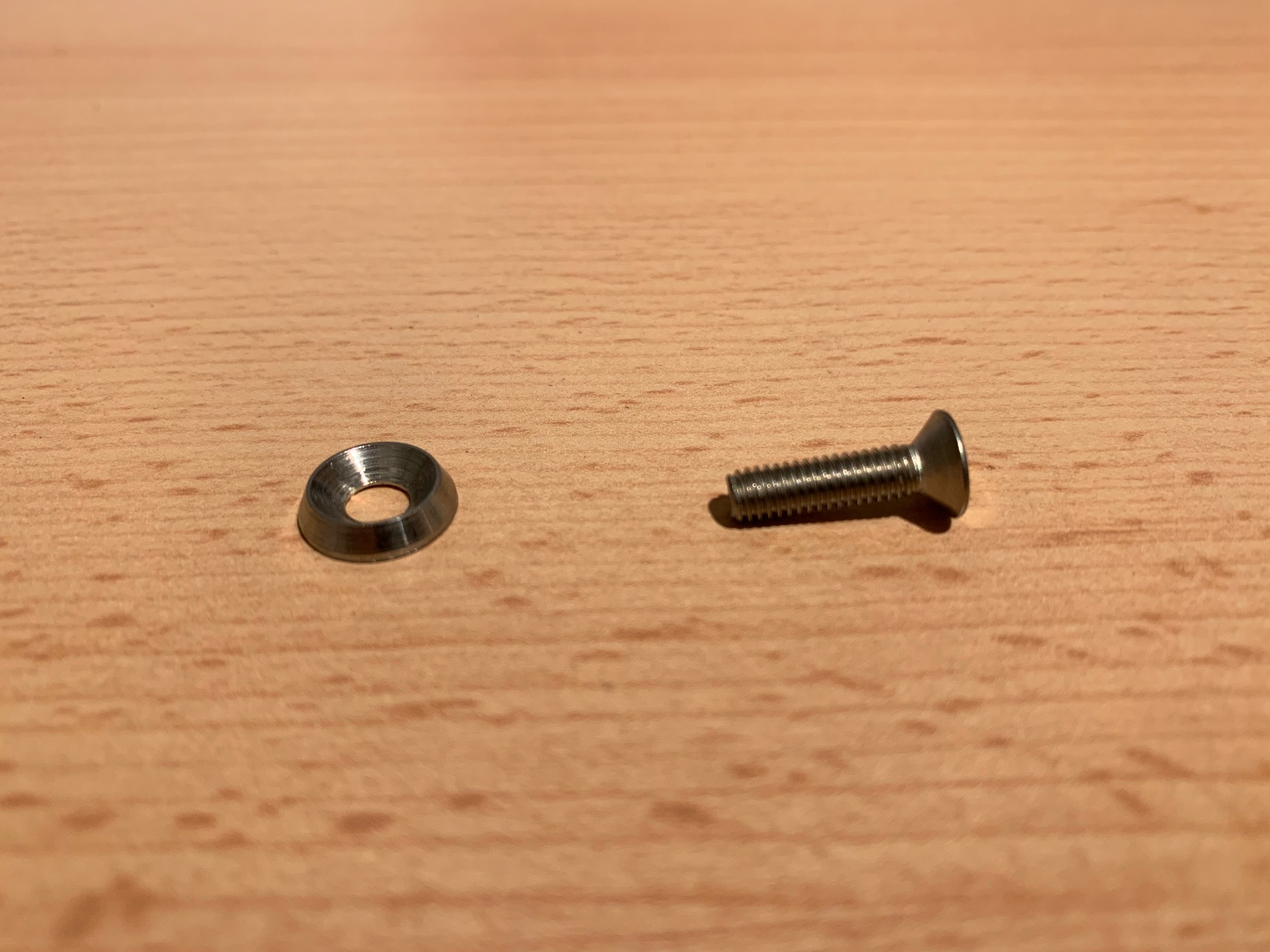

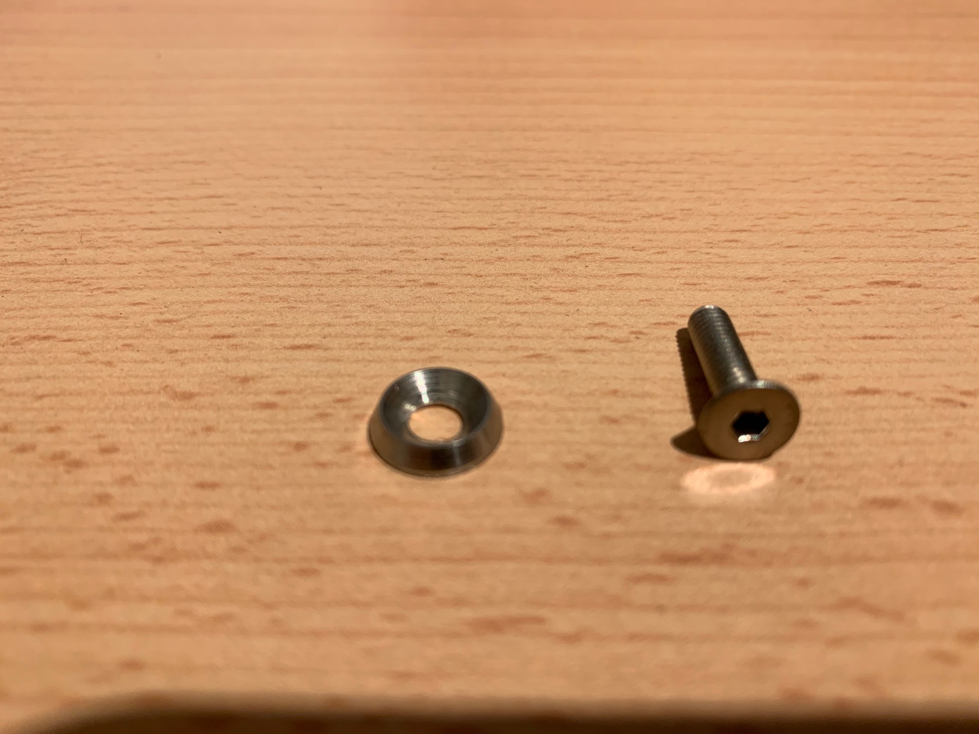

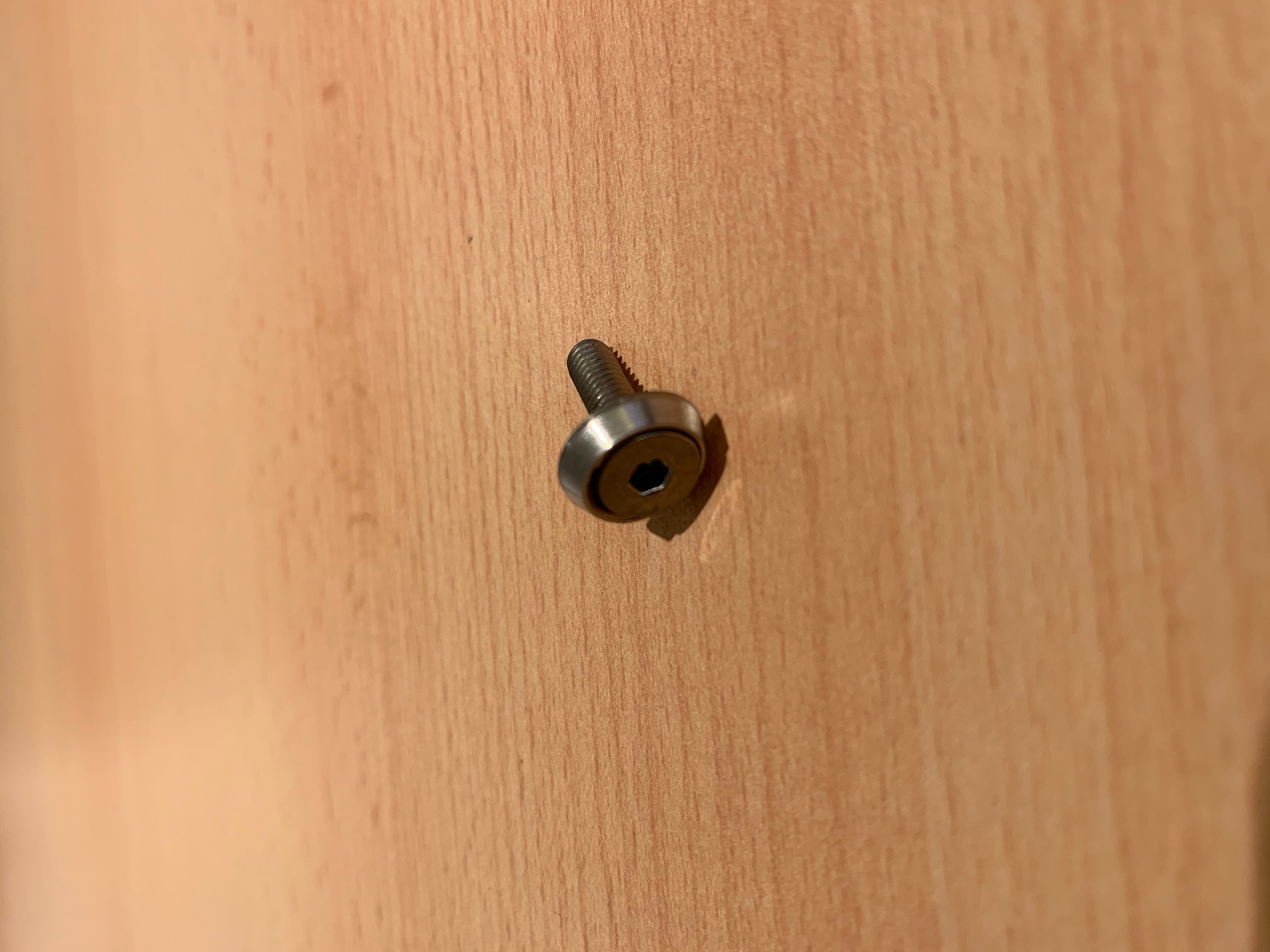

tomtest,
Nice compact work! :cheers: Is that a 3U/400 chassis? Also, can you share what types of decorative screws you used for the back panel? They look very nice.
Thanks,
Anand.
Hello Anand,
thank you for your response. Yes it is a 3U/400 case, after all I wished it was a little bit bigger to separate all things even more. But at the end all fits in. ;)
Yes you have good eyes, I did not like the original screws, the look to cheap to my taste. So I looked around and the best things I could find are these stainless steel countersunk screws M4x14 mm with a washer to fit it for normal use (I hope these are the correct English words). :confused:
Inside with a nut and spring washer to hold it correctly.
Have a look at the attached pictures.
If you have more questions feel free ask me.
Bye
André

You also indicated to me a long time ago your possible intention to mount the USSPA so you will be first to obtain your pcb. Since there was no manual, I have started a preliminary one so I will continue to work on it...since the circuit is really simple it will be a very easy assembly and you know now how to adjust bias and dc offset with 2 pots....:p
Also, the pcb is able to receive both USSPA1 and 2 versions.
You will get email!
