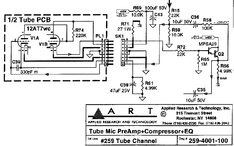

I've read lots of praise for the "tube" part of the Tube MP/C, but my own ears tell me something else; I hear no audible distortion until I turn up the levels to the point where there is a fairly sudden onset of clipping, and when that does occur, I don't like the sound of it at all, not even for guitar or bass, never mind vocals....And sounded better!!
Fortunately, if I turn down the signal level into the tube several decibels below that point, I don't hear any unwanted artifacts. The manual specifies "THD < 0.1% @ 1 kHz" with no other details, which would certainly be inaudible.
To me, the low THD and abrupt onset of audible distortion both suggest the use of a good dose of negative feedback around the tube stage; so there's too little THD to hear until outright clipping occurs, and when it does occur, it's abrupt.
To me, the tube in this doohickey is not a useful feature, but it also doesn't detract from the utility of this very handy little box.

I wonder what voltage the 12AX7 is operated at? The power supply is only 9V, but there is (genuine) 48V phantom power available even in the entry-level Tube MP/C, so it would not have been too hard for the designers to choose to run the tube at 48 volts....tube...taking it out cleans-up the sound...
