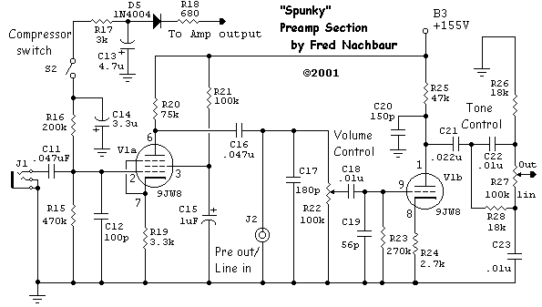

Ok so I was reading a little bit about the vari mu principle and an idea popped into my head.
For bass guitar, most players want a little bit of compression (using a pedal/effect or by driving it close to saturation).
So wouldn't it be possible to use the vari-mu principle in the amplifier.
The 12AT7 has been used in some vari mu compressors.
It is also used a lot as the LTP phase splitter in guitar amplifiers.
So if you change the current in the tube the gain changes.
So wouldn't it be possible to do this on the ltp phase splitter?
It needs to be balanced, otherwise there will be some feedtrough of the control signal.
Only problem would be that it shouldn't have to much voltage swing as this will result in distortion.
Could be solved using a gain stage after the LTP phase splitter I think
The control voltage can be made from rectifying the signal at the output transformer.
Badly.
The driver has to deliver BIG signal to flog the power tube grids.
With your plan, when signal is big, the AGC turns-down the current, the driver can not make big signal. This is the essential limit on a tube limiter. We can make-do by only expecting a few volts out of the VCA stage. Then we need another stage to make the dozens of volts for the power bottles.

That's what I tought about the signal shouldn't be to large.
So adding gain stages after the LTP output can solve this I think.
For the tube the 6386 is a bit expensive.
I have seen the PCC85 (ECC85 with different heater?) and even the 12AT7 used for vari mu compression.
In simulation I've got around 30db of gain change just using the 12AT7 so this would be ok
A simple Vari mu Compressor is something like the altec 436 http://www.dvq.com/hifi/images/436c.pdf
The 6BC8 can be had at a normal price.
I think making the input stage into an LTP by adding a large resistor at the cathodes and tie it to a negative voltage (the bias supply for output tubes).
Adding a trimmer to one of the plate resistors to balance the LTP
Then adding gain stages after the first stage but with enough gain so the LTP shouldn't make big voltage swings.

<div class="the usual answer">
Look at Frank Nachbaur's Dogzilla. He's got a 6K7 in the input stage as the variable mu bit with control voltage from a rather complicated (he wanted it all tube) circuit before the driver
</div>
</div>
"shift bias negative". If you're going to derive a control signal from the OPT (or otherwise) why not just use it to "shift bias negative" on all the tubes that you can in the whole amp?
Build a voltage controlled fixed bias supply with multiple outputs. (I think someone has a patent on that already...) Does a tube "know" if its cathode is set above ground via a parallel RC, or any other Vsource?
The only thing I can think of is the heater to cathode voltage limits on the tubes. Be sure to look at the specs for the tube you are actually using because the specs vary dramatically from one manufacturer to another . Too much voltage difference = dissipation of the cathode coating, eventually rendering it inop. Excessive heater to cathode voltage is the main reason cathode followers burn their cathodes, not the class of service. Probly not a problem in the instant matter, but something to consider... Always.
Fred Nachbaur fed his (speaker derived) control signal back to the input pentode in his "Spunky" guitar amp design.If you're going to derive a control signal from the OPT (or otherwise) why not just use it to "shift bias negative" on all the tubes that you can in the whole amp?
