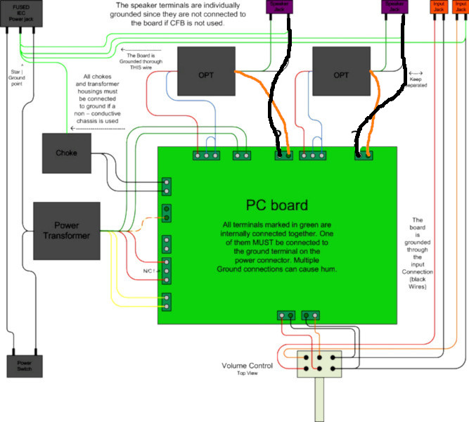

I've read that it is possible to use (for example) my 8ohm tap for speaker connection and a spare tap (I have both 4ohm and 16ohm available) for CFB. 16ohm would give me more CFB and 4ohm would give me less.
How do I wire this?
Black (0 ohm) and green (8ohm) to proper speaker terminals?
Orange (16 ohm) to CFB terminal ?
But what else gets connected to CFB terminal? Ground? To negative speaker terminal?
