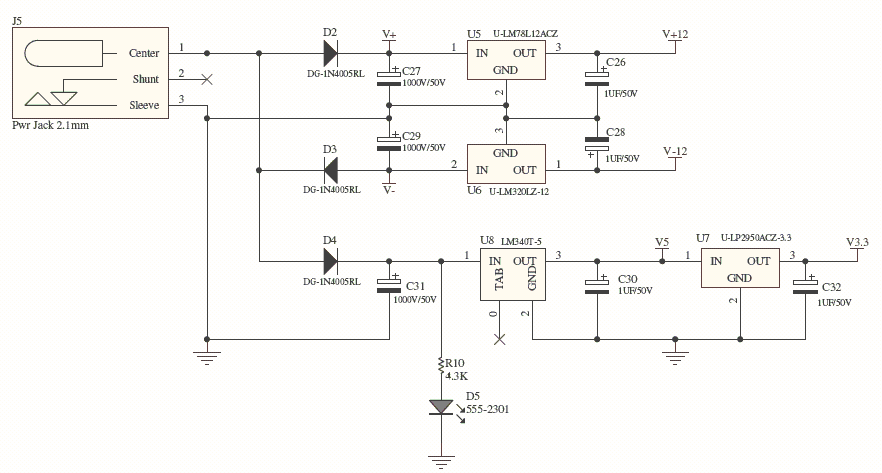

Thanks, everyone. If you want to see the schematic that I'm planning, here it is:
http://www.cellandtissue.com/ezdac/schematic.pdf
The regulation is in the lower right hand corner.

Richie, I was looking at your schematic and I have a couple of questions. 1) What is the purpose of the C1 cap, since the regulators have their own decoupling caps (C6,C7)? 2) What are R1,R2 for?
C1 snubs common-mode noise.
R1 C4 provide additional filtering, I wanted it to be a very high quality supply.
