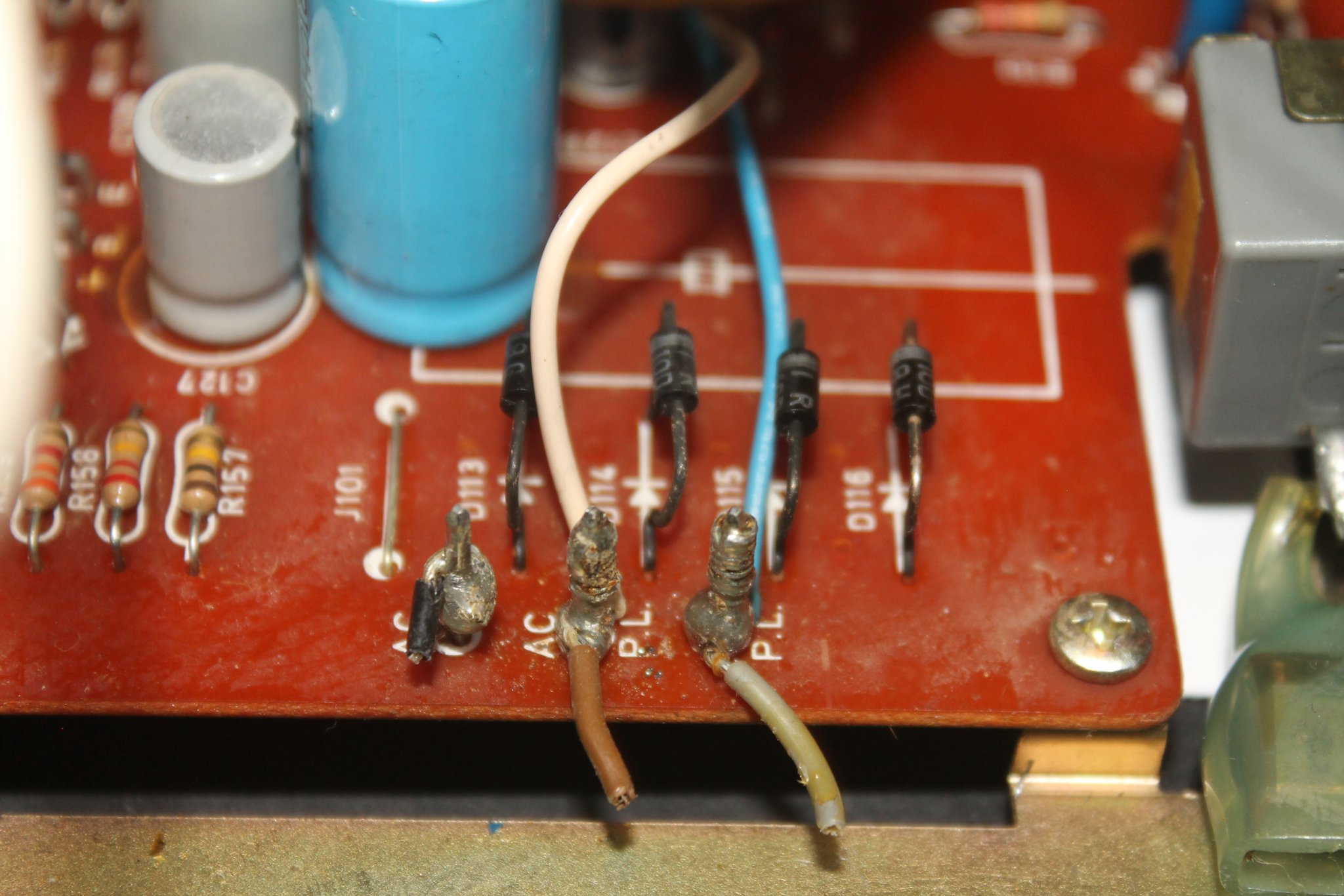

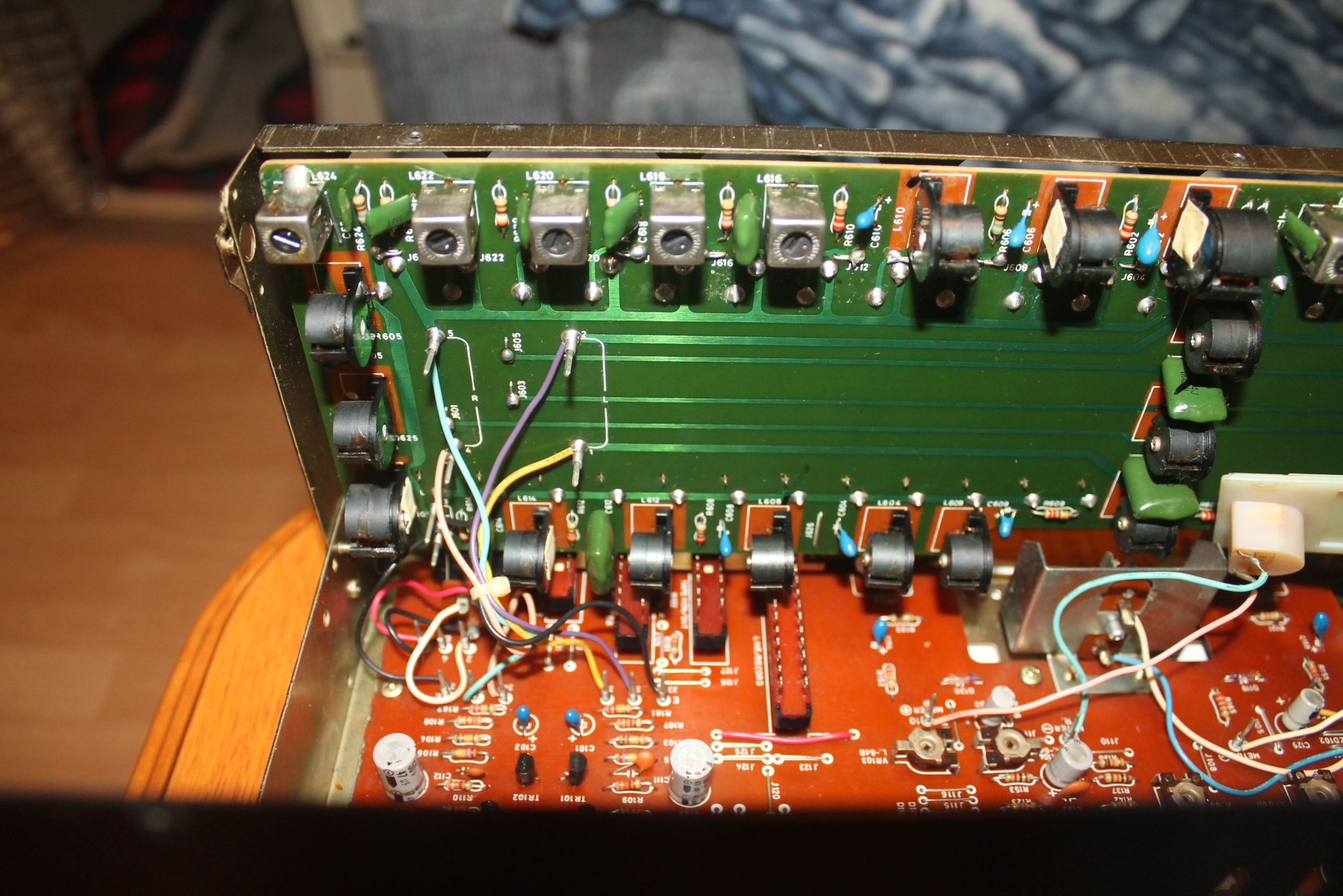

Mike,

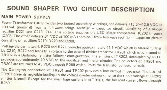

It is a very important starting point as stated above is to short those meter leads together and show reading. It is very unlikely that all are showing 0 ohms, so that is why we need to verify this first. Thanks for your patience here.
Try this from Hi-Fi Engine.
Sorry. File is too big for me to post. I found what we need at Hi-Fi Engine. Search ADC SS2 MK 1. SERVICE MANUAL and more, BUT be sure that you are getting exactly the model that is being discussed. This is causing some confusion. Not just with ADS/ADC but also which exact model it is. The models did vary circuitry.
Reactions: chrisng
Well, we are all linking to the same page "Sound Shaper Two" at Hifi Engine. I've downloaded both service manuals and neither of them listed at that location have the same paragraph the OP posted so maybe the manual we need isn't up there....
@Mark5555 I suggest it'd be helpful to get a pic of the serial plate and front panel.
