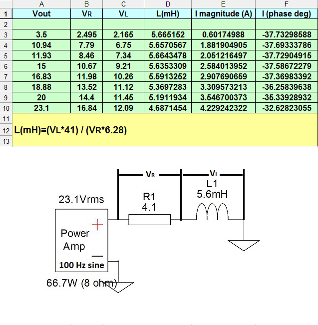

There's something that goes by the name 'complex permeability' that may be thought of as the change in permeability (mu) with respect to frequency or rather colloquially "permeability response" for a magnetic core material.
For steel, this quantity doesn't extend much above 1 kHz (typical curve here), as it was originally meant for mains frequencies (< 100Hz). Thus, using the material above 1kHz would cause a reduced (and delayed) change in the flux density (and back-emf) with respect to applied magnetising (H) field, that would, in turn, be perceived as reduced inductance and filtering performance, along with increased core losses (heat).
Audible effects may show once you have saturated core so much that it no longer has its nominal inductance, rather a smaller value depending on the saturation. So, simulate FR with different L values and you should observe the probable changes.
