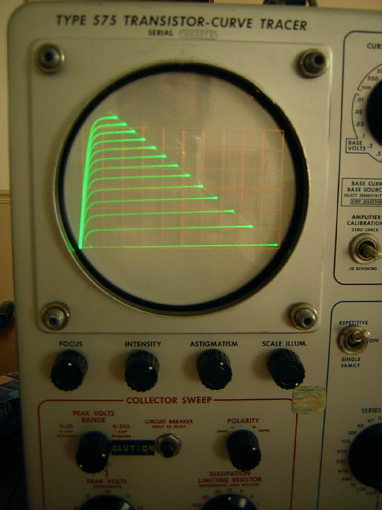

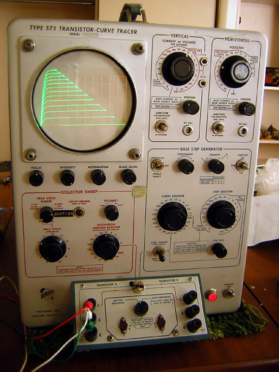

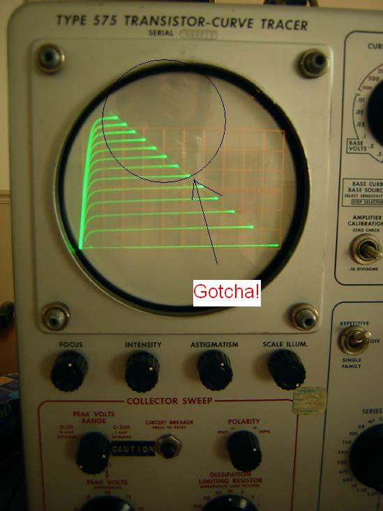

I have my recently aquired $20.00 Tektronix 575 up and running pretty well.... Has anyone on this site ever used a curve tracer.... I would like to use it for matching devices in several parameters. I am still awaiting the proper 10X10 graticule for it but I thought I'd post this and see if anyone can give any pointers about using one of these. I do have the manuals for it but its pretty easy tog et lost... and because of the 1959 date on the scope I would assume the book was surely written with testing germanium devices in mind. I know these can deal with any modern silicon device including MOSFETs and FET devices....
The display shows an MJE15033 transistor under low current test. The 575 can supply up to 200 volts and 2 amps of current for testing devices. I already truipped the front panel breaker once testing this device but it has survived my brutality.
Thanks in advance for any tips!!
Mark
There is a nice irony in using a 36 tube unit to measure transistors. I have an old Heathkit IT-1121 curve tracer which has paid for itself over the years in the occasional 'tough dog'. The Heath tracer is limited to 40 watts drive, 40V @1A or 200V @ 200mA but it's sufficient to prove the point.
G²
The TEK 575 is a wonderful unit. First used one professionally in 1966. Owned one in the 70's-90's. Finally, the master transformer failed. Still, it is a wonderful unit, but not necessarily for super matching. Actually DC meters do that better, BUT voltage breakdown, matching mosfets, and general characteristics of devices, are great in this unit. Try a tunnel diode, sometime.

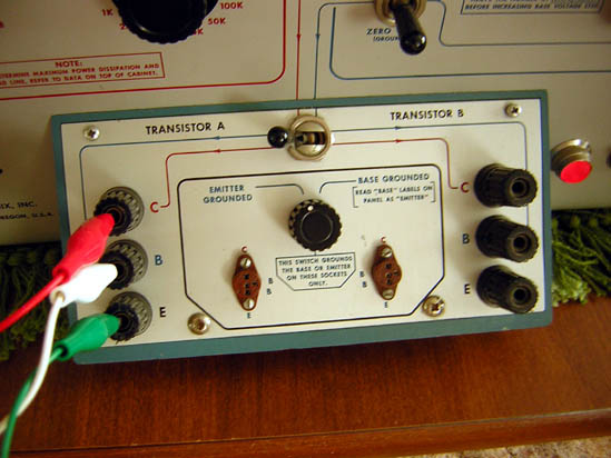

I've been building some adapters for my 576 -- here's the TO-3 -- I use a Amphenol mini-banana plug for the collector connection which fits snugly into the Keystone socket and makes good contact with the DUT:
...and it's insulated too!
OK -- this one should do TO-3's, TO-247, TO-265 and TO-220:
