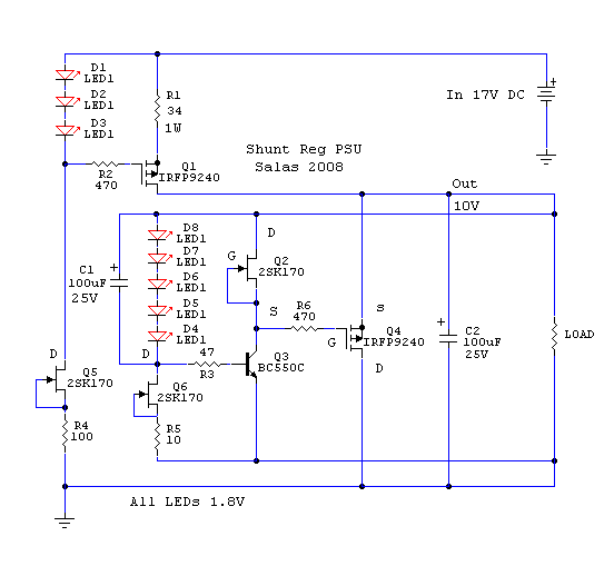

Per my numbers in my initial post, my Rset will need to be in the vicinity of 1.2ohm (2.2V/1.8A), and say, 10W, is that correct?
You said 850mA I think, then 2.7R 10W should do.
Got it, the CCS MOSFET will dissipate 6.63W, assuming 15V in...

Anyway - and this is for Salas - concerning calculations; I thought you said in your writeup that the CCS has to provide about twice the actual current draw of the load. Having planned to use (16) 1543 chips, my current draw (actual) would be around 800-850mA. Therefore the CCS should be able to provide (and adjusted to) 1.6-1.7Amps - is that correct?
This current then gets split between the load and the shunt MOSFET - right? - and for instance, in case the load gets detached, the shunt MOSFET, in case the regulator is powered at that time, has to be able to handle all of the CCS MOSFET heat load, as it handles the full CCS current, right?
This is the reason I will provide identical heatsinks to both MOSFETs.
Secondly, this is also the reason the CCS needs to be adjusted to provide, say, 1.8Amps - correct?

In small currents its good to double. As long as you will have 200 to 300mA spare on your shunt it will be in a very good point. Don't go doubling when in A territory. The heat creeps up hard. I was talking 2R7 when you will be running 8 chips for start. Plan for 1.2A when with 16 chips. The spare will be ample and the heat logical. I guess its better not to plan sinking for when running it with no load, increases you bulk and cost. Its cheaper to just turn it off.

Hello everybody,
After one exhausting day, here's my (first, admittedly rough around the edges) take on a single rail hypnotize with timer delay... Please comment away, don't hold back.
The rather baroque filtering scheme is due to some extensive listening sessions from Wheezer (hello there) on the DDDAC1543MKII that we intend to use this for. I can fairly easily adjust the filtering section per simpler approaches.
I am still not sure about the grounding scheme, I initially kept all higher current traces at 1.5mm width, including all ground, but then I enlarged all ground traces freely wherever I could do that easily.
Thank you for your input in advance.

Not a big fan of Nichicon - I have a homebrew ESR meter (@100kHz) that I went around my parts department once with, and decided the clear winners in the low-ESR category: third place - Elna Cearfine; second (on tie with first) Panasonic FM, and first: Black Gate N series... Nichicon didn't make it near the podium with any model, even KZs trailed the Pannies FM by a pretty good shot.
In any case, I favor the Pannies FM for an exceptional price/availability/performance ratio. But they are only available in lower values (for instance, in 25V flavor, they only go as high as 2700uF, and they are not ready to order from Digikey), so I decided to provide the possibility of putting more of them if deemed necessary.
I didn't get the chance to ask more questions about the timer delay, but I thought it's been provided in all of the finished/released PCBs, including hypnotize and mesmerize. Isn't it? Also, it's one strange timer delay, can you tell me more about its workings? I get the basics (the junction opening when cap charges to value etc.), but whassup with the other transistor used as diode, I guess, as only one junction is placed in circuit?
The chokes are intended to be the H's range and are likely/expected heavy (don't necessarily want three, though...). They're intended to suppress ripple towards the hundreds of uV range. Right now I get ripple (with a Sjostrom/Jung regulator and decent filtering) in the 11-13mV range. I want that towards 100uV or less. I assume the CCS has a high PSRR, so the chokes might be needed or not - will see.
The heatsinks are the best I could source from Aavid Thermalloy that can be of use to TO247 Ts, but they're around 2.7C/W... Hoipefully they'll do the trick.

Bipolars are better, and can come from any brand you favorite. For best cap distortion that is, use NP caps across the Vref and output.
The delay is for the audio part's output, not for the rail, because its a DC coupled circuit that bumps a bit during switch off mainly. Skip it. The Hypno as a reg only does not utilize it either.
Large chokes in the H territory are going to have enough capacitance across turns so to render their very high frequency capabilities only theoretical, plus hundreds Ohm. Mini chokes can filter where the CCS stops still, they are elegant, cheap and will not add much resistance to slow down your low ESR caps. Else, low ESR goes off the window.
Remote sensing I highly recommend since you make your own board. Arrange and wire as in the example I posted for you. 4 wires meet at the load. If not closed at their ends together, reg will not work.
It's used in reverse mode.it's one strange timer delay, can you tell me more about its workings? I get the basics (the junction opening when cap charges to value etc.), but whassup with the other transistor used as diode, I guess, as only one junction is placed in circuit?
Veb0 is specified as 5V max. This tells us the diode will hold 5V and not go into avalanche mode.
It does not tell us when it will go into avalanche mode. It's effectively a Zener Diode of unspecified value other than we are told it's >5V.
A properly specified Zener would be better.
I used a bc550b in conventional transistor mode to effectively create a darlington with the second bc550b. It needs an extra resistor to feed the collector. Rather than use an integrated Darlington.
I also run 15V reg through 2K to feed the 1k 12V relay. And it switches without fail. Yes, the 12V relay has only 5V on it.
