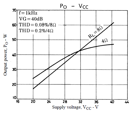

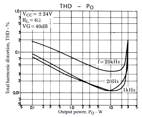

Let's take a little more in-depth look at what this chip amp can do by looking at a couple of plots from the datasheet:
The first attachment shows a plot of the output power versus rail voltage. The second and third attachments show the THD for 8 ohm and 4 ohm loads for 20Hz, 1kHz, and 20k Hz.
So, what do these tell us?
With rail voltages around +/- 28V (8 ohm loads) and 24V (4 ohm loads) you can get the claimed 25W/ch and THD specified. Note that the THD spec is tied to the 20k Hz distortion level and there is less distortion at 1k Hz and below. This means that a bridged HTA-2000 operating into 8 ohms and restricted to low frequency (below 1k Hz) will provide good performance.
Looking at the Po vs Vcc plot shows that the 4141v IC can deliver quite a bit more output if the rail voltages are increased - over 50W into 8 ohms and to about 45W into 4 ohms. The limit for rail voltages for the 4141v is about +/- 40V and power dissipation increases as rail voltage increases. Although the area available for heat transfer is probably about 3-4 times as large as the Megawatt packaging of other chip amps, you will probably want to use a larger heat sink if you increase the rail voltages much above the amp's 24V/28V rails - at that rail voltage the small heatsink gets moderately warm.
So, given that you can separately supply the chip amp with AC to its power supply, you could squeeze a lot of performance out of this amplifier for little cost, provided you can find the appropriate transformer. A 25-0-25V should give you rail voltages around +/-35V, and about 50W into 8 ohms. This is similar to the LM3886, but with a bit higher distortion. A 42VCT transformer will give you the 25W/ch spec'd in the datasheet. Both of these are available out there for relatively low cost.
This is not cutting edge low distortion stuff, but it's great for cheap and fun DIY audio projects! Remember, this is a pretty quiet amp (low noise) and would be perfect for a pair of computer speakers or even a larger pair for a small room where huge wattage is not required.
