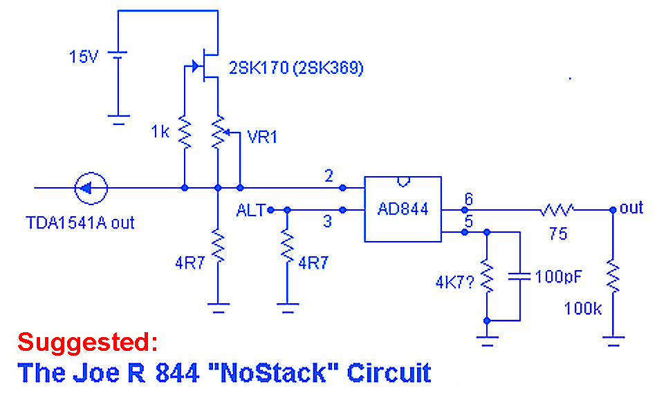

Here is an alternative to stacking, in fact it may well be equal to stacking up to ten 844s.
George can still take the output from Tz Pin 5.
You also have the option of adding DC nulling as per datasheet. Note you can null both Tz and final output, but there will be some mV difference, so choose one or the other. Also, the 2SK170 current source also affects the DC point.
It can also be used with OPA-660 and OPA-860 - note then the rails need to be +/- 5V.
While the above is a suggested schematic, I have used variations of this in the past.
Cheers, Joe
PS: If anybody builds this and makes necessary adjustment, I can amend this schematic as it loads of my website - I can can update / delete / etc at any time.

JOE R 844 No stack circuit
I refer to the schematic posted by Joe.
I intended for use with TDA 1541.
I have 4 questions :
What is the value of VR1?
This is to null the open dc ?
ALT stands for what?
The neg power input for the Ad 844 will be ground?
thanks
thanks
kp93300

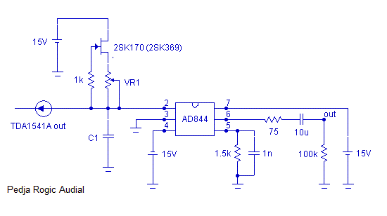

kp93300. This is the way Pedja Rodic of Audial designed and used this circuit successfully for the TDA1541 (attached).
However stacking 4 x them for the TDA1541 reduces the input impedance of the AD844 stack closer to the ideal 0ohms, which current output dacs love to see, which reduces the distortion figures even more from them. As Mick Meloney of Supratek discovered. And you can direct couple them if stacked, which in my opinion is a further bonus, as the best coupling cap is "no cap", I hate caps in the signal path, doesn't matter which one you use they all have their own sound, none are as transparent as "no cap."
Cheers George

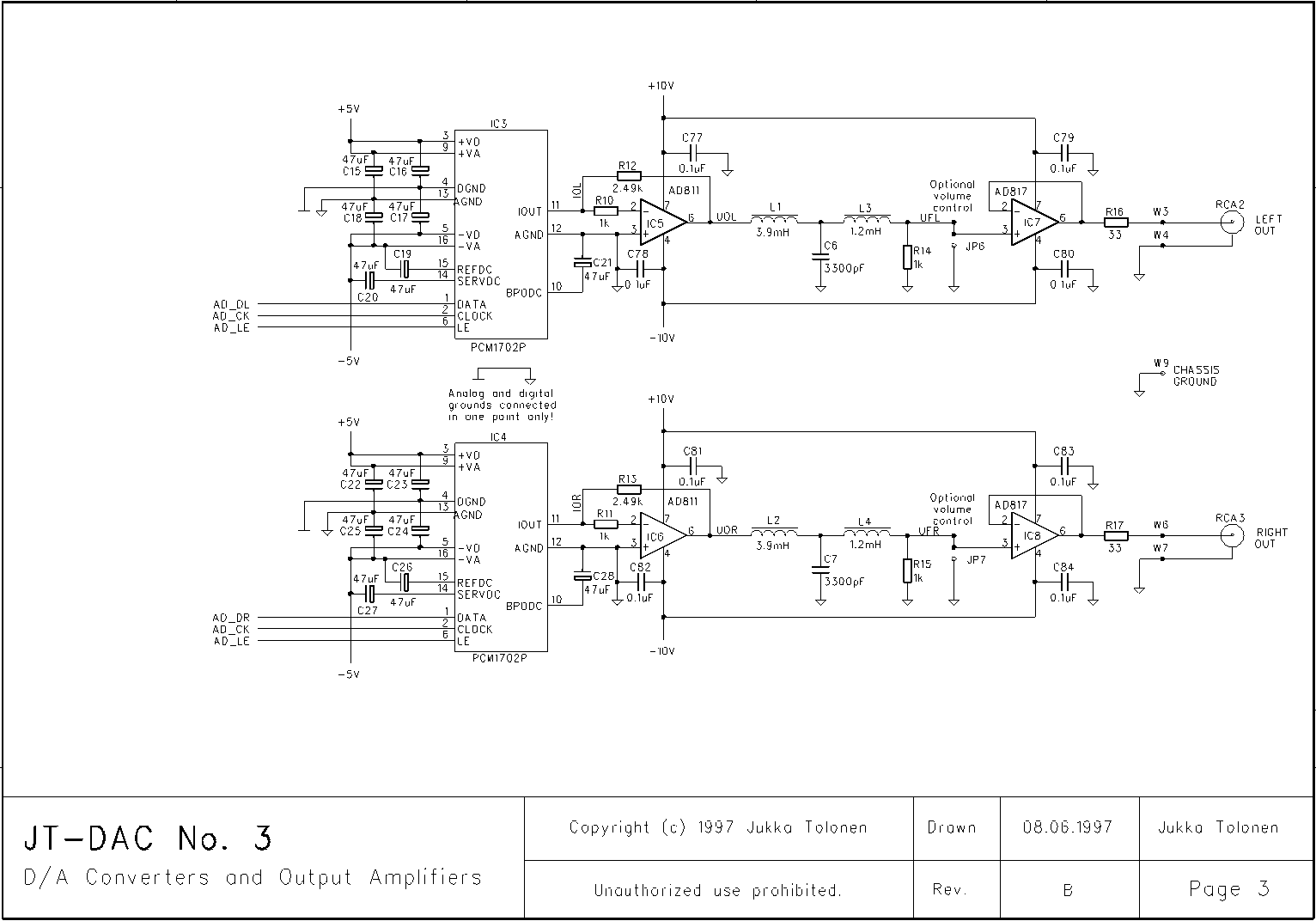

..... seeing your using the TDA1541A which has 3 to 4 times the output current (4.6mA) of my PCM1704k (1.2mA) I'm not surprised you prefer 3 stack 844 I/V, in fact I think it could need 4 stack, as Mick Meloney of Supratek found out with his TDA1541 setup!
Cheers George
Hi George,
Give AD811 a go. It will provide dynamic impedance of less than 1 ohm to vulnerable 1704 output of a milliamp (on a good day). It is an outstanding DAC, but it really requires close to zero impedance to work properly. Attached pdf's / jpg will be more than enough to give you some idea on what to pay attention to when using 811.
Nick
