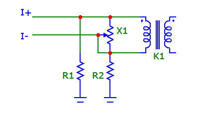

AD1862 and AD1865, two very interesting dacs to work with. I have my next iteration with the '65 planned, it will be a differential dac, one chip per channel. This way I should get a nearly constant current draw on the analog supply pins (except for small imbalances perhaps?).
How about this idea guys, for the AD1865 differential dac? Passive I/V with low value resistors. A nice low value pot as a shunt volume control. Step up trafo and buffers afterwards.

Trouble with passive low value resistors is that you end up with no level, and you then have to boost the daylights out of the gain, and in turn the noise level comes up with it along for the gain ride, to get anything useful (>2v). You end up with much noise, and if you filter it out, you really start chopping into the audio signal.
I have yet to hear this passive resistor way give you a black silent background. Without a heap of filtering.

Well, I listen mostly to studio recorded music and would really like to try that sort of passive old-school circuitry in a dac. The sort of circuits that were used in good vintage gear. I think it could give a warm, vinyl-like character that will add to the enjoyment of music. I´m not too much into hi-res or precise soundstaging.
You just need to ensure your preamp's front-end has a low enough voltage noise. I've found AD605 when used differentially, and AD603 (single-ended) don't compromise the noise to any noticeable extent. In that noise in the recording always eclipses noise inherent in the DAC. This is for RBCD - if you want hires and 20bit noise floor then yes it becomes a more serious problem. Perhaps the solution for 20bits is going to consist of paralleled BF862s.....😎
