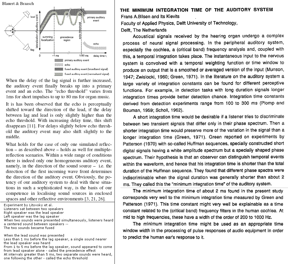

An interesting paper, but not very enlightening as regards loudspeakers. They are talking about signals, not transmission systems and the two things are quite different. The times that they quote are indeed "minimums" for detection, but only for the signal duration. One cannot derive from this data anything about the audibilty of a reflection, difraction or group delay, other than it has to be greater than 2 ms to have any effect at all. Such aberations are extremely common in audio and as such this paper doesn't really tell us much of interest.

http://www.icad.org/websiteV2.0/Conferences/ICAD2002/proceedings/71_Martens.pdf
If the subs are (only) placed at the rear they must be of good quality as rub and buzz localisation artefacts are easily heard segregated when originating from the outside of the mains including within cone of confusion where the limit for frontal phantom spread or image position/stage width ends.
Do you have a reference for you bottom post?
The Matens paper is quite interesting. I was not familiar with it. Thanks for posting it. I am not sure of his methods and how applicable his approach is in an actual situation.
