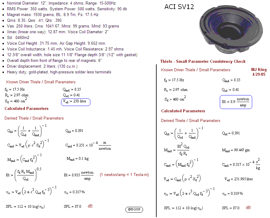

I have an old ACI sv12 sub. I understand i can buy another one from Meniscus Audio. Maybe two of these would really round out the already amazing sound i am getting from my stand alone BIBs. Might as well get the most performance i can while i am still alive and well! I want to treat myself really good since my operation. Do the subs have to be the same? Or can they be different. Say and 8 inch sub in a small box and a 12 inch sub in a big box. Or am i thinking about this too hard and being wasteful?
