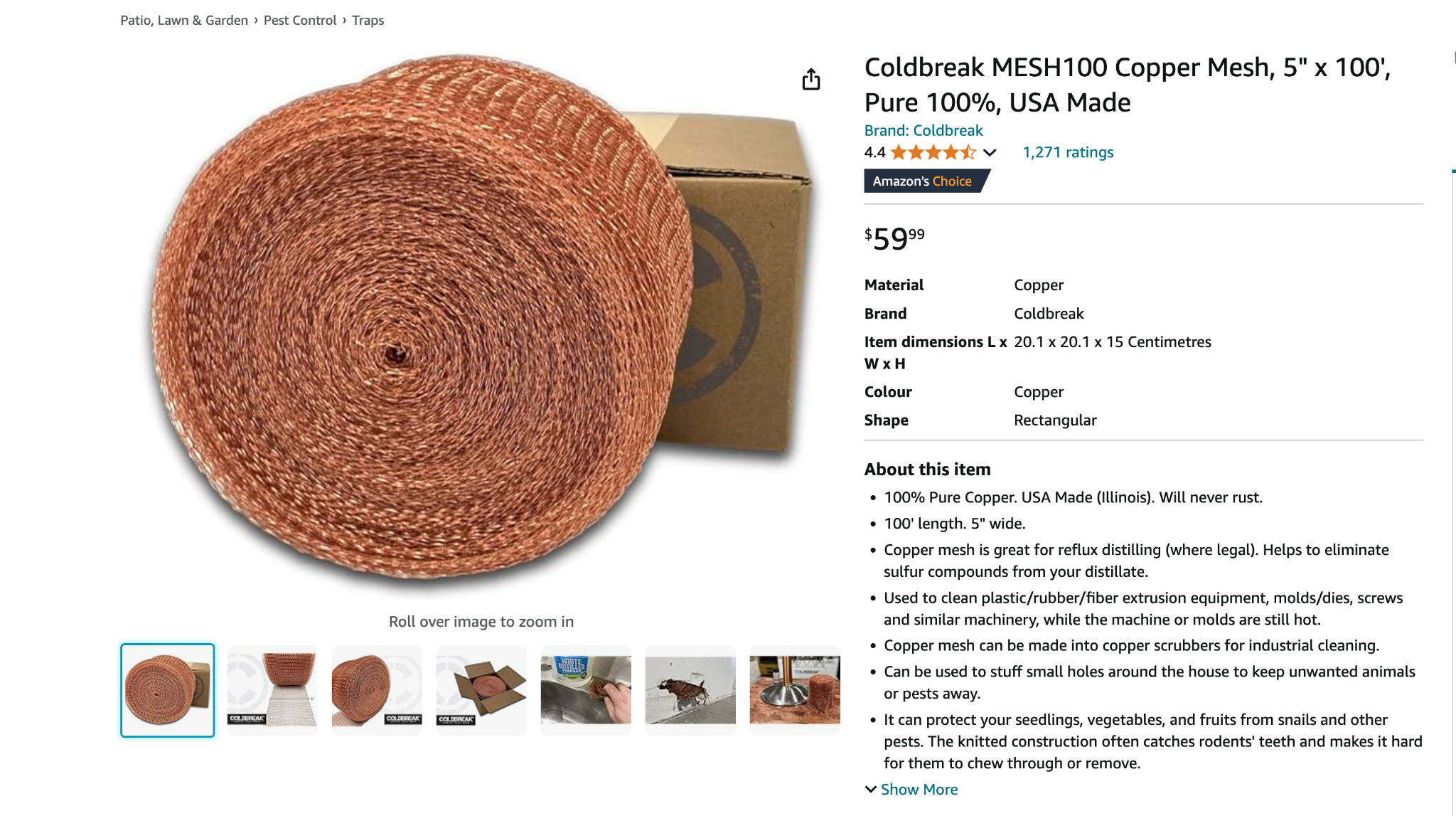

This is an interesting discussion,during Covid while I was designing and prototyping some small desktop full range boxes I had run out of polyfill and acoustmass and being the weekend could not place an order. So I was looking at some stuff in my attic and found some old klang & tong magazines where there was an article about making different constant layers damping, I decided to have some fun,I had lots of shredded denim,stainless steel mesh,copper mesh and silver mesh,from my wife’s yarn business where some yarns have these metals spun into the wool,yak merino etc to give them some metallic sheen which was the trend then,we have a few winding machines ( can’t do transformers unfortunately)
I put some of the mesh stuff in some old socks and stapled them into the boxes and they were actually damm good and each had their own unique effect,it’s very time consuming and all the materials come from 5 different vendors,I don’t know if and what effect they had on heat dispersion, I also did not measure the speakers as they would never get into any production.
we do have a few extra knitting machine and electric looms so I could make a few small patches with wool non magnetic stainless steel ,silk and other materials maybe 5 layers of 1/2 inch thick ,it will be expensive though and maybe will even measure it and see.

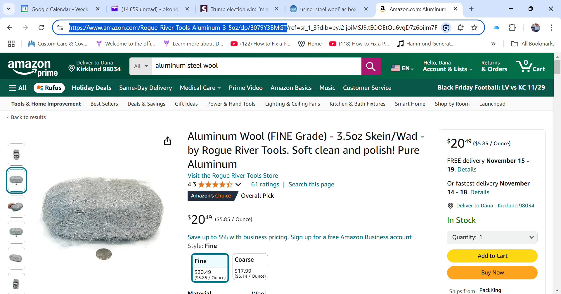

A quick search and it would appear that aluminum wool exists. Which leads to just one question. Will androids dream of aluminum sheep?
https://www.amazon.com/Rogue-River-Tools-Aluminum-3-5oz/dp/B079Y3BMGT
