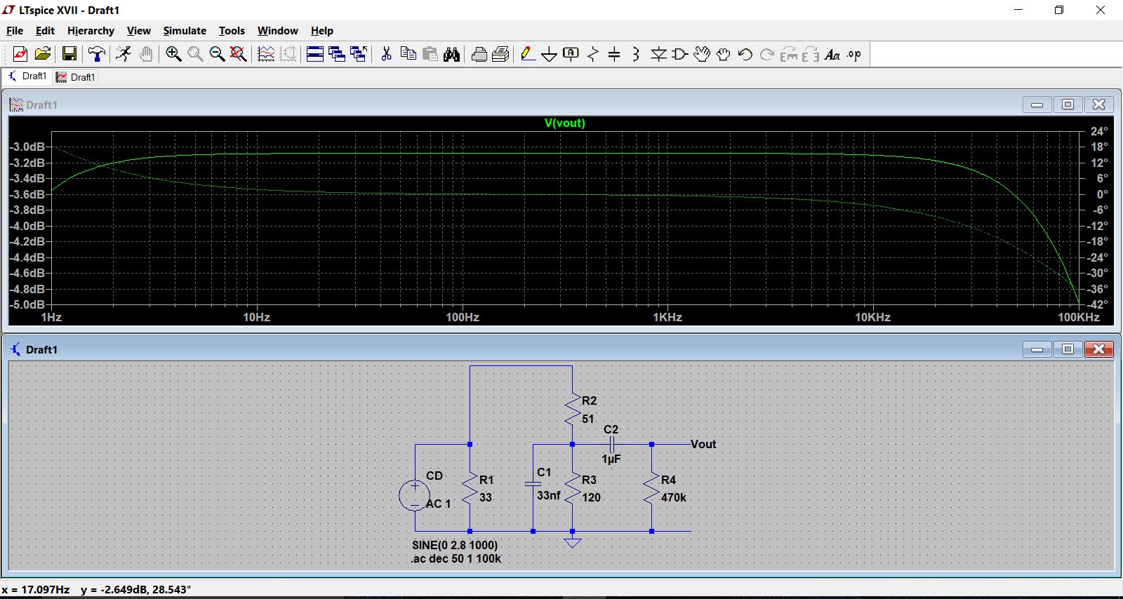

This top of the range Sony NW-ZX2 Walkman that sells for USD$1200 sounds fantastic. It plays DSD and other format music files and drives low impedance headphones. Can it be used as a digital source like a CD player? If I use a headphone 3.5mm to stereo RCA cable and connect it to my line level preamplifier (20k volume pot input followed by OPA627), will it work as a superior source?
Since the output of the Walkman is for headphone not for a preamp, will the relatively low output resistor at the NW-ZX2 be a problem driving the cable? Will a low volume output cause lower S/N ratio that degrades the sound? In a word, will the sound of the high-end Walkman being used as a digital source be better than using a computer laptop with a USB DAC of similar price?

From my reading of the Sony blurb, its using a 'digital amp' to drive the headphone output. Which means it'll potentially sound quite dire used as a source to a preamp. Reason being 'digital amp's put out lots of switching noise - you'll want a fairly steep passive filter between the player and the opamp in order to get best dynamics.
That makes sense. Thanks.

Try something like this which will filter HF noise, block DC offset and still give a low driving impedance. It also loads the digital output stage with something respectable.
That is exactly what I need. I will try it!
