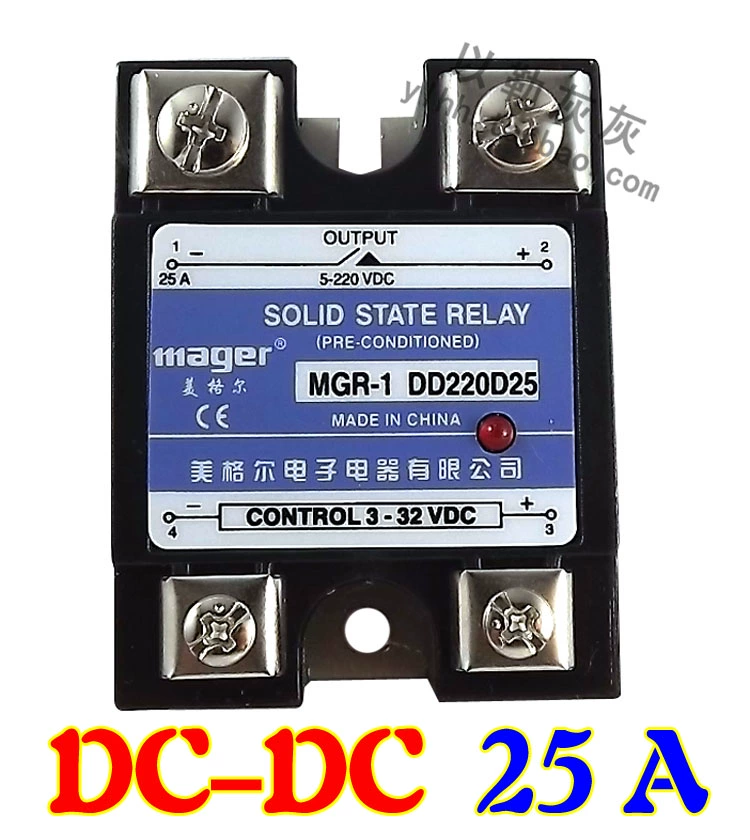

I'm considering using solid state DC relays to implement a "fast turn off" of the rails from a linear power supply feeding an amplifier. The idea is that I want to immediately kill the rails to the amp and then let the PS caps slowly drain over 30 sec or so through a bleed resistor.

I can think of at least one application where this would be of benefit: the PS for a TDA7293 based chip amp. For the 7293 if the negative rail is accidentally disconnected (fuse blows etc) but the positive rail remains active the IC will explode. The scheme shown below from the 2010 thread would make for a simple mutual shutdown circuit, and the branch feeding the inputs (labeled 1-2-3-4) to the SSRs could also be relay controlled so that you could remotely shut off the PS rails on command.
Any drawbacks for using SSRs in this application? Will the leakage current of the SSR be a problem? I am considering some cheap SSRs from China that are available through Ebay at about $10-$15 each, rated 60Vdc and 40A.

Bear in mind, you can make your own SS relay fairly easily from a pair of MOSFETs. There are no 'contact' issues to worry about.
There are lots of options, some of them have some good headroom on current handling: Digikey has the IRFSL4115PBF devices that are rated to 195A at 150V for $3.85ea if you buy 10 of them.
But I can buy one of these that should do all of that:
$5-$10 depending on how many I buy and where I buy them...

I just searched for DC solid state relay on eBay. There are dozens of them out there at low prices. It does look more compelling than building one yourself, but I'm nervous about using something with no pedigree in a protection circuit. I also read somewhere else that these low cost SS relays are very slow - although the specifications published by the sellers looks just fine.
Remember the adage - if it looks too good to be true....
At these prices it's probably best just to buy a couple and try them out - not much to lose !
