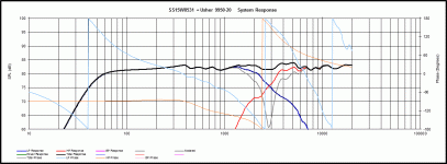

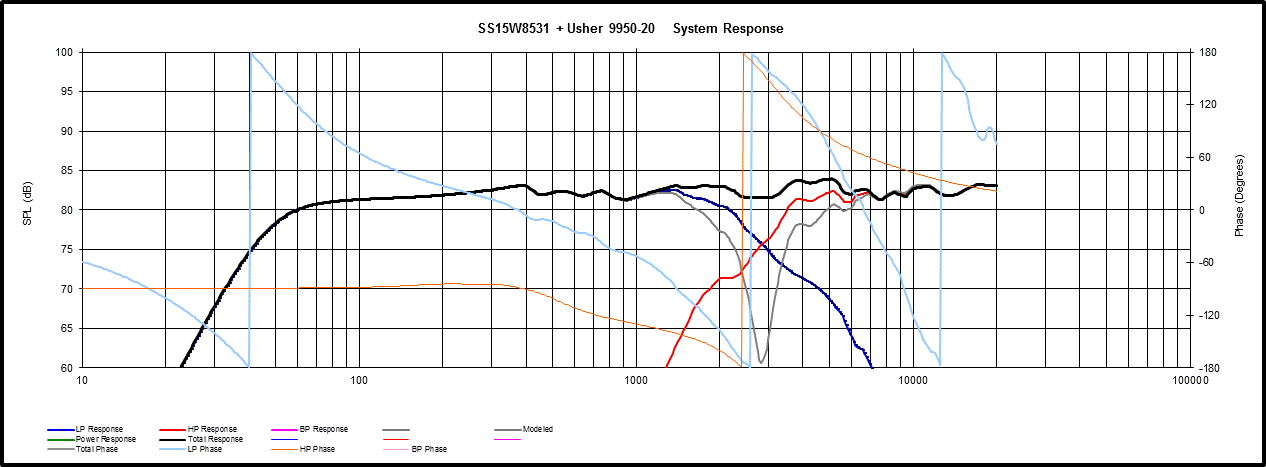

Hi Jack,
I suggest you do 1,5" by 6". F3=45; F6=38 and F10=33 Hz according
to sim in a 0,35 cu ft box. F6 and F10 are important for better bass
and these are 10 Hz lower than with 2" by 6". You will do fine.
Thanks.
I continued on with a PCD simulation using an 0.38 cu ft PartExpress box, baffle 8 inches x 14 inches. Woofer center 6 inches from the bottom, woofer center to tweeter center Y axis 5.5 inches, port 2 inches x 6 inches. Woofer to tweeter Z axis offset -0.5 inch.
Looks reasonable? I try to aim for a flat response to begin with, if I am using the software correctly.
