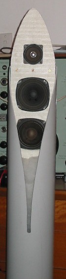

K slot pipe,
L = 1.2 M for 40Hz
(Its like a folded transmission line with an 'abnormal' termination 🙂
