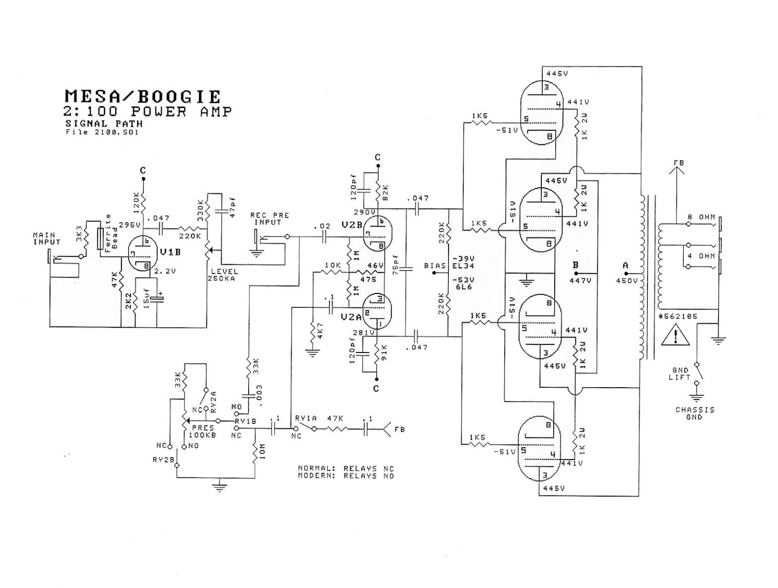

I have a stereo push-pull power amp but I only want to use one side, and it is not a dual-monoblock, ie I can't just power down half of it. Is it safe to just pull the tubes on one side without a load connected? Or should I disconnect the B+ from the output trans also?
The negative of the speaker terminals is grounded if that matters. Also I'd be pulling the PI for that side. The heaters are A/C powered so I expect they will still be within spec. I ran sims in Duncan's PSU designer and the only side-effect is half the ripple. 😀
Forgive me if I'm asking a dumb question, but I'd rather live to ask two stupid questions than die because I didn't ask one.
EDIT: The schem shows one of the two identical channels.

Use a shorting RCA plug at the I/P of the "slack" channel. Connect a resistor, instead of a speaker, to the "slack" channel's O/P. ALL tubes are left in place.
Operating voltages will be incorrect, if a channel is "disabled", by removing tubes.
Well Mesa themselves say you can remove a pair from each side to make it a 2x50w amp but that also would mean the tubes would be presented with exactly half of the originally intended load impedance, and that doesn't appeal to me. I don't really need a stereo rig and 2x100w is WAY too much power for my needs, so really my goal here is to turn it into a single 100w amp, and not have four 6l6 and a 12ax7 just sitting there wasting electricity and creating heat while not being used.
