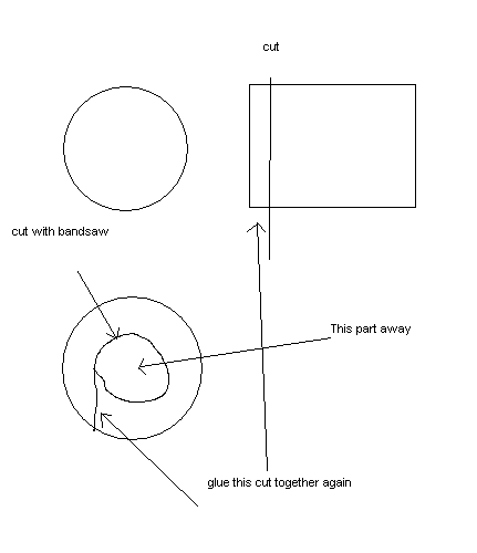

I was thining about using a maple log I have about 18" diameter and 24" long as a sub enclosure. Does anyone know of a way to get a hole about 15" deep and 13" diameter bored into this without buying expensive tools? So far my only idea is to use a drillbit many many times and a wood chisel to clean it up afterwards. A mostly round but irregular surface might be a good thing on the interior of the enclosure too, right? Will solid hardwood (maple I think) be rigid enough or should I go with a smaller driver and thicker walls? anyone have any links to other projects involving one solid piece of material for the enclosure?

With the bandsaw you need to cut throug material you have to glue after you finished.
You cut like this:

The easiest and safest way I can think of is to use an Arbortech blade on an angle grinder, they carve wood like nothing on earth and are much safer than a chainsaw.
However you may have problems over time with your log splitting as it dries out, espaecially if you make the walls too thin🙁
it will crack in case you use it not dry enough and put it in the house.
You need to use an piece thats allready dry (some years laying around at a dry place)

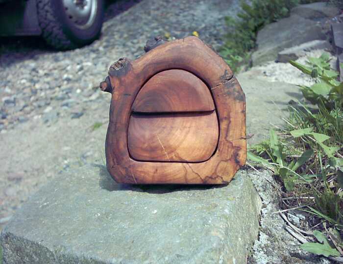

The easiest way for a big hole is to find a piece of a tree thats allready has a hole because of illness. If the wall is not to thick and dry slow enough the forces in the material are not so strong and it will have only small cracks.
