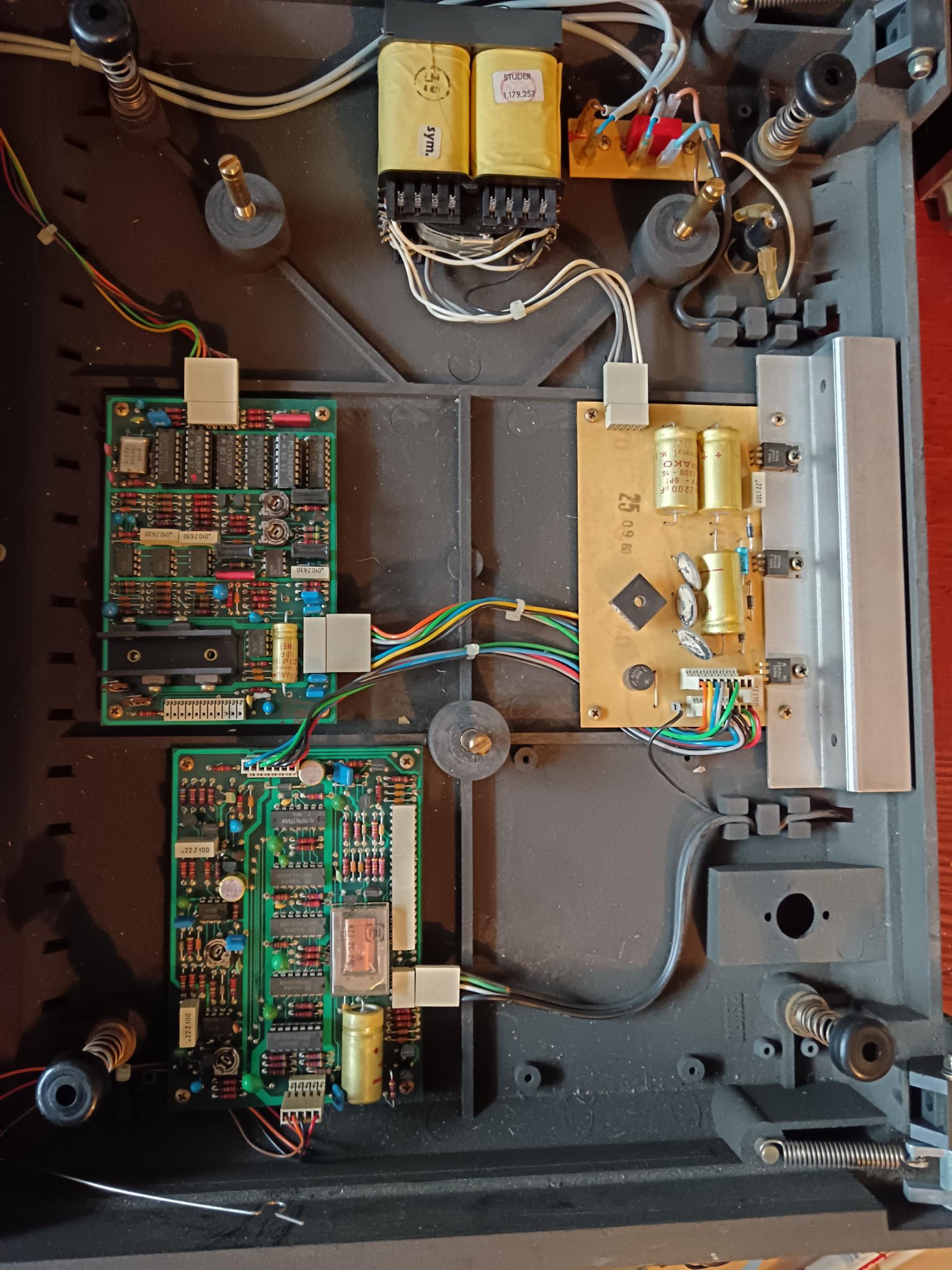

Yep, spent the pandemic going through everything, the 'chopper' chips go and the caps. Replaced quite a few SMPS with coil transformers , that is what the mains network is designed for and works best with.my small devices are all unreliable.
Difficult to better a potted toroid and a good hefty choke inductor.
